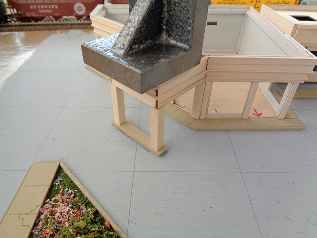

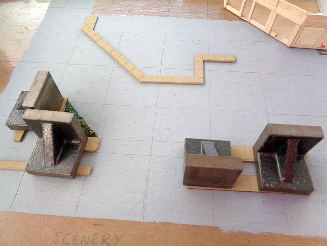

I glued down the sidewalks and used weights to hold them down until the glue dried. I also used the same thickness of strip wood so the weights were level and not sitting at an angle. I wanted the sidewalks flat while drying and didn't want to find them glued and not level.

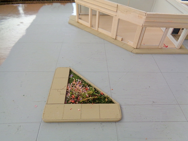

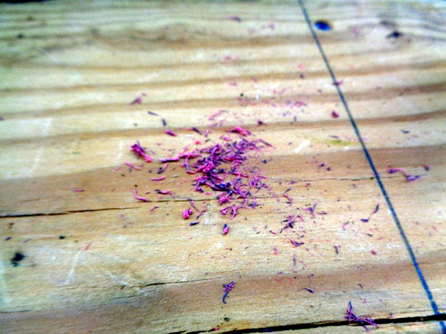

I wanted a few flowering plants in the triangle of the corner sidewalks.
I didn't have any pink or violet flowers. Here is what I did to make them.
I rubbed a #2 pencil eraser on the layout to get the pink. I used a magic marker to stain some of the pink eraser purple. This is the mix I glued in the flower triangle.

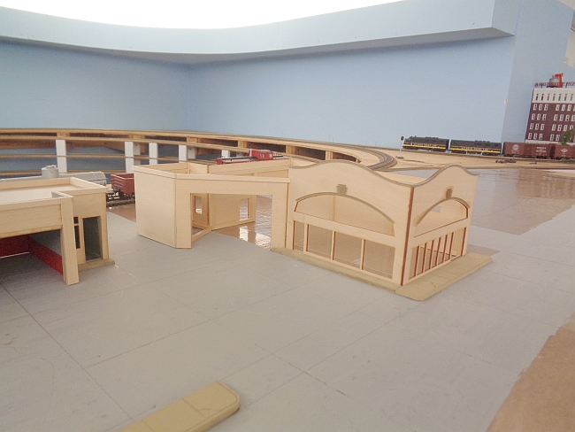

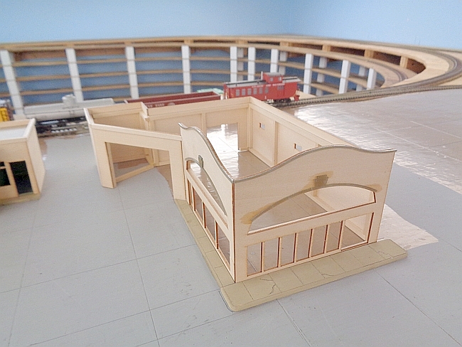

I positioned the showroom building where I wanted it and glued the sidewalks in place using the same method as the others.

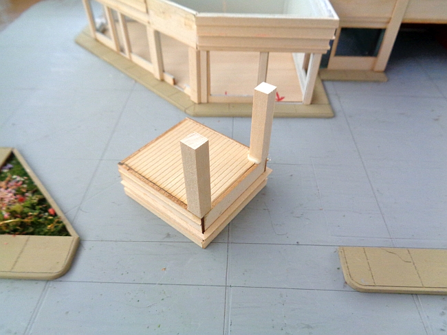

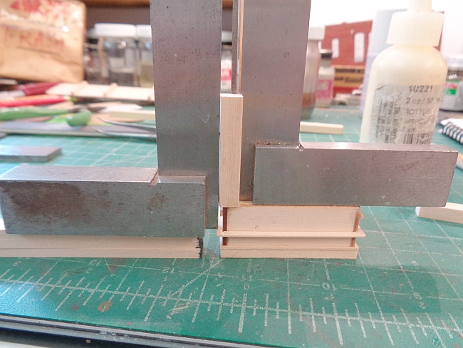

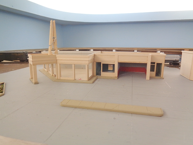

I glued the two pillars to the gas station canopy. I made sure they were both perpendicular.
I then glued the pillar base in place. The weight helps hold the base in place while the glue dries.
I'm almost ready to add the stucco to the buildings.
Excellent creativity on adding the colors to the flower bed.
That is one impressive looking building.
Michael Hohn
Very nice.  A remarkable model even at this stage of construction.
Mike
Tom love those flowers and the way you made them.
I didn't realize how big that building was.  Wonderful work and tutorial as usual.
Lookin' good so far, Tom!  Nice touch with the flowers.  I suspect it'll be awkward trying to stucco and paint the structures in place or are they just set on the diorama?
