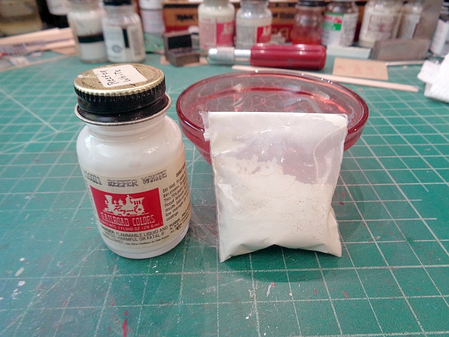

Dario suggests using a lacquer/solvent based paint when applying the stucco. I used Floquil Reefer White which is also his recommendation. I followed his suggestion in how to apply the stucco. I have mixed feeling on how it turned out.
The process he suggested is to take a soft 1/4" brush, paint some of the white on the wall and then dip the brush in the Durham's water putty and dab this on the wet paint on the wall.

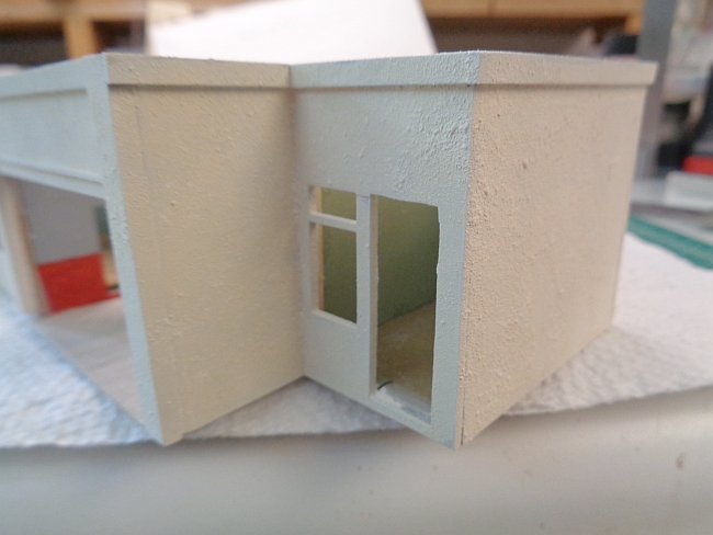

I started on the rear wall of the service bay and then to the rest of the building.
I want to mention here that areas on the walls signs will be applied. The signs in the kit are paper and flat.

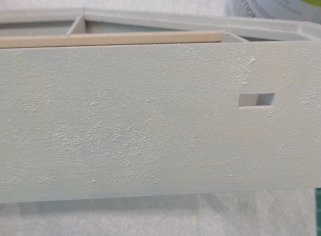

Thinking ahead to adding the signs, I wanted to be very careful in adding thick or heavy stucco to those areas.
I was perhaps to careful in adding the stucco as it is very subtle when looking at the walls.
I hope you can see the stucco application. When I lighten the photo, the stucco disappears.
One thing to consider is the fact the Durham's water putty has a yellowish or tan color. Horwood Brothers is supposed to be white. I'll end up painting it when all is done.
For now, I'll add stucco to the large show room building. I'll let the structures sit a few days and then I'll made the decision to leave them as is or add another very light coat of stucco.
