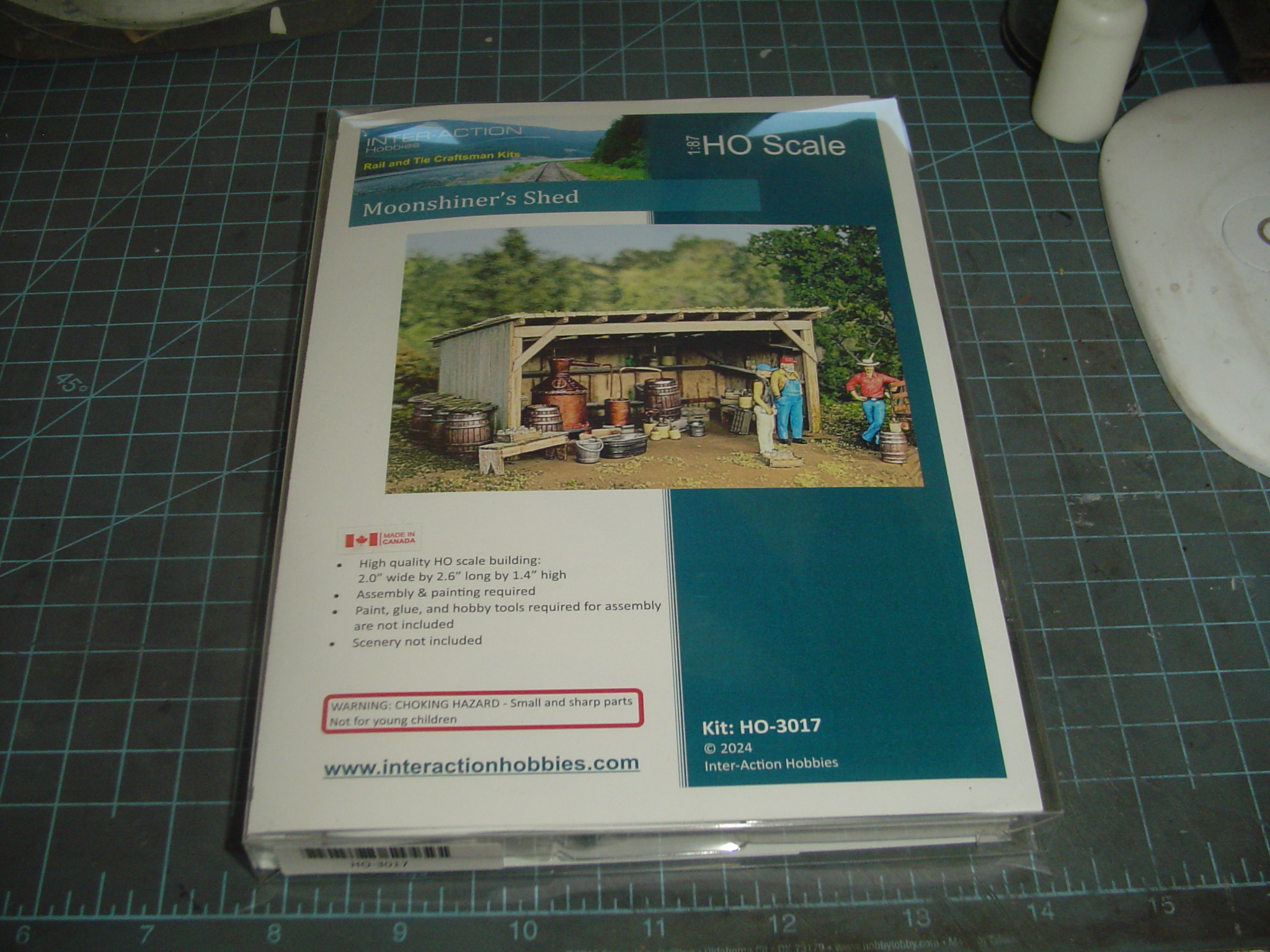

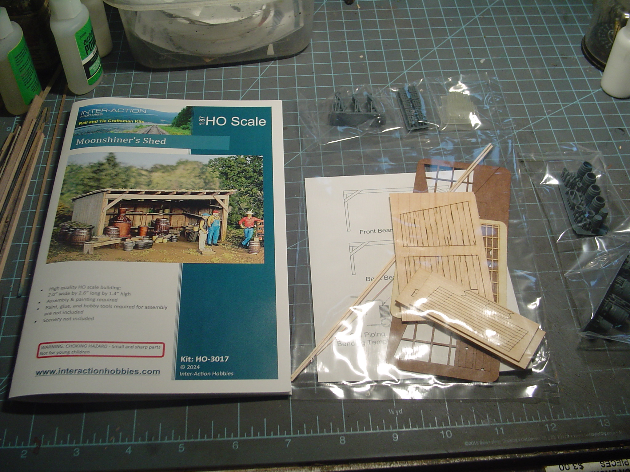

This was an X-Mas present from my better half. It's the Interaction Hobbies Moonshiner's Shed in HO Scale. It's also available in O Scale.
Let's start with the standard picture of the unopened kit.

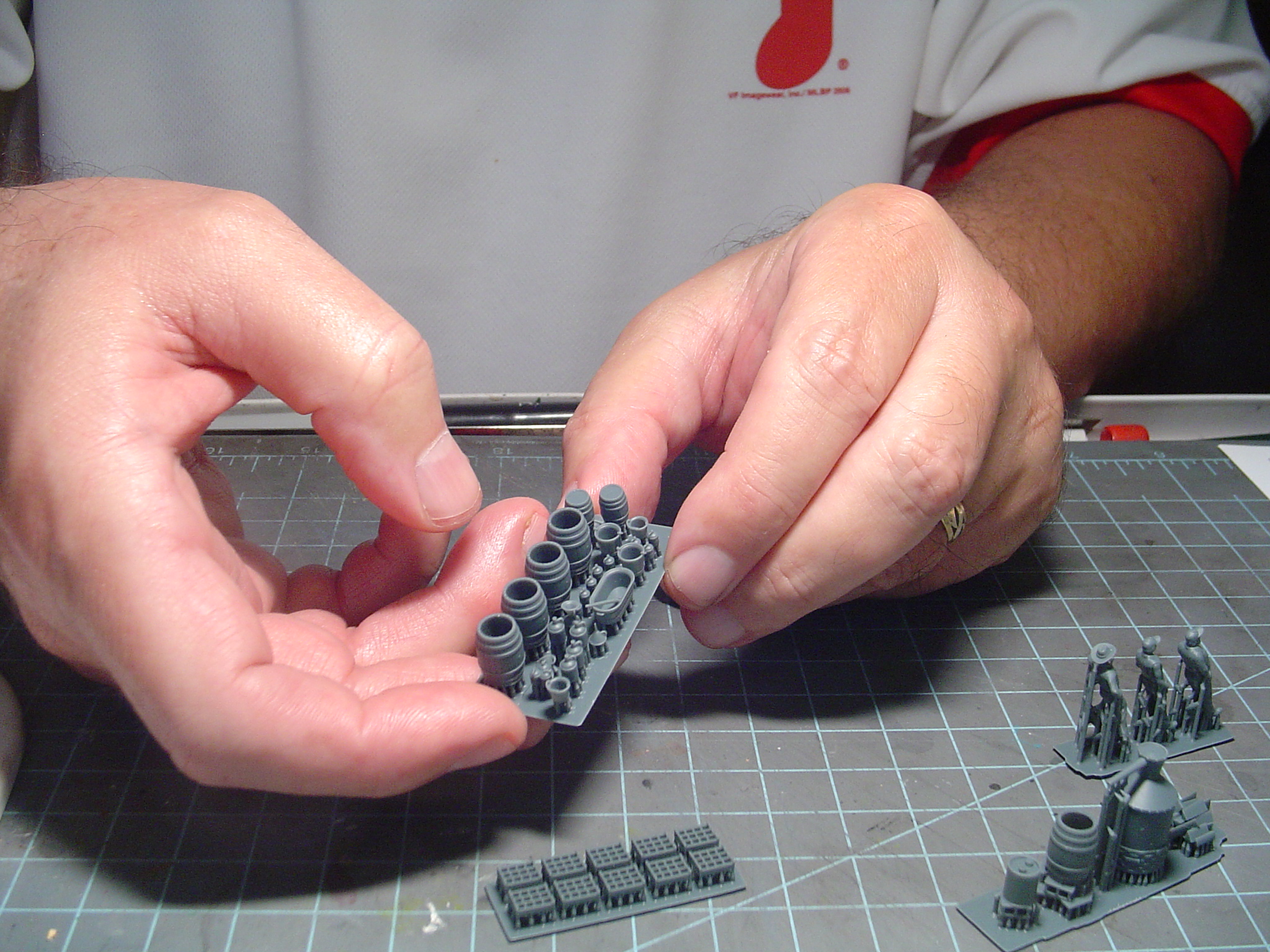

And here are the contents of the package. Lots of 3D printed stuff in this one.
The instructions recommend painting the 3D printed details while they're still attached to the base they're printed on. Maybe that would work for the O Scale version of the kit but, as you can see here, it would be difficult to paint these things in the HO Scale version given how close they are to one another.

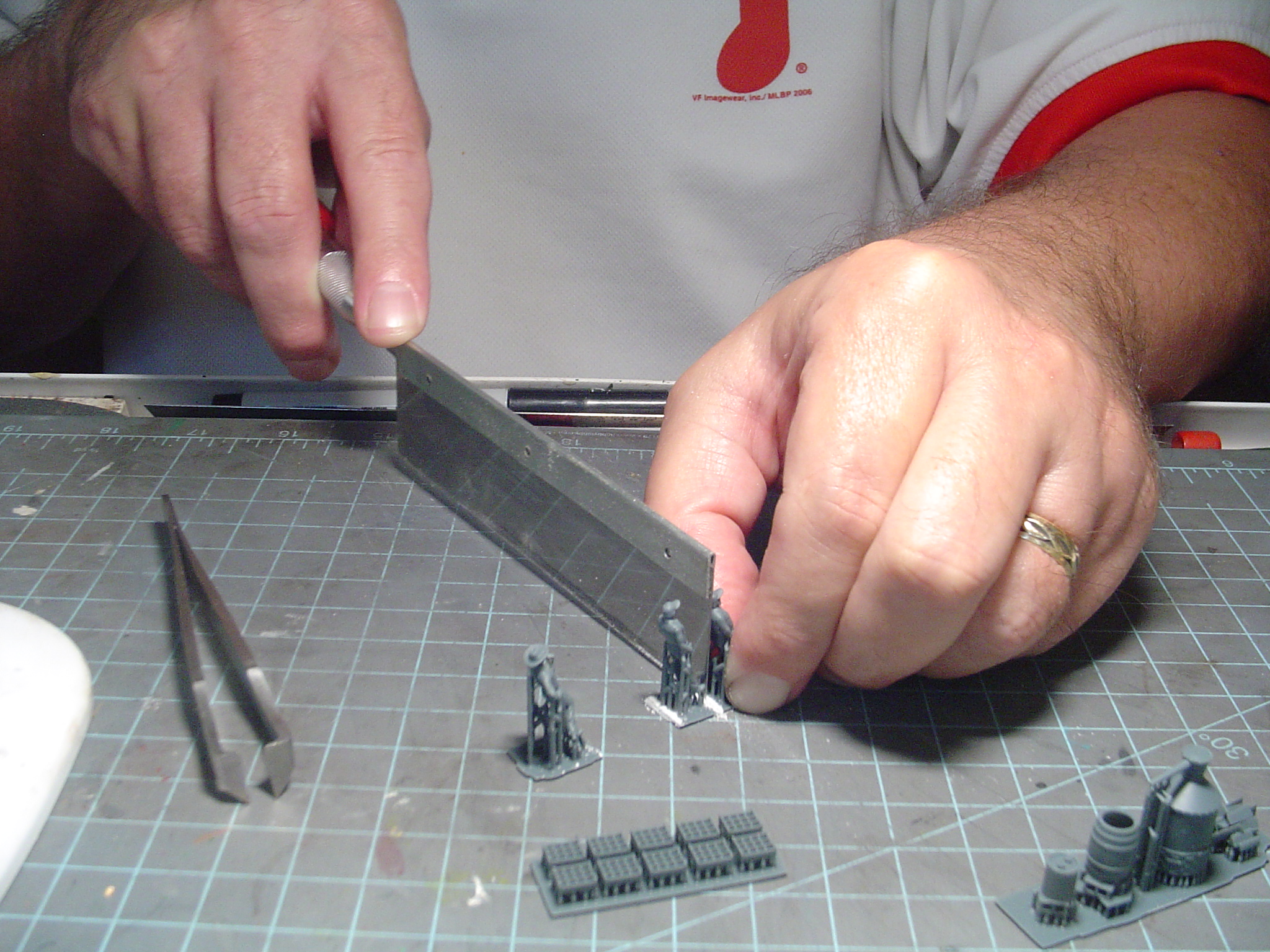

I started by separating the figures from one another using a razor saw. I planned on keeping this on their base while painting them and only removing those sprues (or whatever they're called) that rise up assist with the printing process. However, when I started trimming those off the ones beneath the shoes ended up giving way, so I ended up removing everything and cleaning them up in preparation for painting.

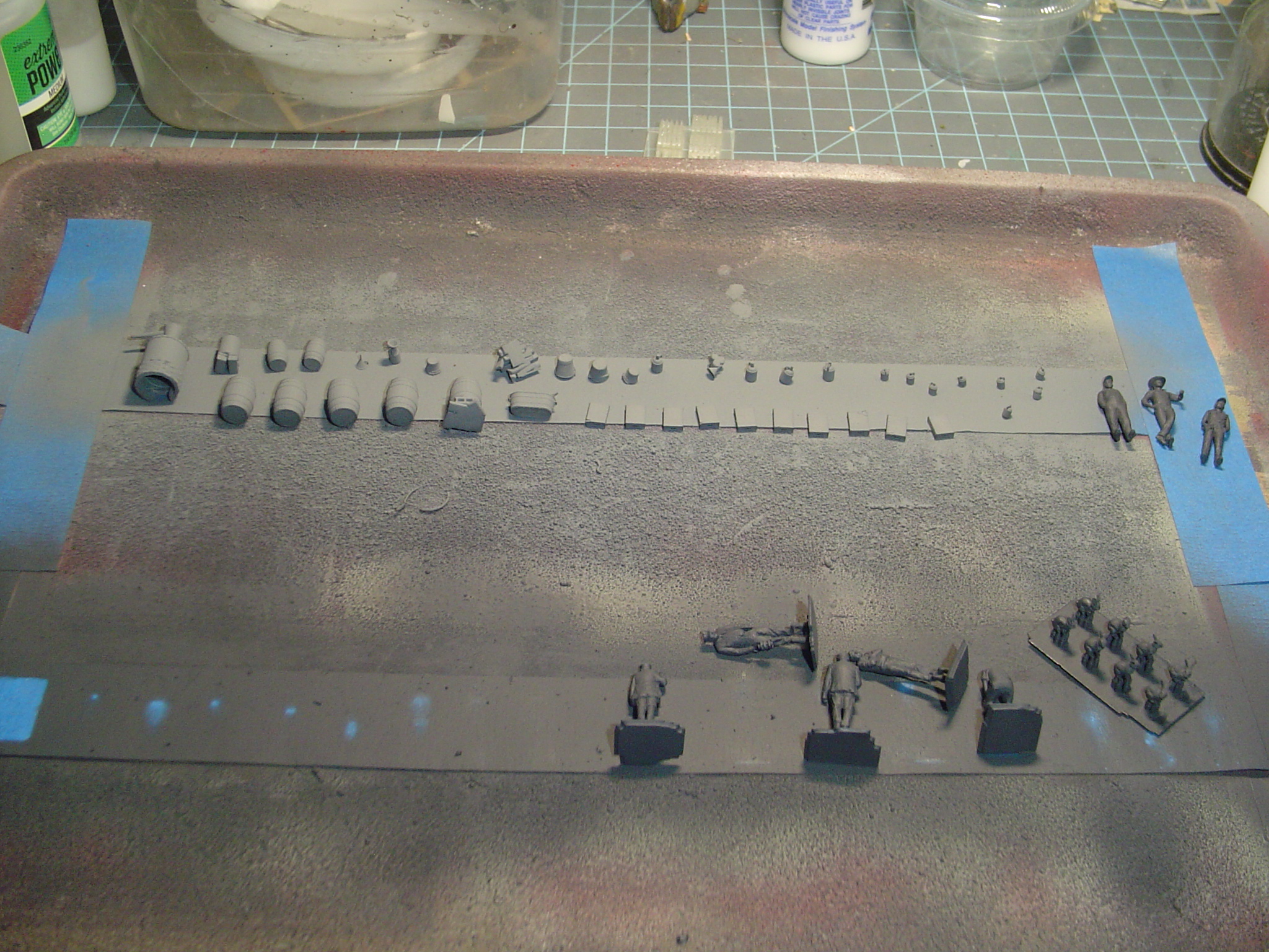

I primed everything, except the figures and glass bottles, with Floquil Foundation using an airbrush. The figures I primed using Floquil Weathered Black (I think it was Dave Emery who recommended using black as a starting point for figures, so I figured (pun intended ;D ) I'd give that a try. The glass bottles are clear so they didn't get primed.
The top row in this picture is all the stuff from this kit. The bottom row are some Mini-print figures I had sitting on the workbench waiting to be painted and aren't related to the kit.

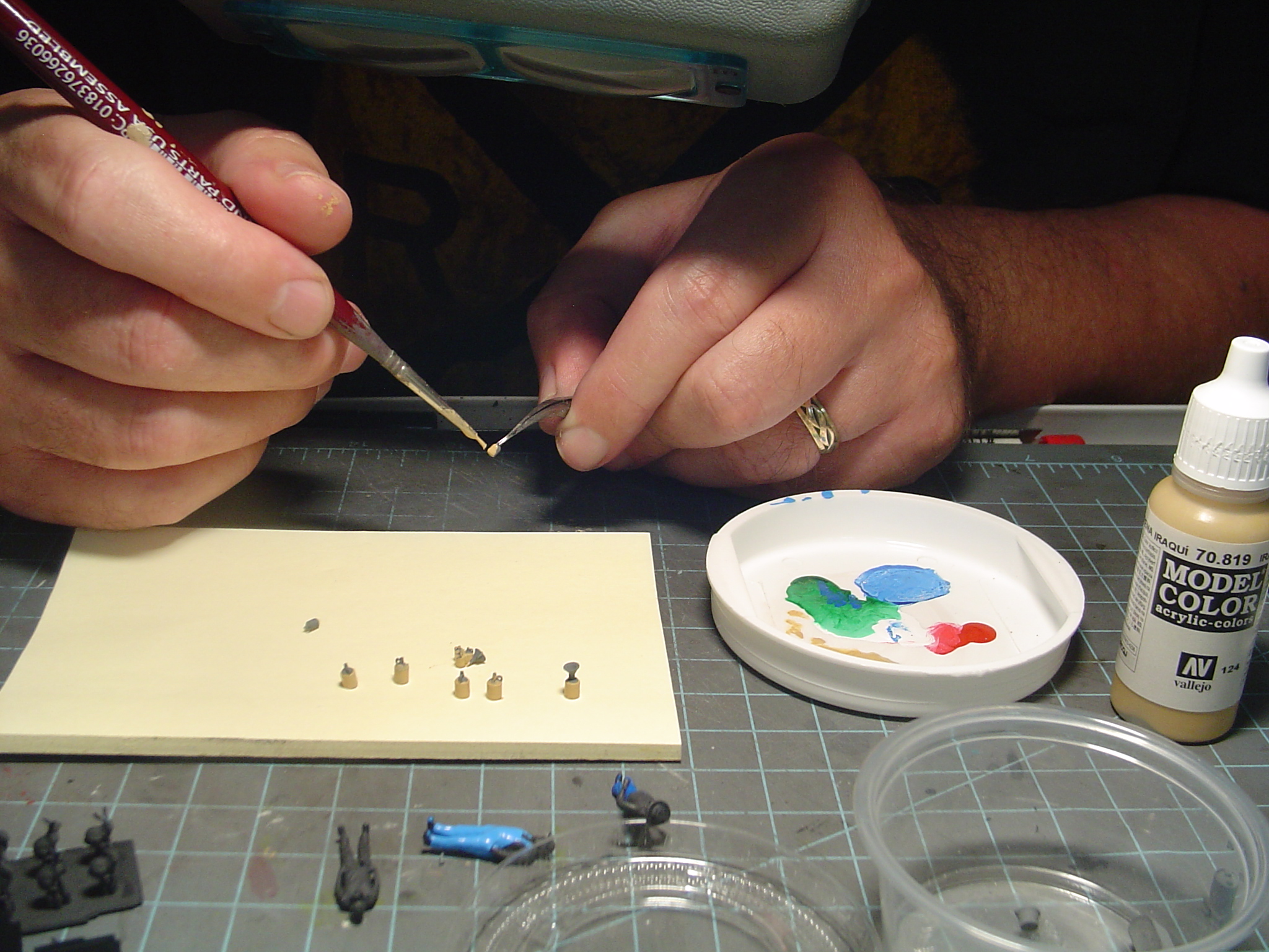

Painting moonshine jugs in a two tone paint scheme turned out to be not as bad as I had feared. For the bottom I used Vallejo Iraqi Sand and for the top I used PollyScale Roof Brown. A 10X Optivisor is a must for most of the painting.

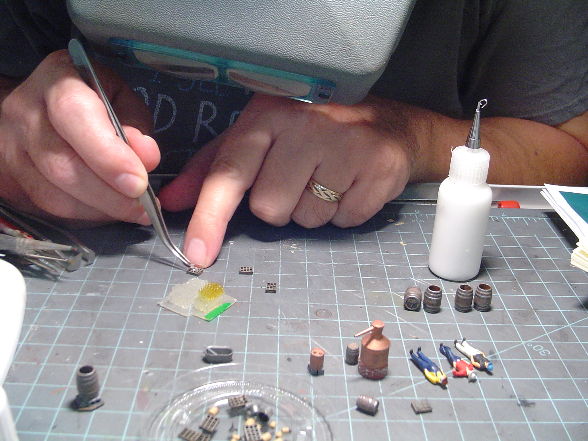

Okay, I ran into a bit of frustration with the glass bottles. First, there are some cases that hold the bottles. Getting them into the cases was a touchy process. By the way, there are 93 bottles included. I lost a few when slipped out of the tweezers as I tried to insert them in the cases.
A second issue is that they're printed so close to one another that some are actually stuck together, side by side. When I nipped one off the carrier sheet its attached mate broke in half. But there are plenty of bottles to make up for those I lost or broke. I painted some with a transparent yellow paint just so they wouldn't all be clear (though it would hurt if they were).

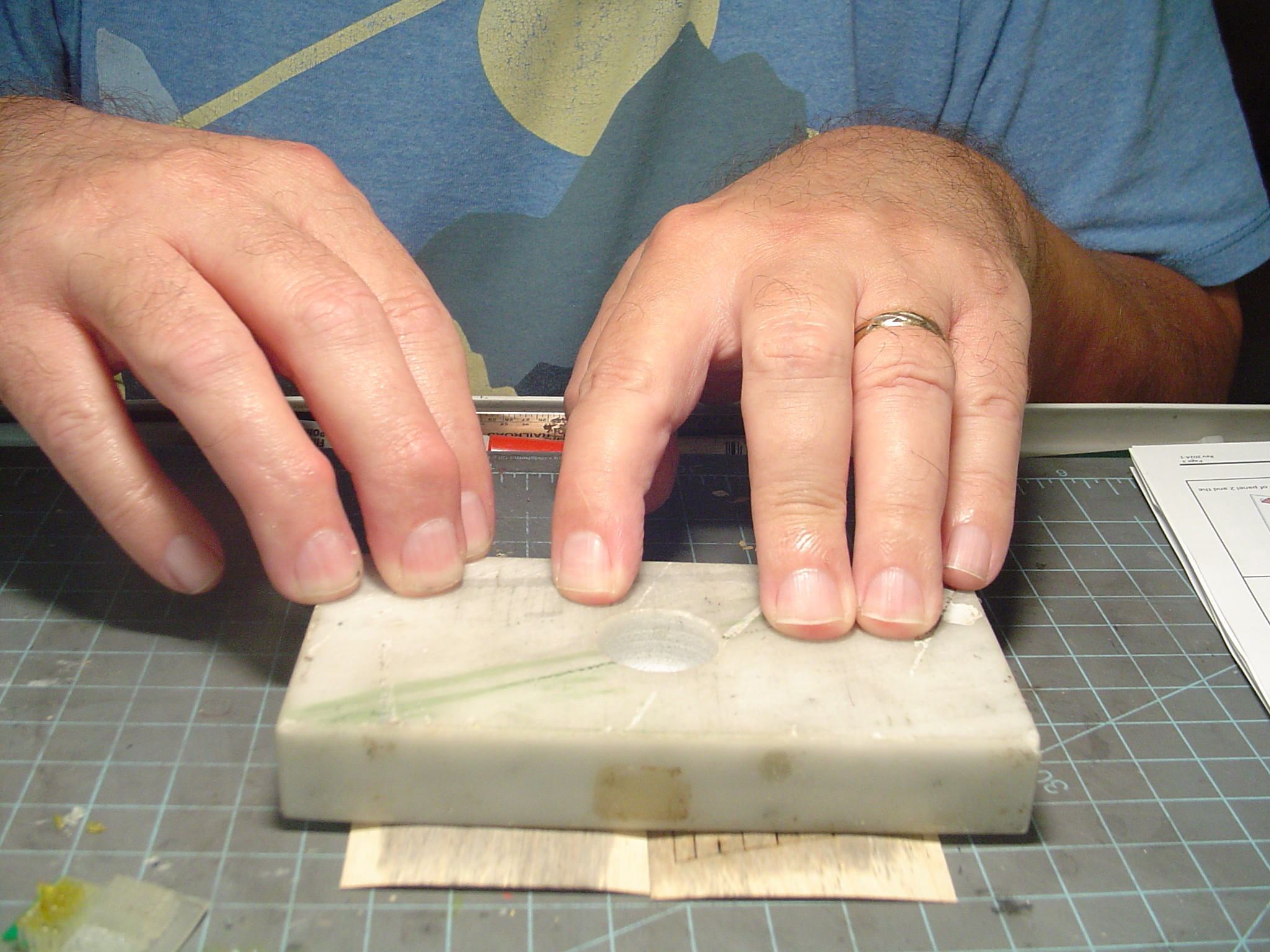

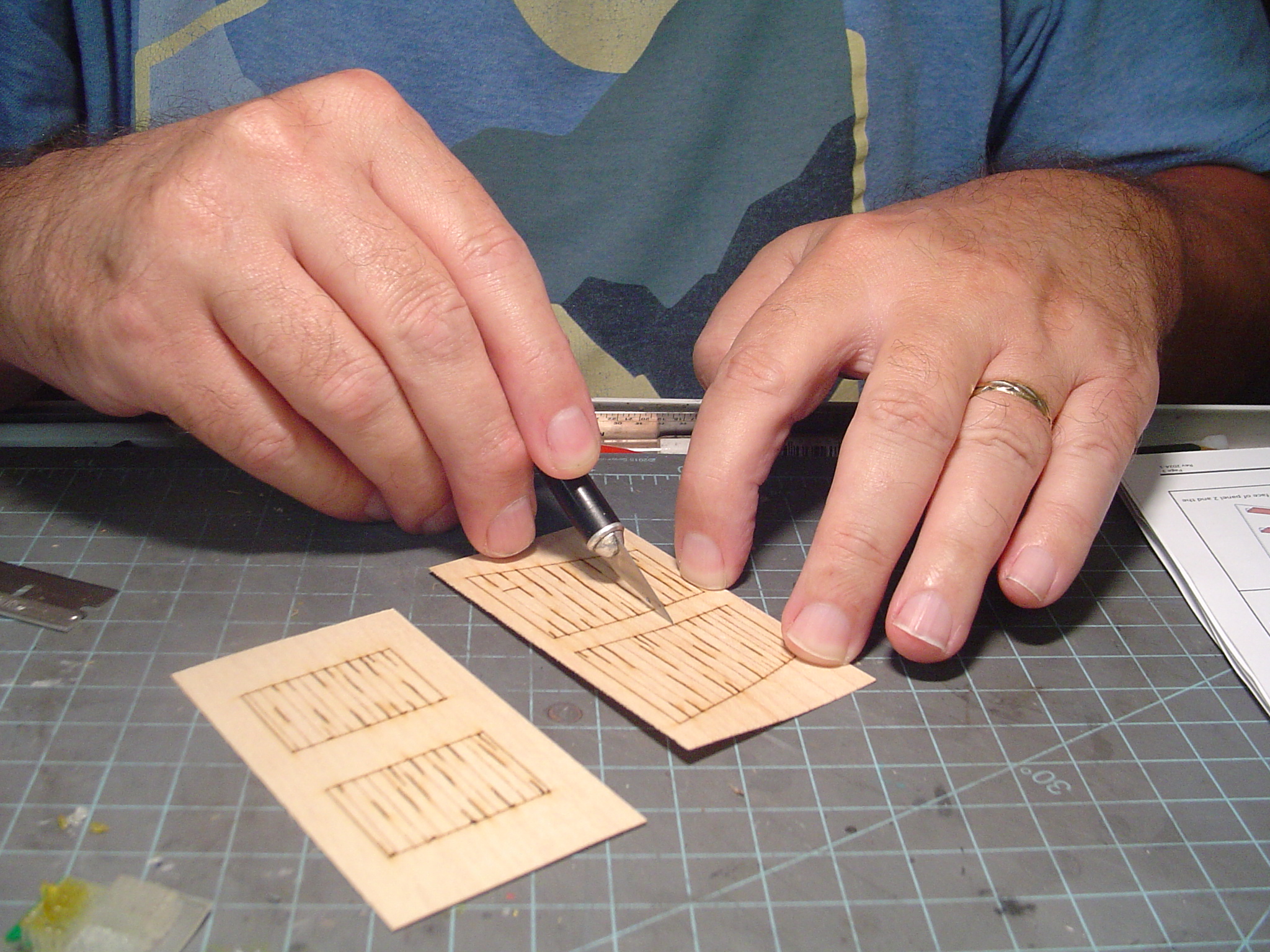

Finally, after weeks of painting the details I'm ready for something different. The walls of the shed need to be roughed up a bit. I scratched some grain in the walls using an X-Acto knife.

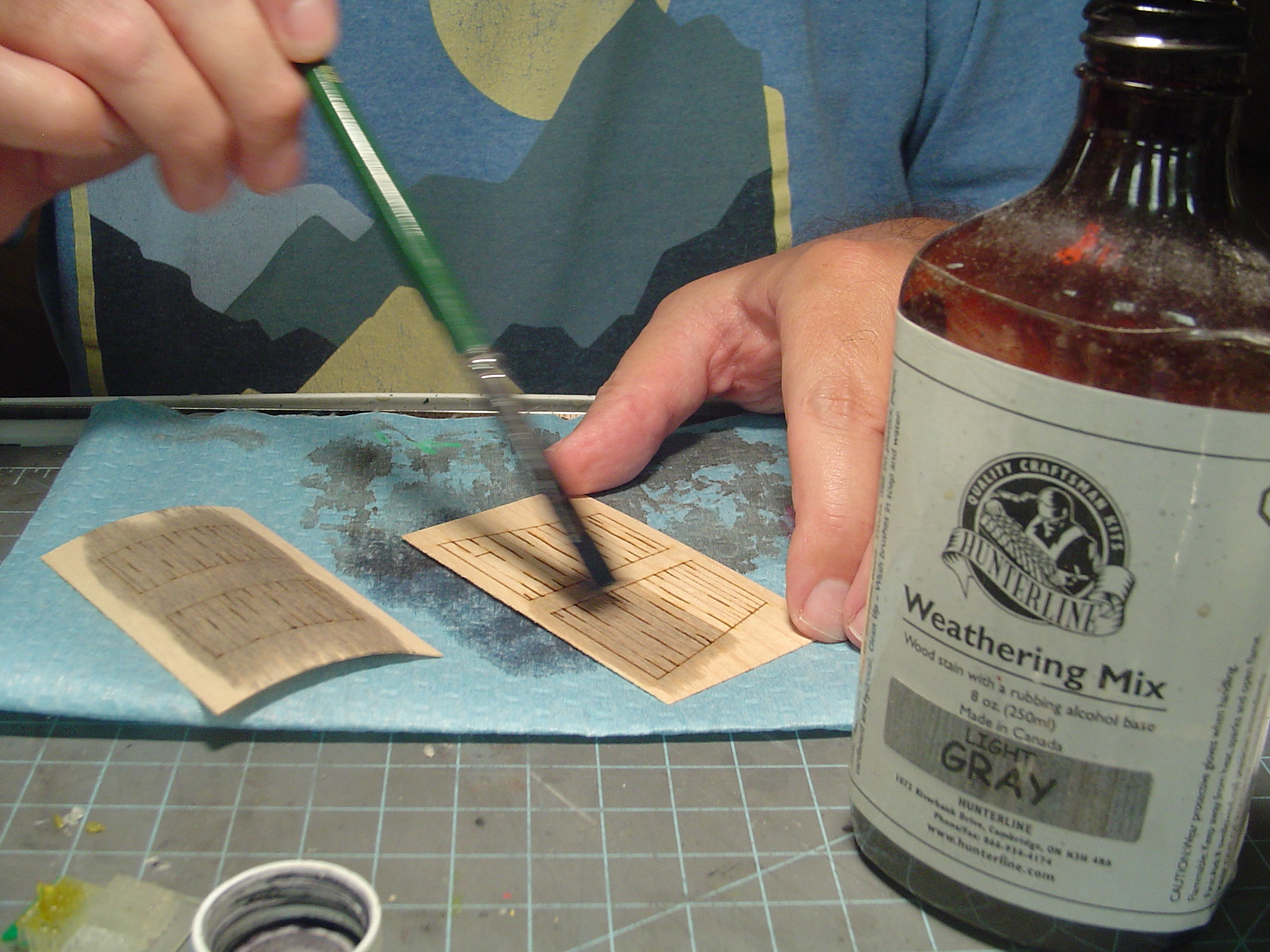

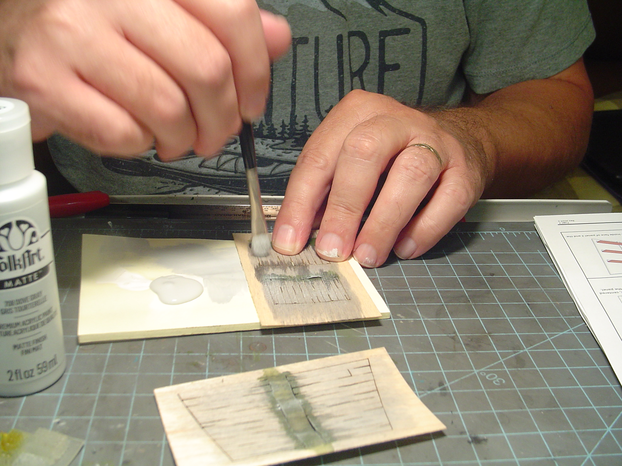

Then I applied Light Gray Hunterline Weathering Mix to the walls.
They're thin, so I weighed them down to minimize warping.

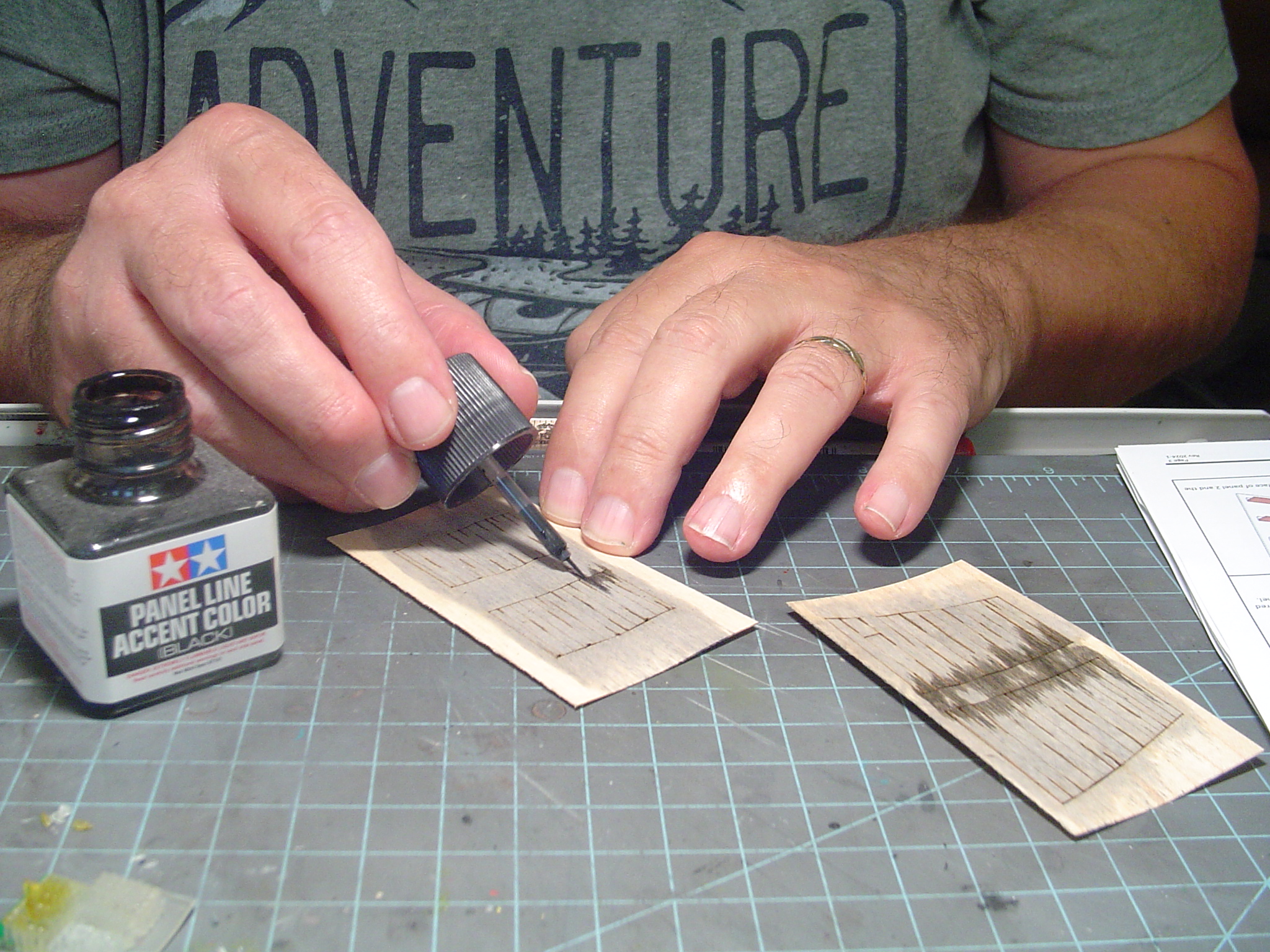

I added some weathering to the bottom of the walls using Black Panel Line Accent color. Just a touch near the bottom a letting it bleed upward. It's pretty obvious which is the bottom on the end walls but not so obvious which on the rear walls. The rear walls have some tiny notches at the top for the roof.

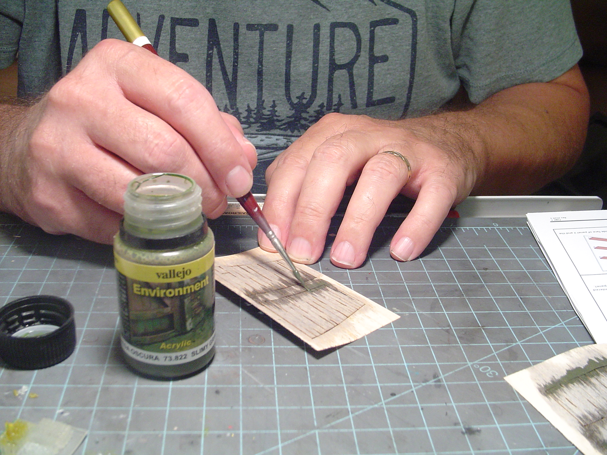

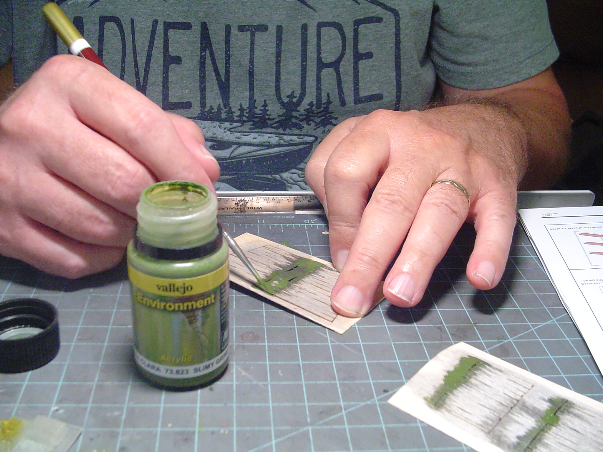

Then I repeated the process with some Vallejo Dark Green Slime.
I felt like the Dark Green Slim was too dark, so I went back and did this again with a Light Green Slim from Vallejo.

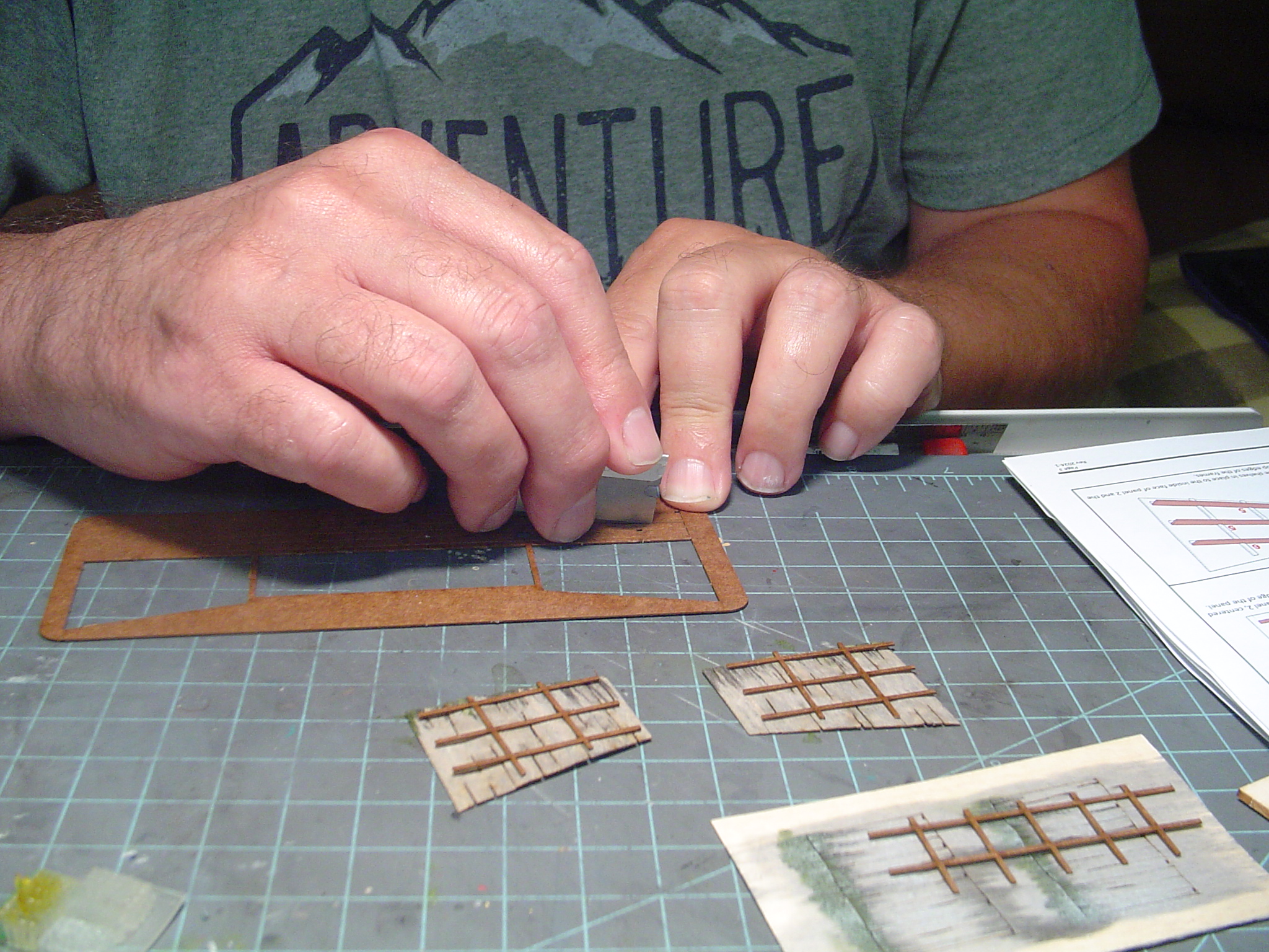

And finally (this is where I'm at this very moment), I cut out the parts that make up the benches, shelves and framework for the shelves. These are laser cut in a thin sheet of dark brown (reminds me of Masonite) material. I need to paint, and weather, these so they'll look like old wood. That's my next chore. They could have been painted and weather while still attached to the sheet, but I prefer to separate them first.

Thanks, Curt! The Panel Line Accent Color works fine for this. It's a trick shown in the video Darryl has on building this kit. I happened to have some sitting on the workbench, so I thought I'd give it a try.  :D
