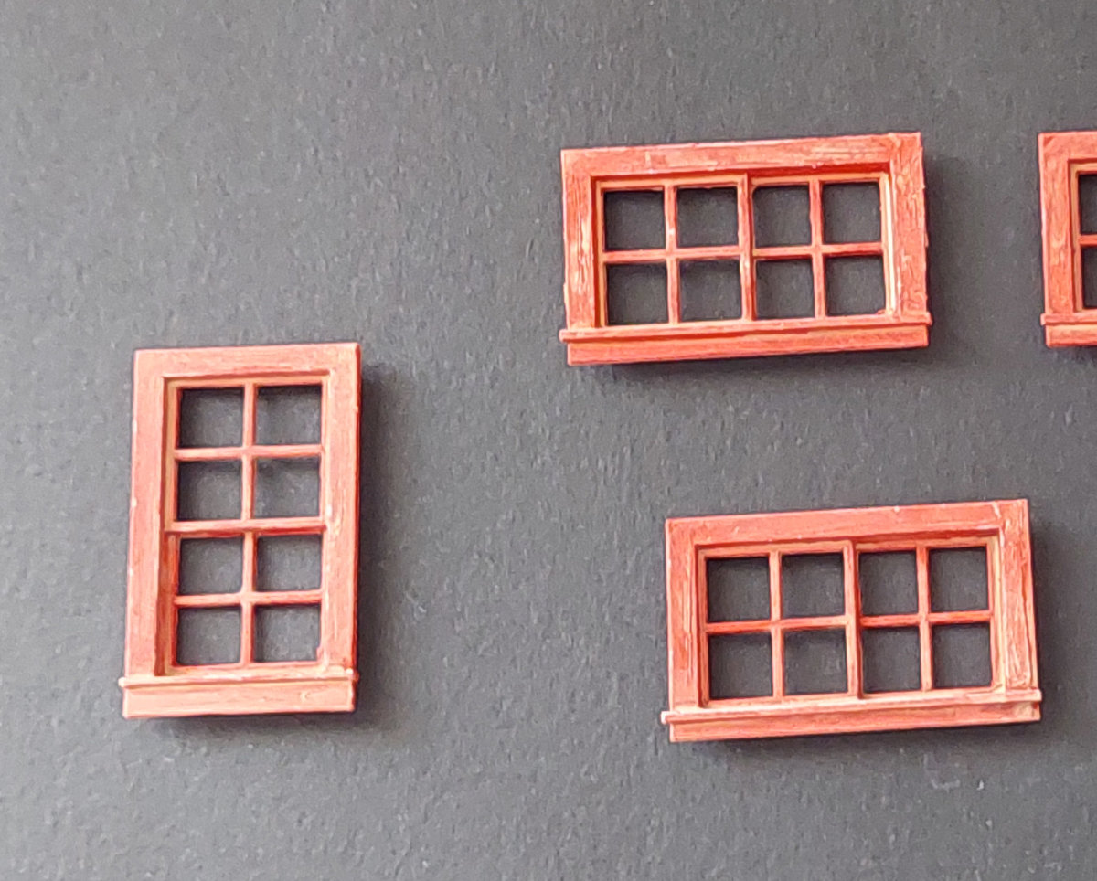

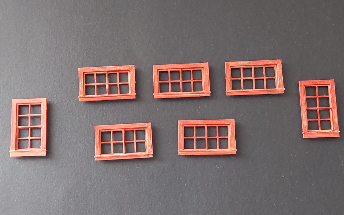

Next up I modified & painted all the windows. The windows on this structure run in two different orientations.
Three are normal vertical windows, but the upper five windows on each side wall run horizontal.
I have plenty of normal 8 pane vertical windows, so I just modified five of them to run horizontally by trimming off the bottom raised sash trim, turning the windows sideways and adding new sash trim along the bottom made from styrene.

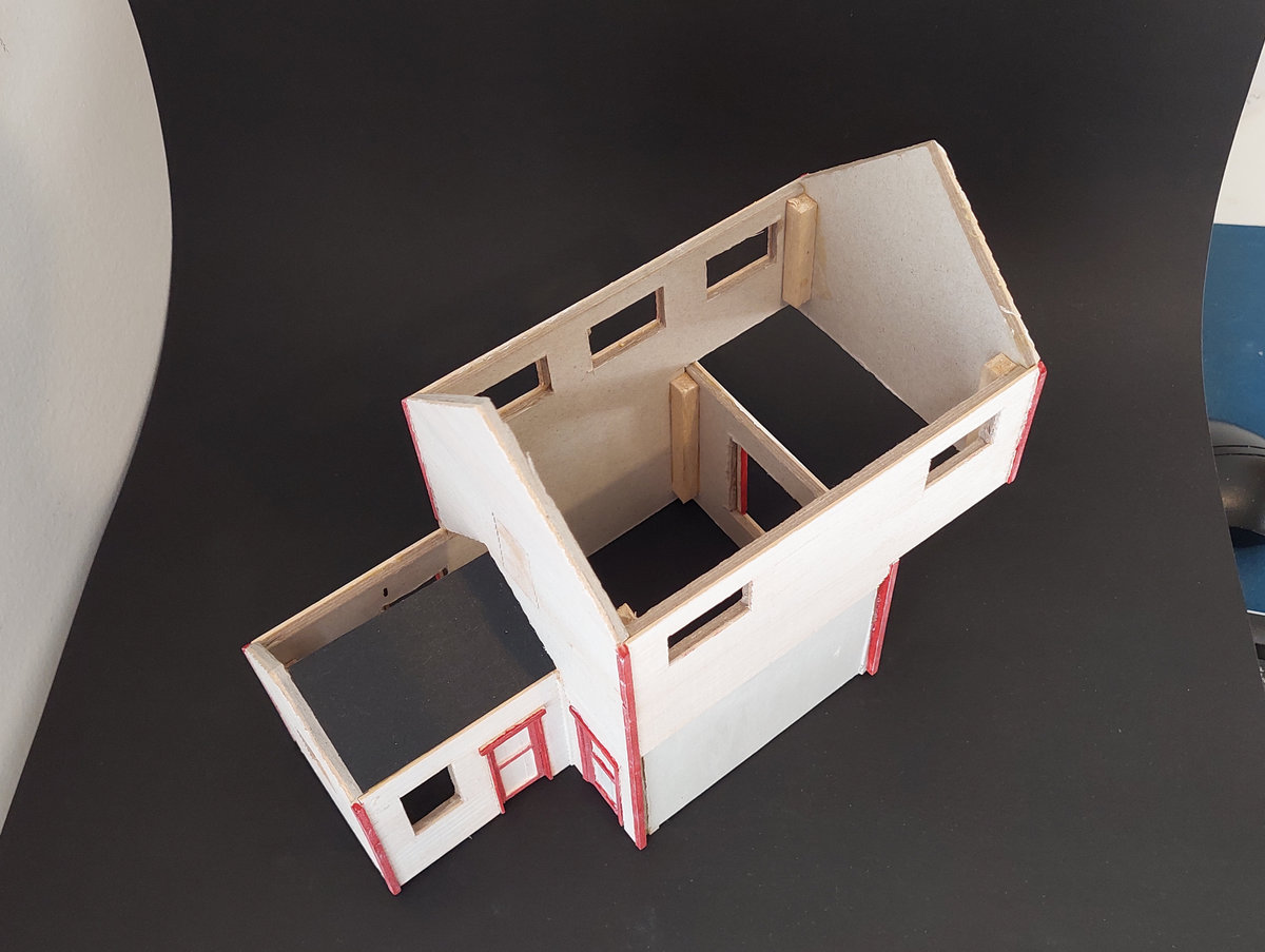

Here you can see the inside of the building.

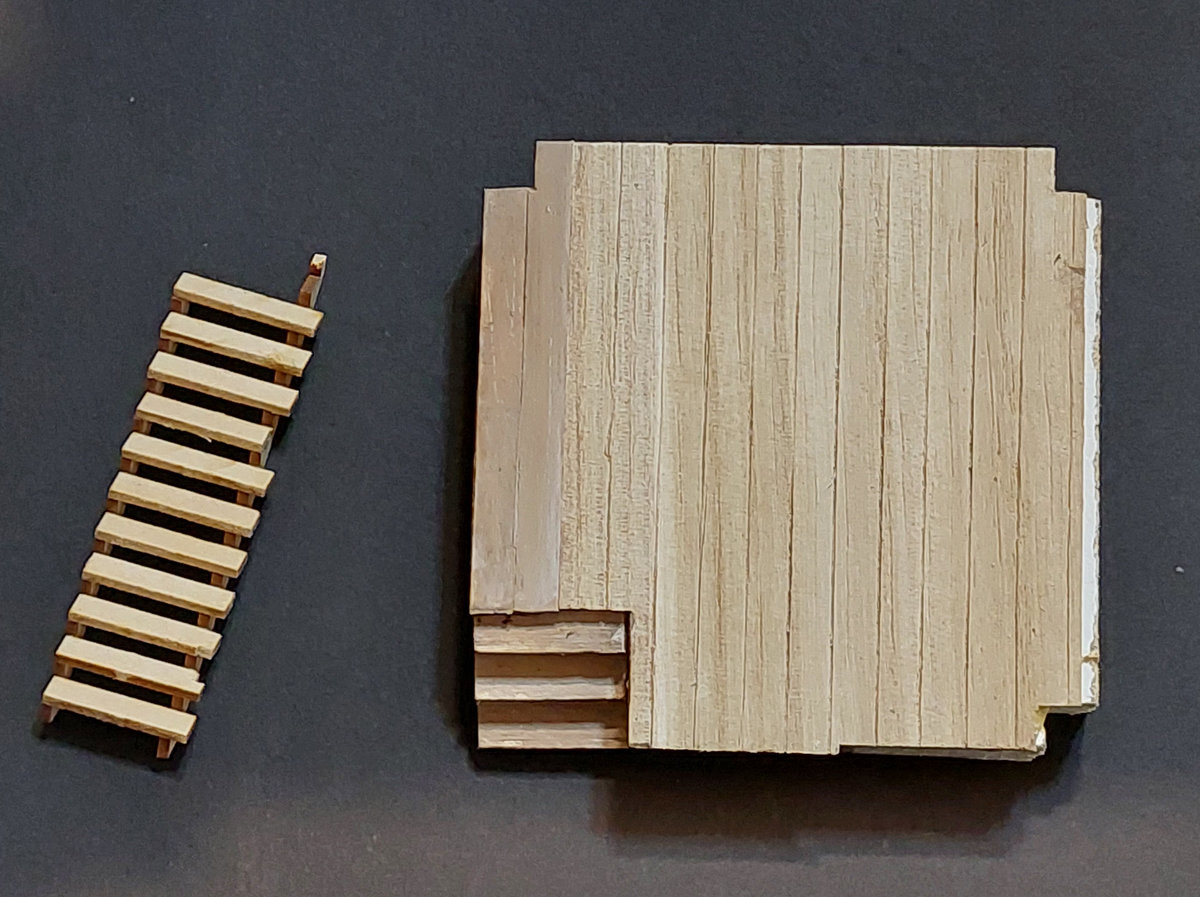

At this point I also made up a floor for the interior of the building as it will be lit & detailed inside.
Just used stir sticks for the floor planks, glued onto a piece of 12mm thick MDF.  As the bottom floor is actually two different levels, higher at the back loading dock than the front, I also added some steps.
And also made up a flight of stairs to go up to the upper level. Used Rusty Stumps stair kit for that.
