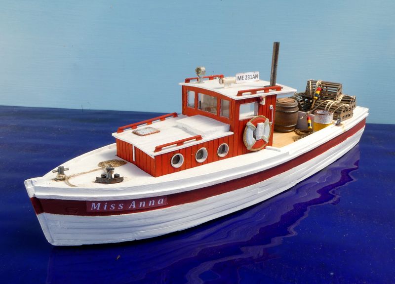

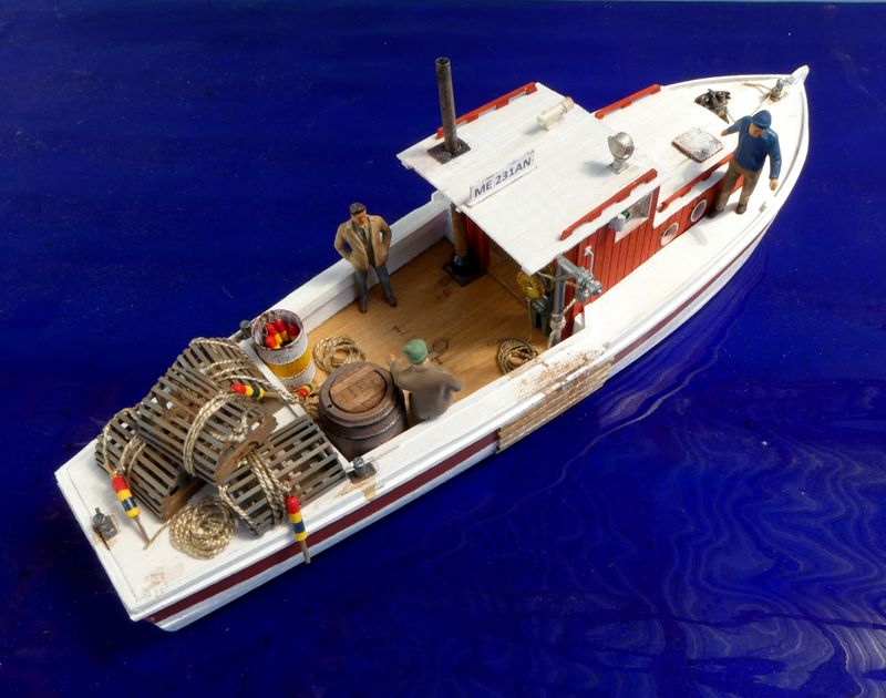

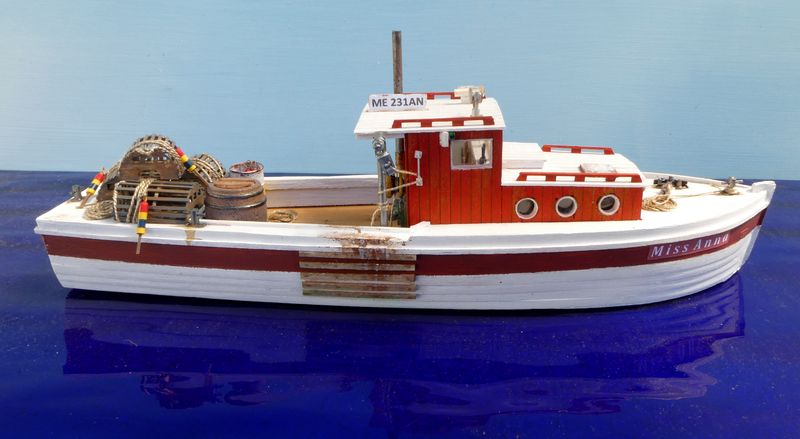

Hi Larry.  Welcome to the world of waterfront modelling.  Thanks for the mention.
Looking forward to seeing how you go with this.
Here is one of my 1/48 scale Maine lobster boats.  9" long x 3" at its widest point, so scales to 36'x 12'.  The very back of my lobster boat is 1 3/4", so 7'.
Regards  Rob

Quote from: robert goslin on August 29, 2026, 09:37:40 PMHi Larry.  Welcome to the world of waterfront modelling.  Thanks for the mention.
Rob you're welcome for the mention; your boats are amazing. It would be great having you following along on this one. The hull was a "proof of concept" to be sure I could pull it off. Thanks for your dimensions on yours, I may redo mine as the proportions seem a bit off to me. Thanks for the pics; those will give me something to refer to.
