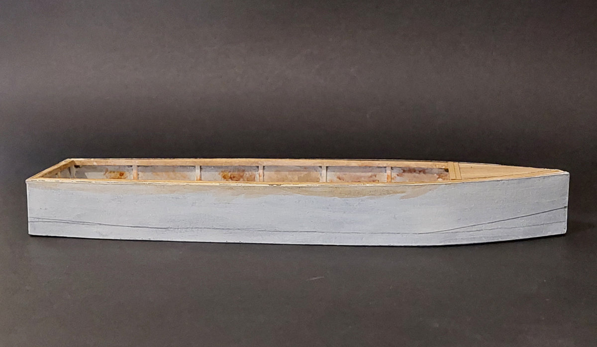

robert goslin
I've now added the gunwale around the upper edge of the hull.  Used two laminated layers of basswood strip for this.  And have enclosed the front portion of the hull using balsa sheet.
Then added the ribs.  Used 1.5mm x 0.75mm styrene strip.

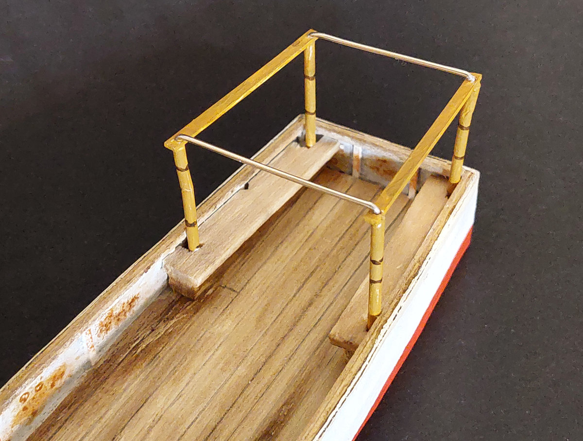

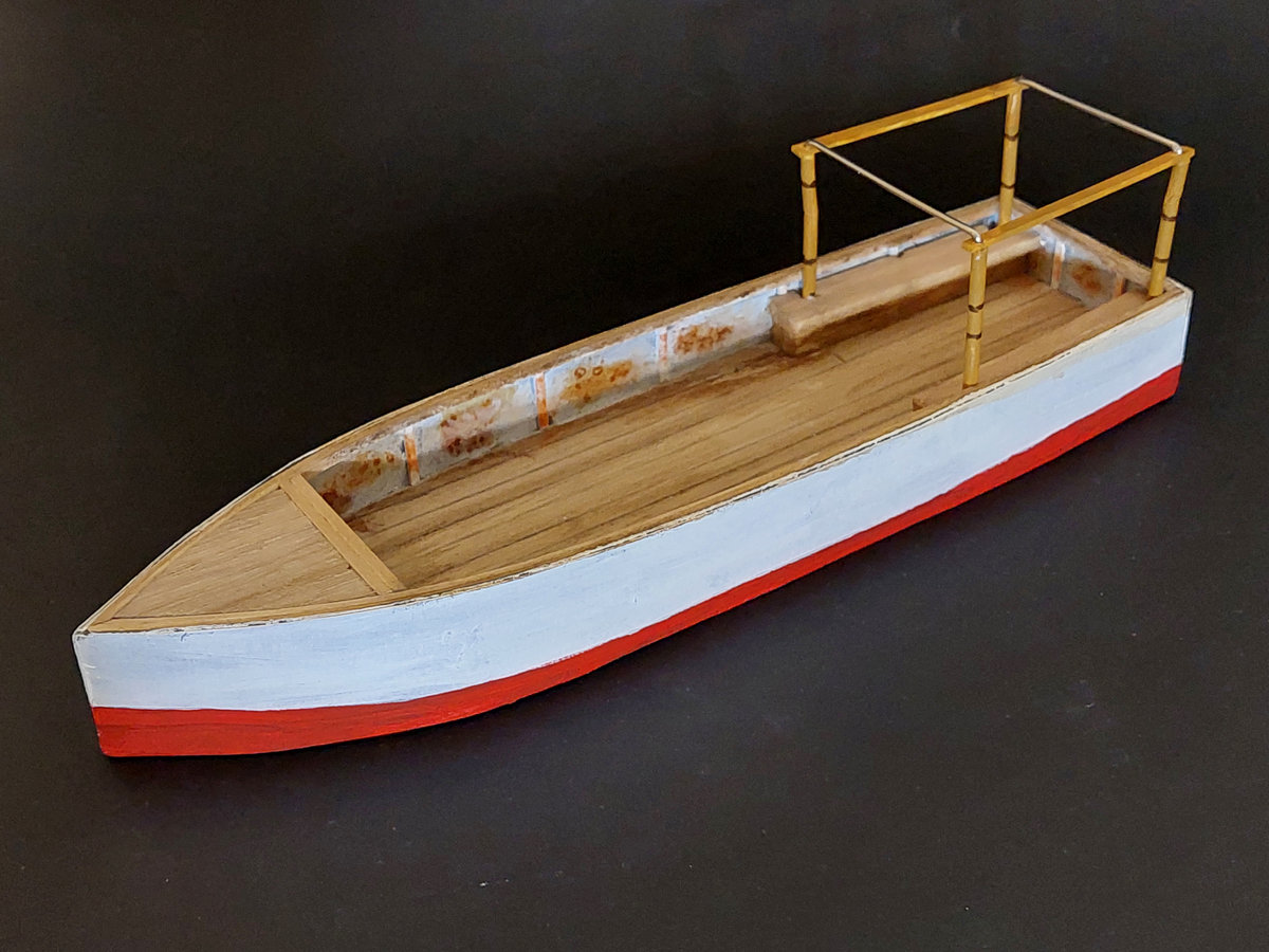

robert goslin
I have now got the hull painted white, and have outlined for the lower red section.
I forgot to take more photos after I had added the red.
The inside has been painted & weathered too.
For the rear canopy of the boat, the real one has metal tubing for the frame (refer back to prototype pics above).
I decided for my model, using wire would be too flimsy, so instead used 2mm styrene tube for the posts and painted to look like bamboo. Then used paperclip wire for the supporting frame.
I have also added the wooden seats.
You may ask why I have rusted the inside panels.  The real African Queen may look like a wooden hull, but was actually riveted metal sheets.
I still need to weather the outside of the hull.
