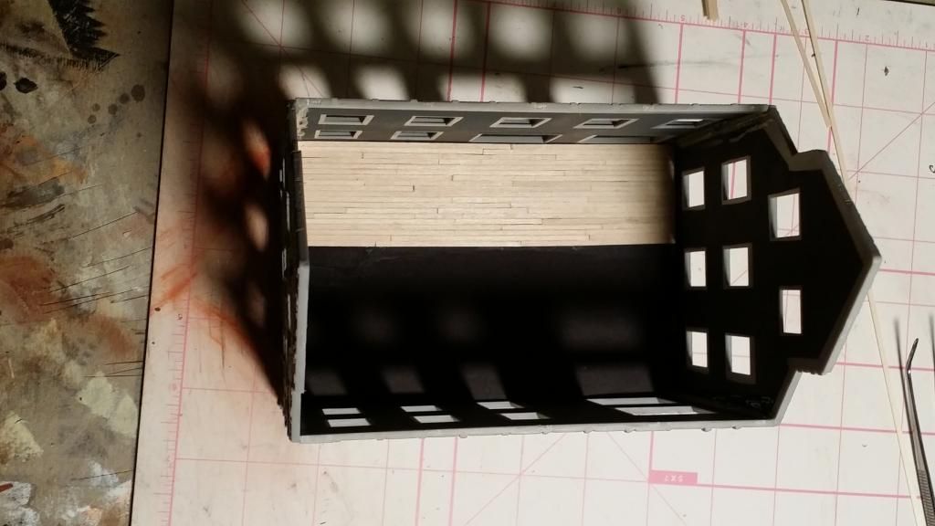

Just started this last night. Cut all the sprues and sanded smooth. Next I washed with warm soapy water to remove any oils and finger prints used  latex gloves. I did pat dry with paper towels and then primed with a light gray auto primer.  Then I realized that i should waited to prime bc I want to fill the gaps with putty. O well just re prime the edge again. Thats all for the moment.  Going to get some more done tonight

got everything taped off to paint the inside a dark color.
rustyfawcett
front and back are primed and ready to epoxy the wall up.
rustyfawcett
walls up and started on the floor. Time to call it a night.

The plastic used in those kits seems to be somewhat impervious to solvent cements.  I'd suggest gluing some styrene (1/4" if you have it) bracing inside the four corners to make sure it doesn't fall apart at some point :-(
The challenge is to fill and realign the stone corners.  Someone posted a how-to for plaster kits, where you use tape to mask the walls leaving only the corner joint you're trying to fill.  I've found "Bondo" (I have a small tube of the stuff) works well for this.  Then recarve the stones to get a better corner fill.
To prepare for painting, I prime with artist gesso in white or gray (depending on what color you want for the mortar, you can always tint the gesso), and then use make-up sponges to paint the tops of the (deeply incised) stones.  Alternately, you could use something like Pan Pastels.
I'm not fond of the thick/heavy metal roofing, so I built a new roof from styrene and covered it with slate shingles.  In this model, I glued the two long walls together to produce a flat that goes against the backdrop, and installed a blank styrene wall behind it to "complete the box".  The end overhangs a bit to hide the corner of the layout room.
