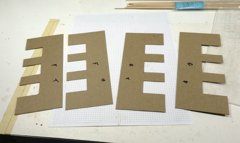

The roof is thick, I estimated about 12". Due to the roof pitch, it extends far down beneath the dormers. After I cut a master card template to fit, I cut 4 pieces of .022" card, 2 for each side. These will form the carcass of the roof.
I glued 6 x 6 stock to the side of one card, then glued the 2nd card on top of it at an offset to provide the angle at the gable end. This assembly gave me the necessary "bulk".
Two cards glued together and trimmed to the proper angle.

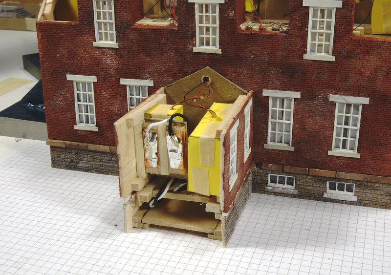

The "connector walkway" must be attached now because it has two lights that must be soldered to the resistor bridge inside the house. I also provided a solder point to connect the light tower, which won't be attached until the very end.

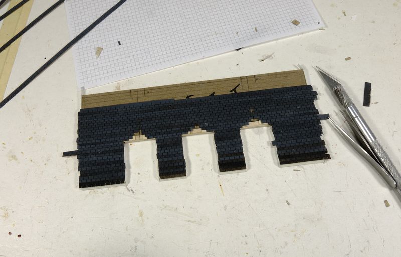

Started shingling the two main sub roof cards.... I previously spray painted these shingles black and gray...difficult to see during application...

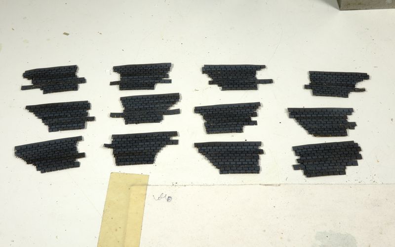

And the dormer sub roof cards too...

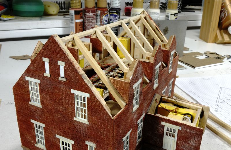

Due to the odd shape of the roof, I am using a prototypical style of framing support here, vertical rafters tied to a wide ridge beam. This will give me extra rigidity during dormer roof construction, prevent any sagging, and the wide beam will provide a solid level base for the two chimneys to come....

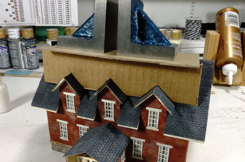

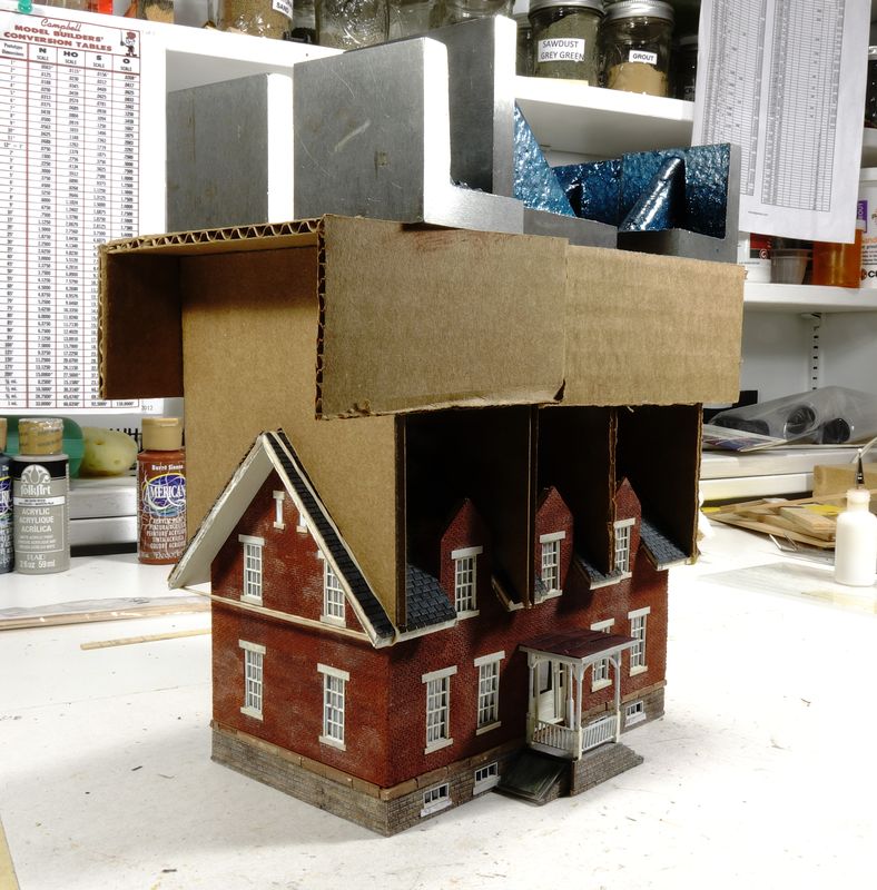

In order to get the roof glued down, I had to do.... what I had to do.....a cardboard cradle cut to the same pitch, to hold some weights at all the right spots.

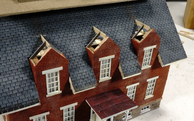

I built up the connector walkway roof supports in the back, and am ready to attach the shingled cards.
I used almost prototypical framing for the dormers roofing....
Then built another "cardboard concoction" to hold the roof cards down while gluing.

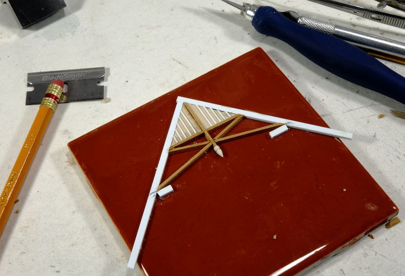

I knew the Victorian Gothic boarding and brackets (also called Apex trim) at the gable ends were going to be difficult. I glued two pieces of square styrene strip at the same gable roof angle (actually about 88 degrees) on a ceramic tile as a jig. Used card first as test pieces to get approximate lengths and angles.
Tried wood to begin with, but the pieces didn't paint up well and were way too rough. At the bottom is one of the finials I made on my Dremel "mini-lathe".
Switched to styrene for everything, and it was "cooperative".. Cut, fit, sand, fit, sand, cut.......

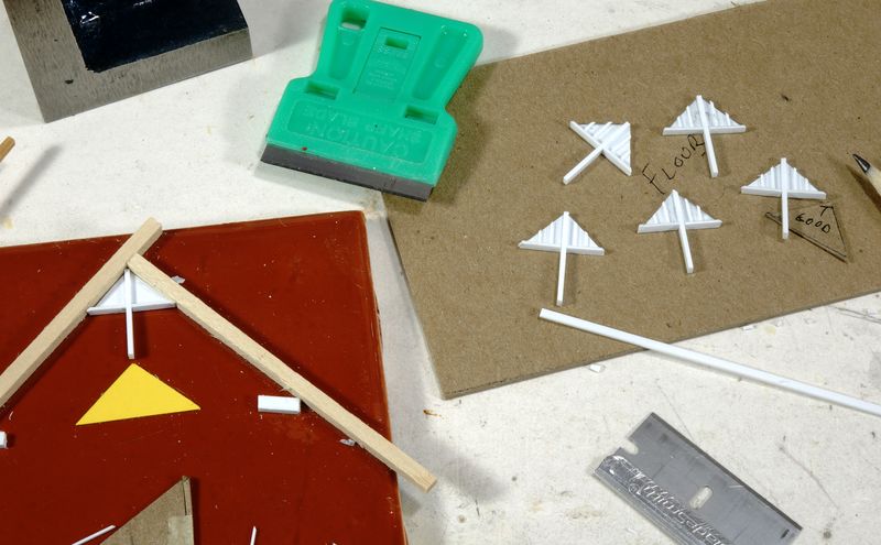

The dormer boarding are a smaller & simpler version of the gable ends. Using the same jig to build them, again with styrene, and built 6 smaller versions.

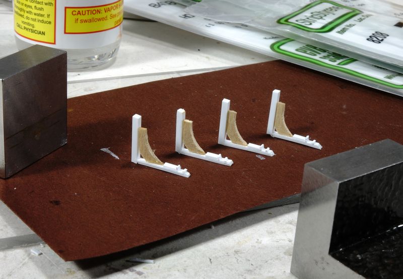

The main roof has eight large brackets, 4 for each side. These were a real pain and required several tries, but I eventually made some reasonable units. All styrene, except basswood for the curving piece. Ready for putty & paint.

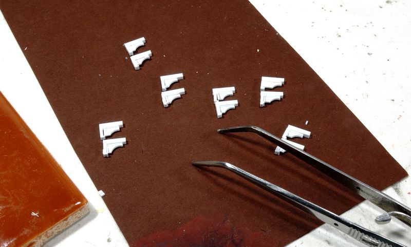

Each dormer has two simpler brackets, for a total of 12. All styrene, ready for putty & paint.
At 1/4" x 5/16", probably some of the smallest I've ever made....

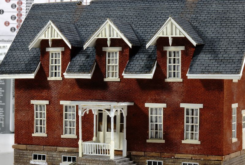

All painted and in place.
