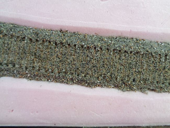

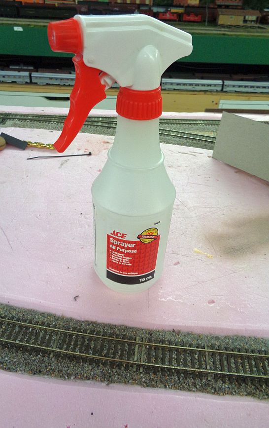

In order to remove the ballast, track and cork roadbed, I filled a spray bottle with warm water.
The water was sprayed on the track and ballast and let stand for about 15 minutes. The warm water softened the matte medium used to hold the ballast.
I simply lifted the track from the ballast and roadbed.

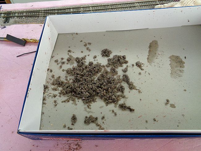

While the ballast was still wet, I used a putty knife and removed the wet ballast.
The wet ballast was dumped in a box and placed in file 13. 8)

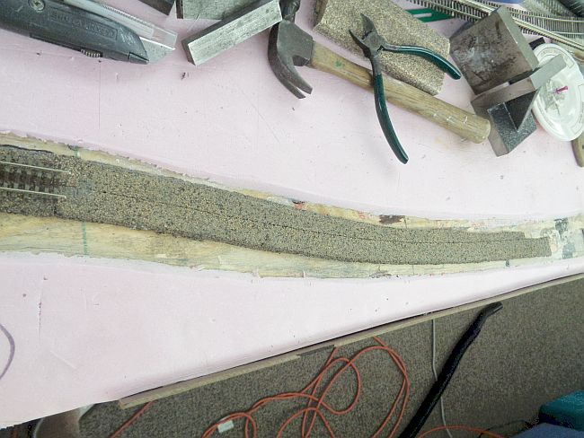

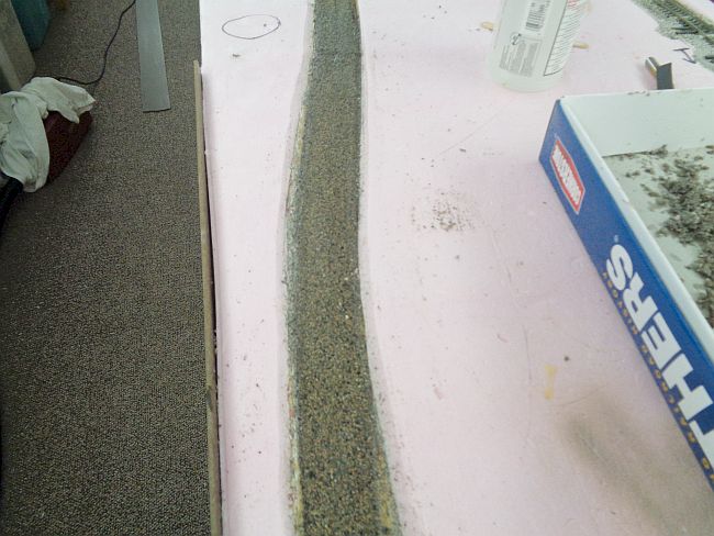

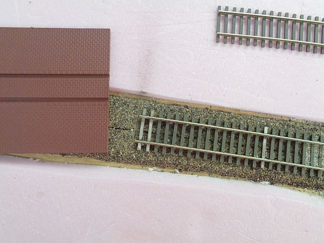

Normally I wouldn't try to save the cork roadbed. However, this section of roadbed was shaved down to the plywood level. I didn't want to have to do it again.
I refilled the water bottle with some fresh warm water and sprayed it on the edges of the cork. I let this soak for about 20 minutes and started to remove the cork.
To do this I used a sharp wood chisel.
Using the chisel beveled edge down, I slid it under the cork and slowly pried up the cork.
Continued -
I carefully bent the cork over onto itself as I went.
Once the cork was up, I soaked it in the utility sink and used a toothbrush to remove the rest of the glue from the bottom of the cork. The cork was then set in the sun to dry.
When the plywood area was dry the excess cork and glue was sanded smooth.

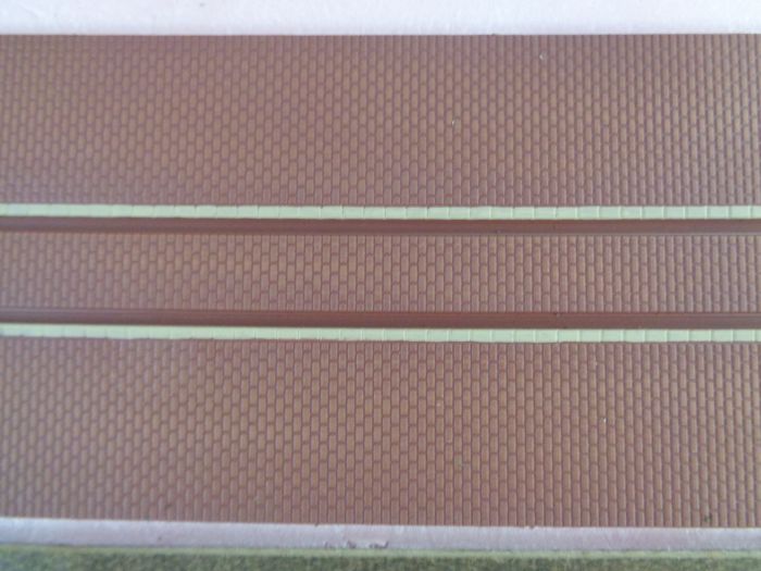

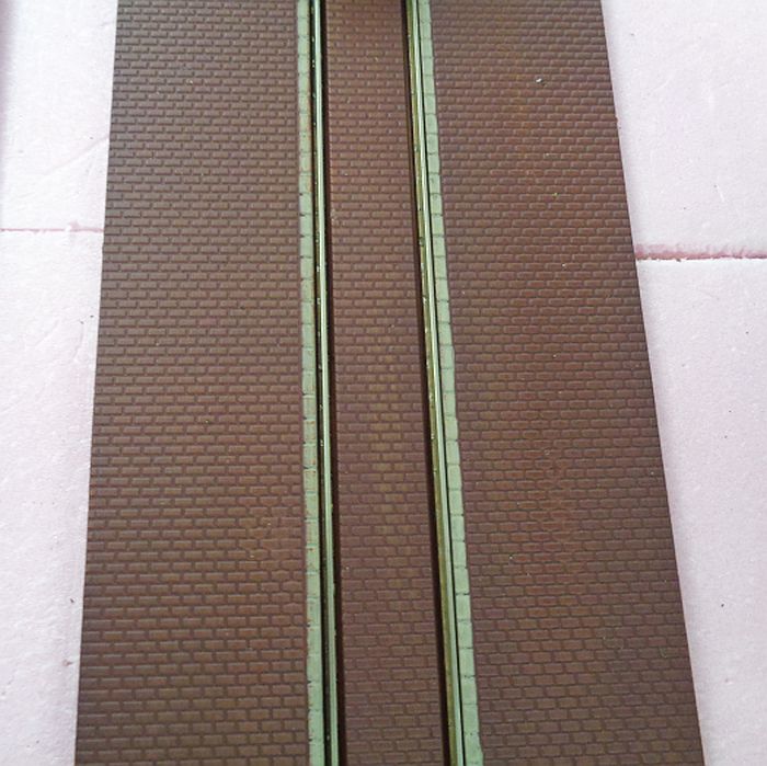

Once the Floquil Oxide Red cured, I painted the stones next to the rail pit with Floquil Aged Concrete. I then dry brushed onto the brick street pieces some Floquil Boxcar Red, Southern Freight Car Brown and Terra Cotta.
I then added a very light A&I wash, Hunterline Driftwood, onto the brick streets. When dry, I noticed some of the dry brushing colors darkened to the point of not being able to tell they were applied. I'll go over them later with some pastels.

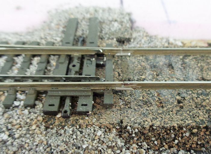

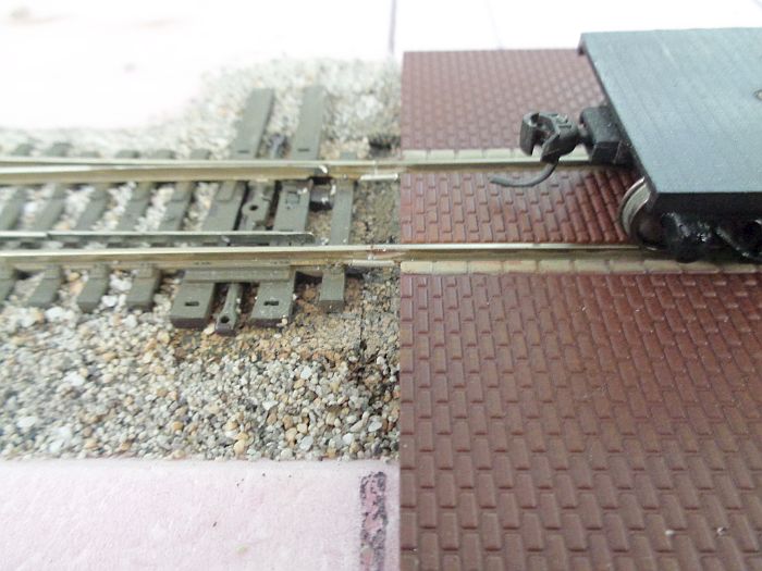

I soldered two sections of code 83 flex track together, measured the length I needed (five feet and four inches) and removed those ties.
In the next photo you can see I have the rails in place next to the turnout. These rails need to be soldered but I can't do it with the plastic street in place.
I took two rail joiners, cut them in half, and soldered the rails together.
I then added glue to the bottom of the street section, slid it under the rails and into place as shown below.
I did this with the other five sections of street. At this point the rails are still loose in the street sections.

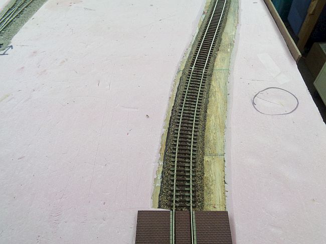

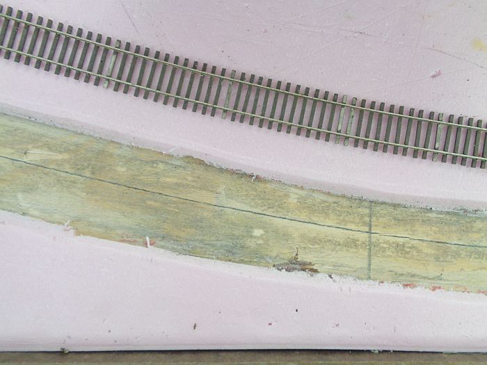

I curved the end piece of flex track to see where and how much of the pink foam needed to be removed.
It is a 36" radius curve.
Continued -
I'll fast forward here and say I removed the offending foam, added the "new" old cork roadbed and a section of new code 83 flex track.
