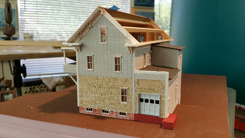

Good Afternoon Everyone,
A package from groovy Jeff arrived yesterday and I have been cutting and fitting the corbels to the building. I started at the right end and while fitting the roof, quickly realized that the corbels should be added AFTER the roof is installed. So, I quickly removed what I had done and glued the front roof down. Then I added the corbels in the front peak. Corbels were also added to the right side of the roof and I have started on the left side of the roof.  I really like the addition of the corbels. I had to do some angular cutting and size reduction to achieve the correct fit. I will be adding the rear roof next along with fitting for the chimneys. Awaiting the chimney order from Monster Modelworks. I will also be cutting the raised rib roofing for the front of the building, but more about that later. Enjoy the pic and I hope to have another pic this evening.

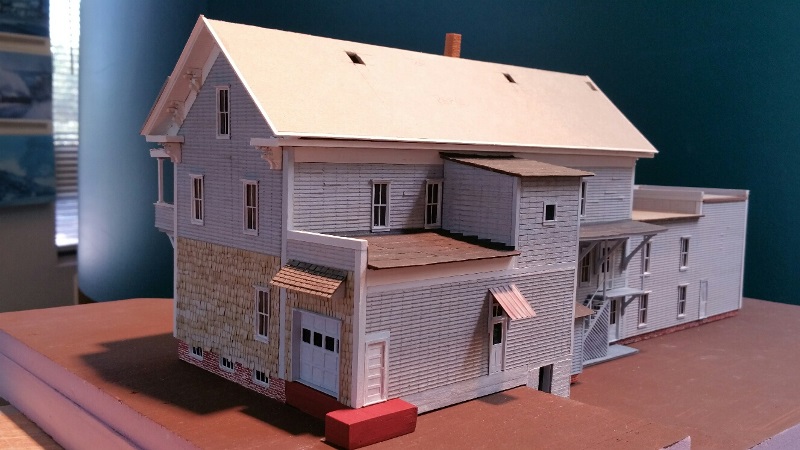

Erieman
Lots of progress today. on the back and side of the building, the shed roof was added over the door. the shed roof consisted of scribed lumber, cardstock and shingles. The shed roof over the rear door was also added. The rear panel of the roof was also was added, along with the chimney openings.One of the few remaining items on the rear of the building is the steps by the garage door. And now for the front view. NEXT.

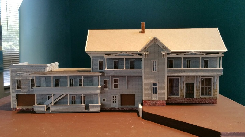

Erieman
Front view. The biggest change to the front view is the application of the standing rib roof panels. The first four panels have been glued in place. Possible the balance of the front panels will be completed this evening after dinner. I also started framing in the first opening on the left. a door and window will fill this area. The middle opening will be a window and is on the list for completion later this week. The real big effort will be the two porches, open lattice and steps. I hope that I can complete these later in the week. Chimneys have been shipped and my guess they will arrive tomorrow. that being said, I can see light at the end of the tunnel.

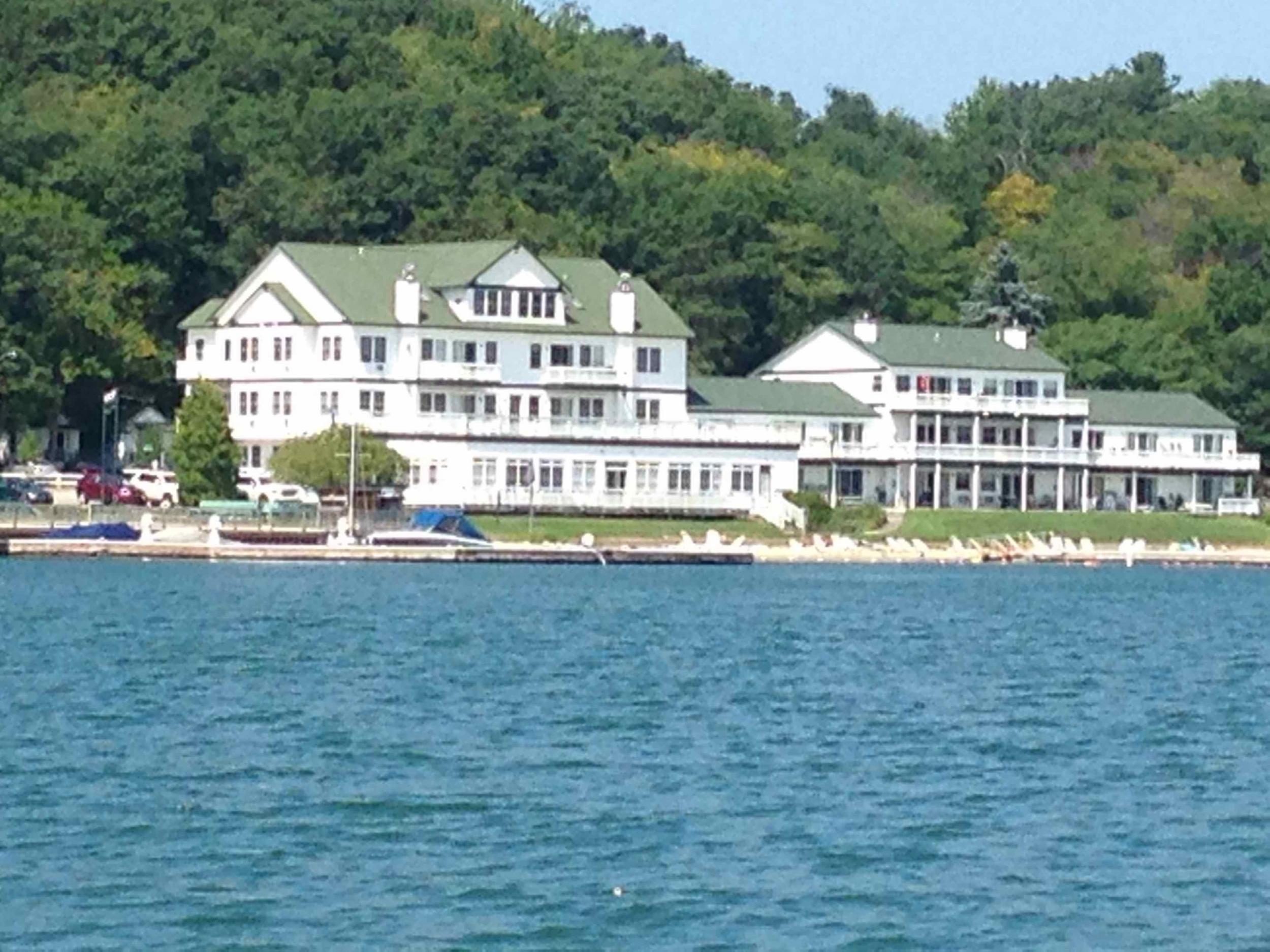

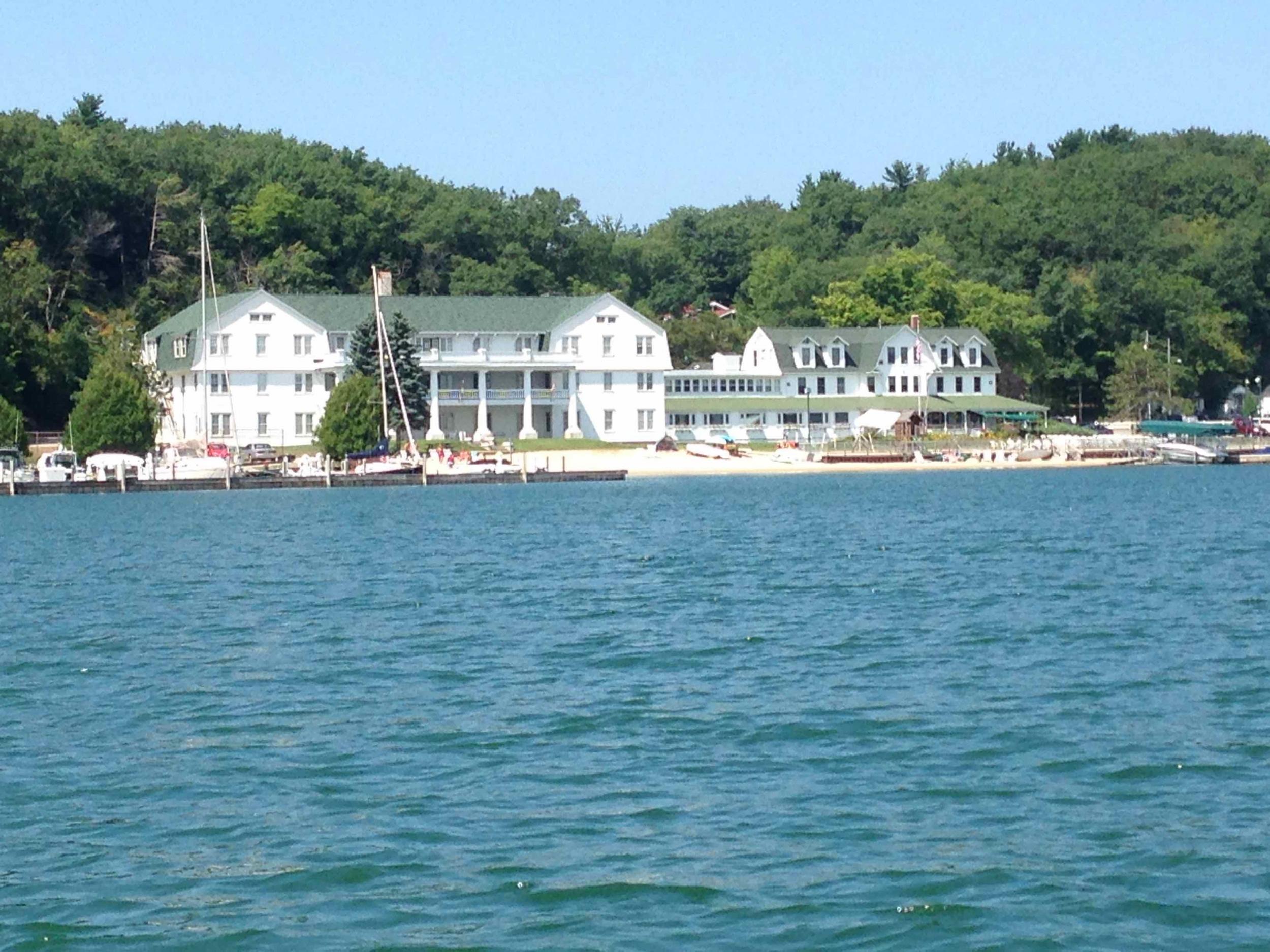

I was fishing and saw this hotel complex and for some reason it just looked like a structure that Frank should build. I posted these a few days ago in the baggage car but I wasn't sure if you saw them.
Right side of the complex from the water.
Left side from the water.

Erieman
Rear View,
Chimney installation and one piece of standing rib roofing. more to follow over the weekend. The will be a gutter hanging off the right end of the building. I have found a clever way to build the gutter. Now to paint it and weather it prior to installation. More to follow, probably Sunday. Need to work in the yard tomorrow AM nd then we have a convention meeting tomorrow afternoon. No rest. Later.
