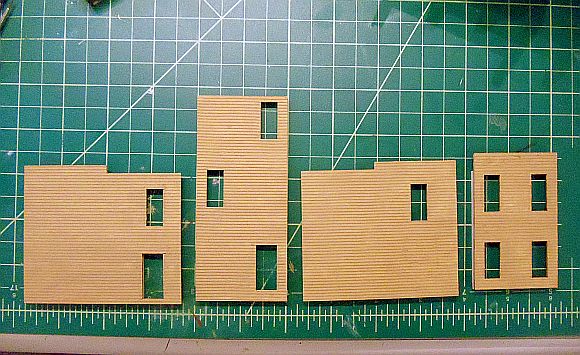

I filled in the crack using Hydrocal on the left side of the lower walls. I set the walls aside to dry.

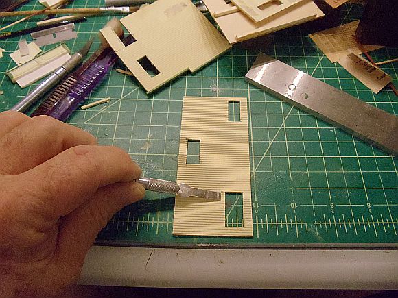

I removed the signs from the walls but still had quite a bit of cardboard left.
I used a Q-tip and water to moisten the cardboard and glue. When soft, I removed it from the wall. I then used a #17 Xacto blade to remove the build up of glue around the windows.

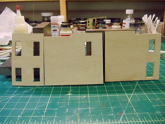

Here are the three walls with the signs and sign residue removed.
Things are looking better. Continued in a few.

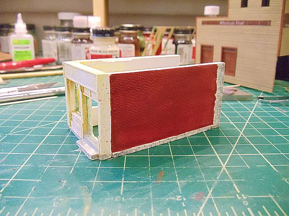

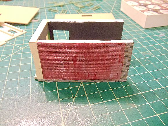

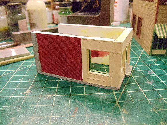

After repairing the walls and adding the correct bracing, the walls were painted with Floquil Foundation and set aside to dry.
I then painted the brick portion of the walls with Polly Scale DTI Cherry Red. The front and side of the office was painted with Polly Scale D&RGW Building Cream and the stone was painted with Floquil SP Lettering Light Gray, Concrete and Reefer Grey.
When viewing the following pictures, keep in mind all the walls still need to be weathered which will "tone" done the colors. The building was set aside to dry.
I forgot to mention I painted the interior window and door frame with Floquil Depot Olive.

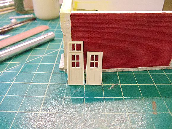

I mentioned previoulsy the fact that I broke the cast doors on the front. Here is what I did to fix the broken door issue.
I took two Northeastern doors from my stash and removed the top portion of the window.
I then glued the two doors together with CA glue and a short piece if scale 8x8.
I then painted the doors with the Depot Olive color.
And, here is how the doors look in the opening.

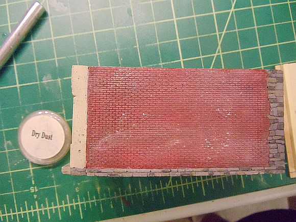

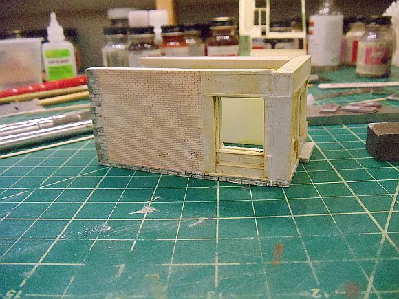

When the building and walls were dry I added some mortar mix to the brick areas. I used Bragdon Powders mixed with water and used a soft bristle brush to "paint" the mortar on the bricks.
I let this mixture dry for several hours and applied a very liberal dose of A&I to the structure. I used Hunterine Weathering Mix, the Creosote Black. Hunterline has an excellent selection of mixes for the modeler. They are out of Canada and will be at this years EXPO.
www.hunterline.com
When the A&I dried, I used some light colored pastel chalk and rubbed it into the brick areas.

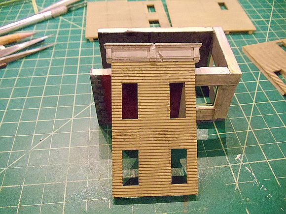

I made the repair on the Hydrocal casting that fits above the upper front wall section. I was going to fill in the broken section but decided the mising part added some age and character to the structure.

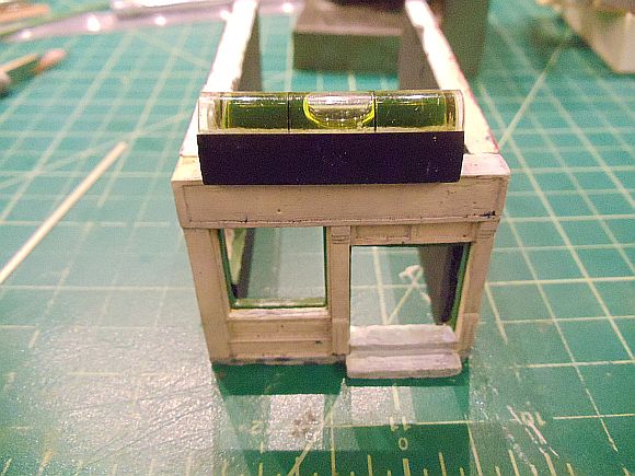

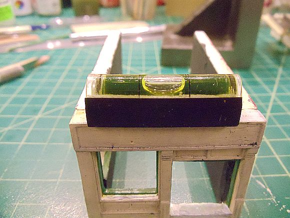

I kept looking at the building and noticed it was not entirely level.
I opted not to sand the bottom but instead added a short section of scale 1x6 to the bottom of the left wall.
This piece was glued to the bottom of the left wall, solving the problem.
