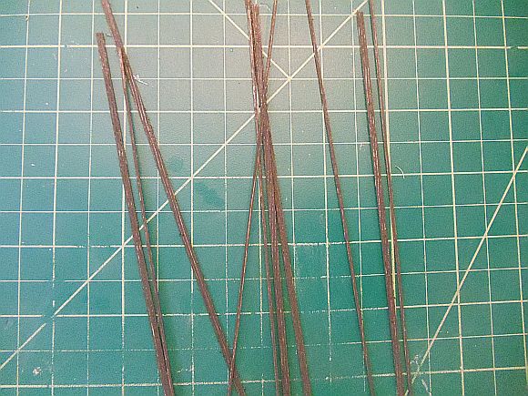

Time paint the scale lumber for the porch and make the stair risers. I used the good "old fashion George Sellios" method of preparing the scale lumber.
I used an old t-shirt and dipped some Weathered Black on the shirt. I then took each piece of lumber and pulled the lumber between my fingers and thus staining the lumber.
I then changed ends and stained the opposite end. And, fans, this is what happens when you don't wear a rubber/latex glove.
To weather the wood further, I used my Xacto medium tooth saw and applying medium pressure pulled the wood under the blade. Don't forget to do both sides of the scale lumber.
Here is what the scale lumber looks like after the saw method.

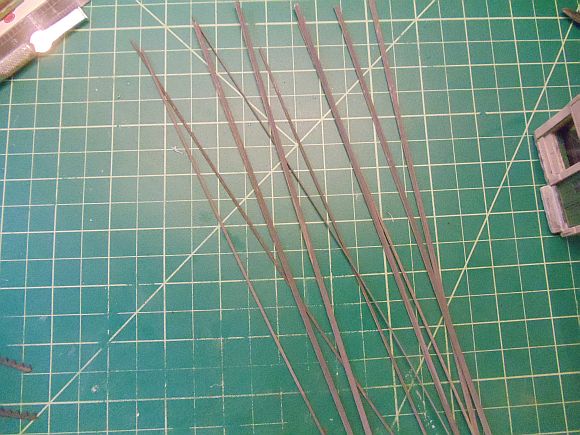

Don't worry what it looks like now. The next step will fill in the white spots and remove the "fuzz". Not the police, but the "wood fuzz".
I then used some Floquil Grime and pulled the wood through the t-shirt. This removed almost 98% of the fuzz and did fill in the while. Here is how it looks when finished. Nice and weathered wood. I'll add some pastel browns to the wood after it is installed.

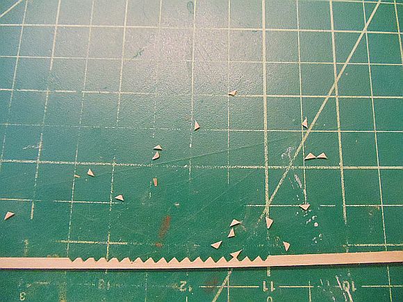

Time to scratch build some stair risers. I have to admit this process is a bit tedious and you'll get better with practice if patient. I started with a new #17 blade and some scale 2x10 lumber. Yes, a #11 balde is shown but I used a #17 for this job.
Start anywhere on the wood you desire. I've found that if I think of removing small "triangles", I can get a pretty decent riser.
The photo above is an excellent teaching moment. Notice as I moved to the left on the scale 2x10 I drifted upwards. Not to worry, just go back and cut a little deeper on the shallow cuts.
And here is what happens when you use an old and dull blade.
Here is what you want to end up with. Mine are already cut to length and stained.
