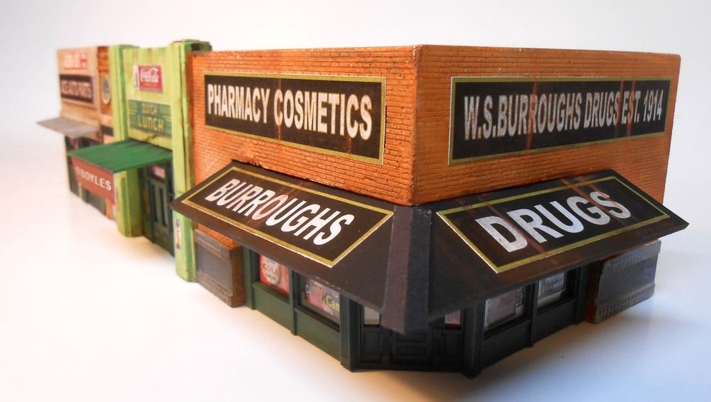

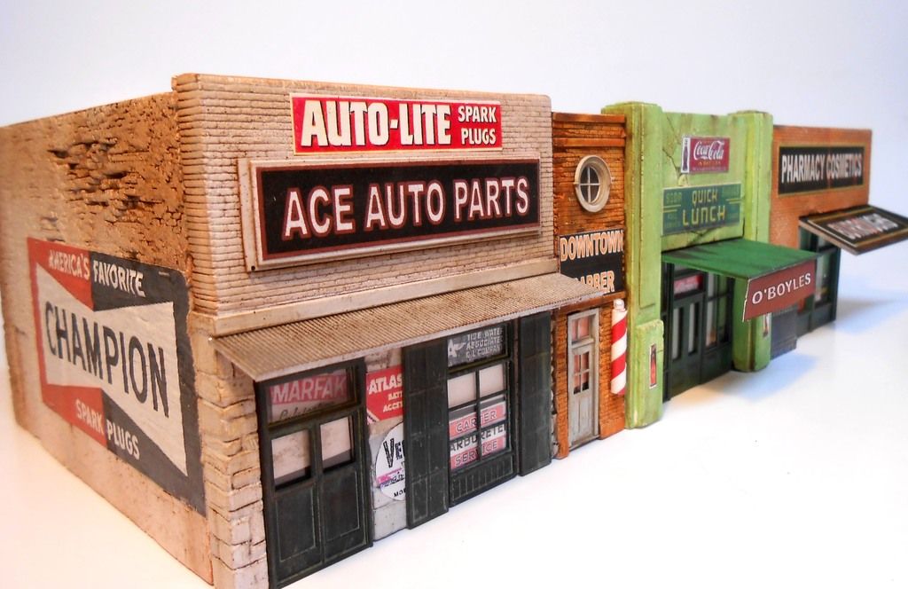

About a year ago, an old friend, as in good friend and old - he is 82 gave me a structure he built and no longer wanted. The structure was part of the SRMW Currier and Sons Cabinet Makers, Kit #230. The kit was released in late 2000.
The attached photos are from the photos that came with the kit. I'm rebuilding the yellow structure.
