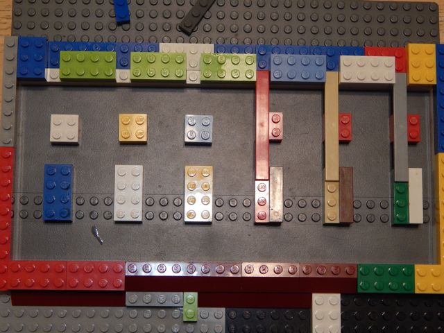

WOW!  It's finally starting to look like a depot.  Got the first floor glued up.  Used Lego Blocks to square the corners.  A little tip I picked up from a wooden ship building site.  Works great.  Also started cutting out the pieces that make up the second floor.  Not sure at this point in the construction how much detail I'll try to show on the 2nd floor.  The depot master and his family occupied the second floor in these 2nd Class Depots.  Might be nice to show a little detail.
