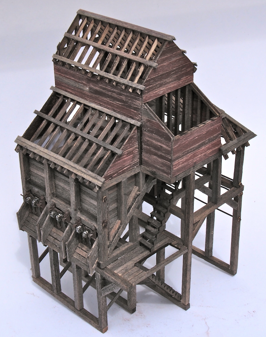

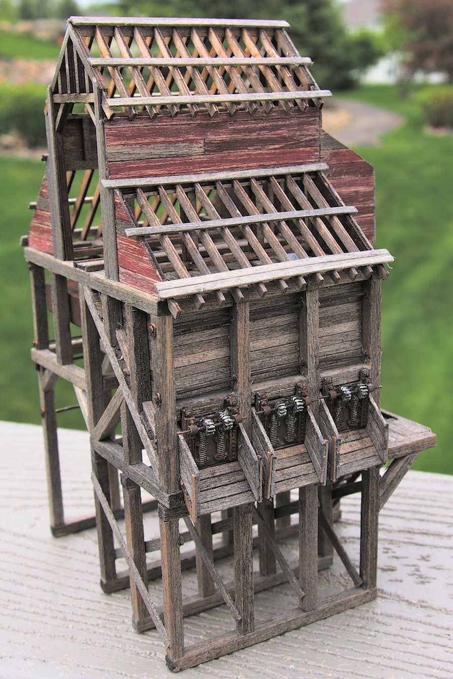

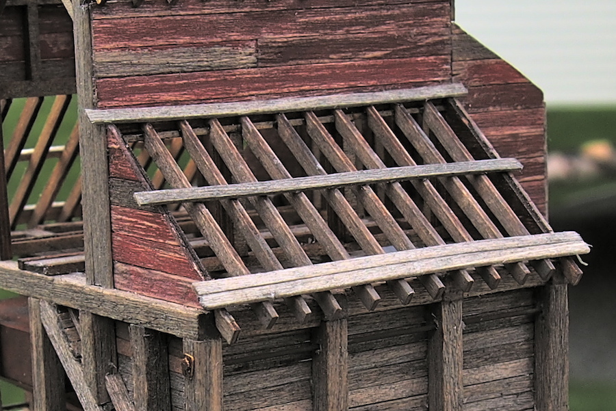

So the purlins are all in place, and it's time for that roofing material. I'm tempted to do something besides corrugated, like individual cedar shakes or tar paper, but I will give the new spray primer and chalk-dusting method a try.
For the first time I am not going to use the "Evil Etchant" and will try Brett's (and Roger Malinowski's) method of coloring them with chalks. Of course if I'm not happy with the result I can always just start over with my old ferric chloride circuit board etchant.
If you are never going to build this kit, skip this paragraph. Bill Obenauf said in his build-thread on this kit currently running on the Sierra West Scale Models forum that there is an inconsistency between earlier versions of Template 1 and p. 40 of Brett's instruction manual. The lengths of the panels should be 9 at 1⅜" for the lower roof with hip roof; 5 panels at 1 5/16" for the lower roof above the ore bin; and 10 panels for both sides of the upper tipple roof. Before you cut, check the lengths on your model. It is important to trim the corrugated stock to the longest length you will need before you begin cutting the panels. If you trim the stock strip to the shortest length first you'll waste stock and could run out of it. As Brett says "cut the panels down to size measuring off the roof itself and move on with the construction sequence."
Maybe the above will help somebody somewhere. Anyway, here are some progress pics before the roofs go on.

I love that outdoor shot of the tipple. It looks great! I am glad you said something about the panel sizes, I would have cut right of the template.
