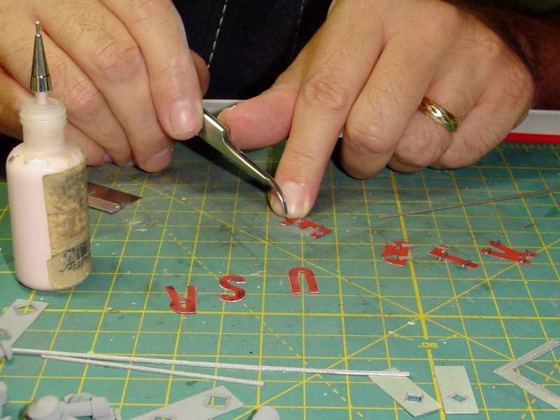

The builder has the option of raising the Burlesk letters slightly to light them from behind (the wall is laser cut to allow this).  No way was I going to pass up an opportunity to light the Burlek sign.   :D  To raise the letters slightly you have to first glue tiny strips of strip wood behind them.
I glued strips of wood onto the back of the letters that were slightly longer than needed, flipped the letters over and trimmed the excess off with a single edge razor blade.

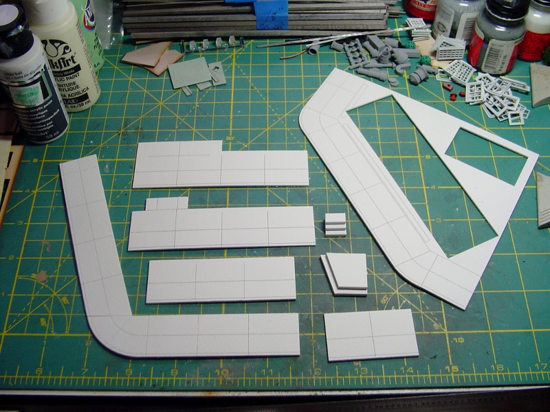

I needed two of the sidewalk piece for the South Side Bulesk house so since I was going to be painting sidewalks I gathered up all of the sidewalks and also constructed the steps for two of the structures (one set being for the Burlesk house) that are supposed to appear as if they were cast out of concrete.  I primed everything with several coats of flat white primer from a rattle can.  I even painted the underside.  I want these to be well sealed for the next step.
My preference for concrete is to apply several light washes of thinned out acrylic paint.  I thin the paint to the point where it's more like dirty water (as you might be able to see here).
I really don't have a formula for this other than to finish with Wrought Iron Black.  In this instance I wanted the sidewalks to appear a little bit newer so I didn't go overboard with the density of the washes or the number or washes I applied.  Here are the colors I used in the order I applied them (from left to right, top to bottom).
Had I been shooting for something a little older I would have applied more washes and/or more dense washes.  After everything dried I sealed the sidewalks with Dullcoat.  I may still apply some weather powders and rust stains which will further age the sidewalks.

Fantastic build Bob and a most excellent tutorial for all the steps. I love the before and after of the sidewalks.
Great job!
Okay,  here's one of my sidewalks next to a scrape piece that I painted with PollyScale Aged Concrete.  I don't think I've ever seen real concrete, new of old, that looks like the Floquil/PollyScale Concrete or Aged Concrete colors.
