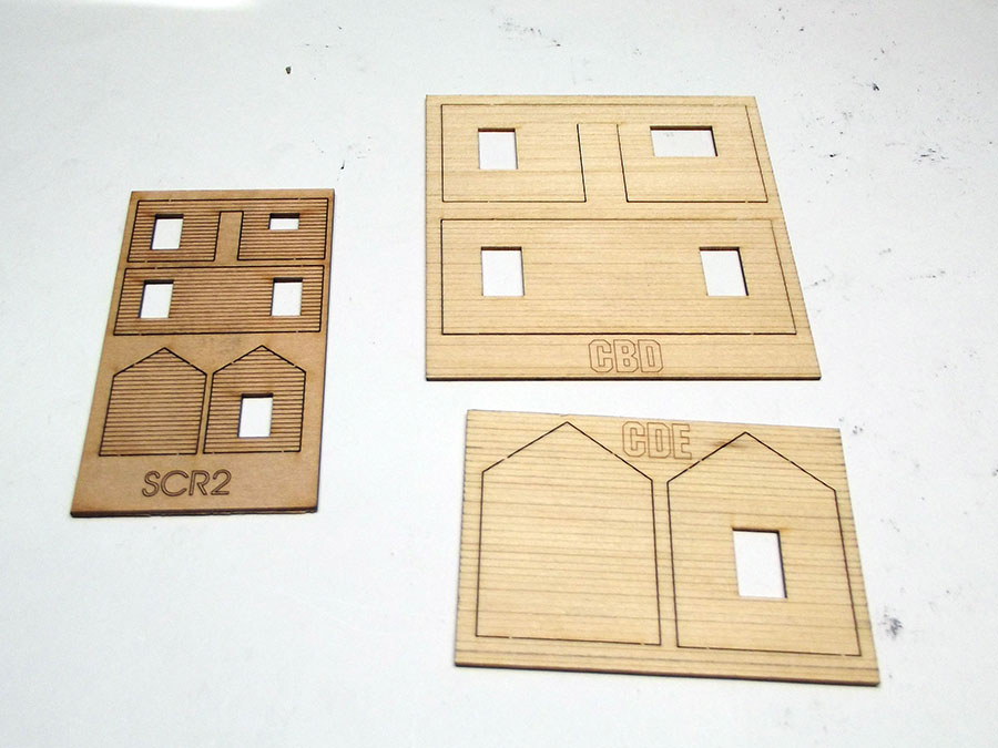

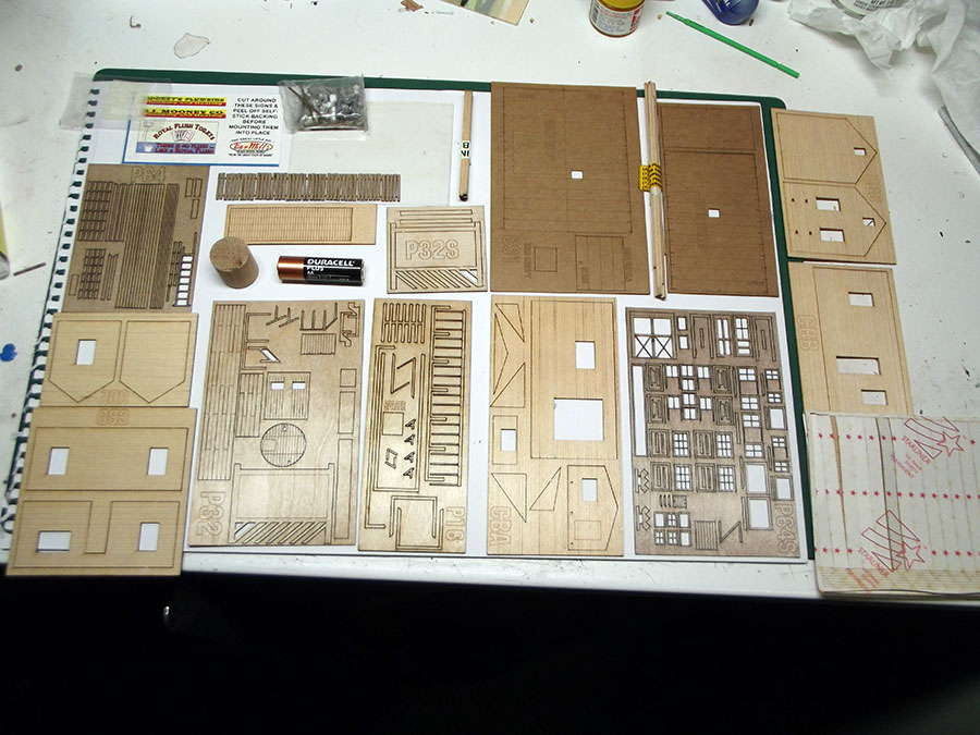

The N-scale parts. Tichy windows, less cast white-metal parts, and of course much smaller.
The H0 parts. Peel and stick windows and doors, more white-metal details
The same parts next to each other.

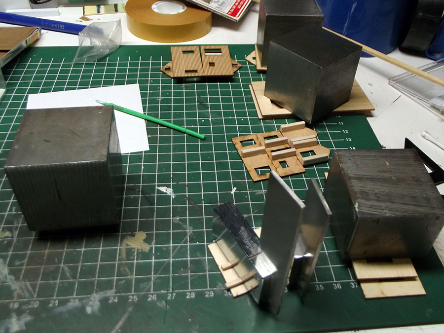

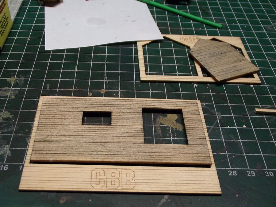

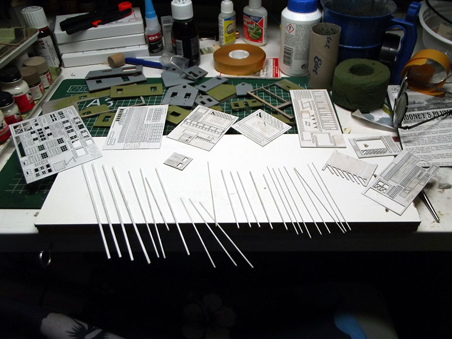

Bracing all the walls.

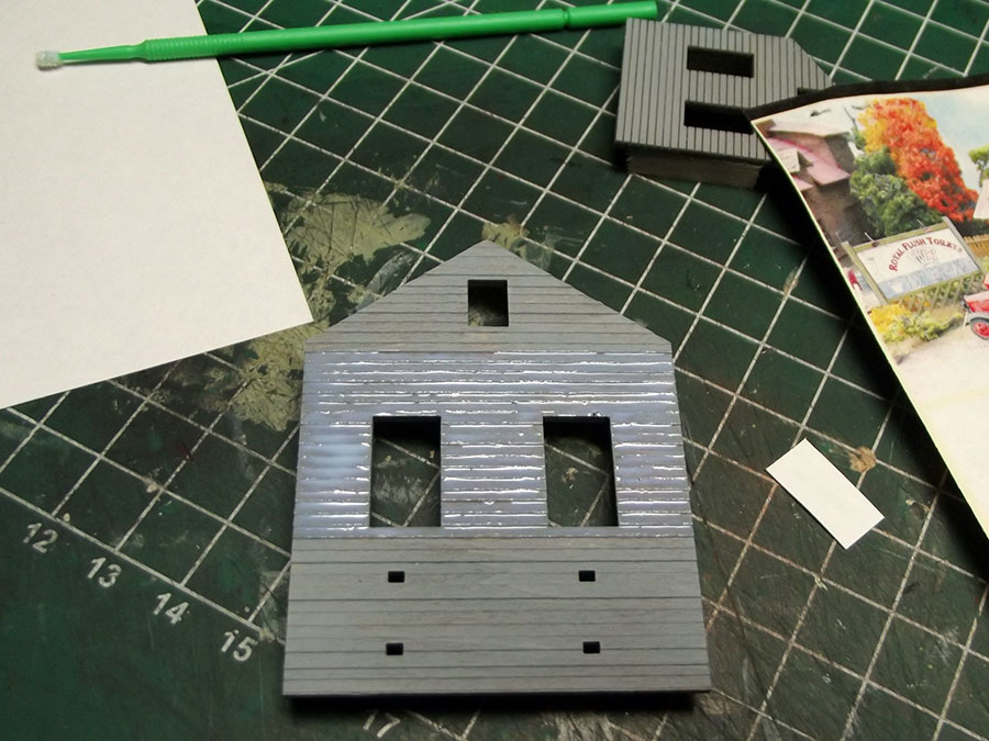

A & I wash, the wall that's done compared to it's holding part.
#1
All the bracing done.
A dusting of gray primer from a rattle can.
Here you can see that is just a light spray and not really spray painting the walls.

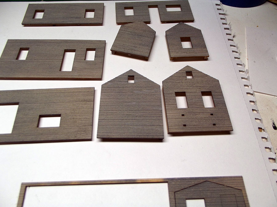

Paint colors Pollyscale New Gravel Gray and Pollyscale Weyerhauser Green. This is where the HO build differs from the N-scale one for the first time. While I would call the H0 walls painted ( not a wet paint cover, but also not drybrushed ) the N-scale has to be drybrushed to get the weathered paint effect, and even then it's hard to not cover the N-scale walls.
You can clearly see that even though drybrushed the N-scale paint is more monotonous then the H0 scale paint job.

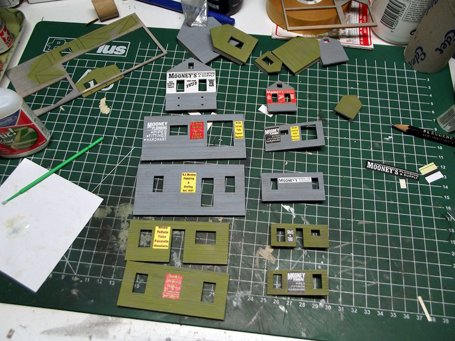

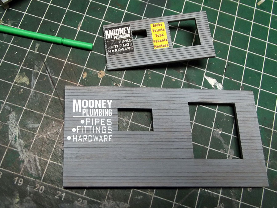

On the left the printed signs for the N-scale kit, H0 to the right.
An emery board to just very lightly sand the back of the printed signs, do this before you cut them.
Instead of putting glue on the sign I put glue on the wall , this was easy because the piece to be glued was bordered by the ends of the wood and exactly between the lines on the clapboard.
I like the red sign in N-scale better , unfortunately the H0 kit only has Black or White.
Some more signs, put glue to the signs and then stuck them on. The H0 kit has a dry transfer , somewhat easier to install then the glued signs, but maybe looks a bit too new.
All the signs on the walls installed. H0 left , N-scale right.

I agree - the red and white sign looks a lot better than the white and black one. The red colour seems to have a more aged look too.  You could maybe rub some of the dry transfer off to help age it?I think maybe that font with the lower case 'i's is a bit more modern too.
rslaserkits
Jan,  take the N signs and have them copied at 184%  then you can use on the HO kit.
and your right the red looks better by far.
