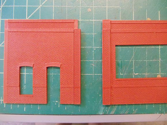

I made the cornice sections and placed them at the top of the walls. In the photo below you can see the cornices prior to the gluing.
I started with the two arched openings. This is the front of the lubritorium.
I then moved to the side walls and added the cornices.

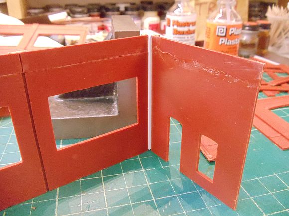

Time to glue the corners. DPM doesn't supply the next needed item so get some while ordering the other parts. You'll need some 1/4" or HO scale 8X8's for the corners.

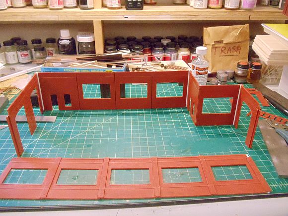

I'm going to glue together the two walls shown below.
Notice the wall on the left has a narrow pilaster and the one on the right has the wider pilaster?
These two sections of pilasters are a pair. Whenever you have an outside corner to glue the two are both used. This gives you a constant with all the walls. If you used two narrow ones together and/or the two larger ones, the walls won't be square when you go to glue them together.
Also, the narrow pilaster has brick detail on one edge and the other edge doesn't. See below.
The narrow pilaster with the no brick detail edge is glued to the back side of the larger pilaster and not the other way. The key is to be very consistent when gluing the wall corners.
Next, cut a piece of the HO scale 8x8 and glue it to the backside of the wall.
Now your walls should look like this.
Next, glue the other wall in place. The backsides should look like the ones below. The white scale 8x8 fits flush in the corner of each wall section. And, don't forget to square the walls while the glue dries. That tip is free.

Okay, I'm back! Here is how the outside corner should look. Notice the narrow pilaster butts up the the wider pilaster for a nice fitting corner.
Next, glue the narrow and wider pilaster caps in place as shown.

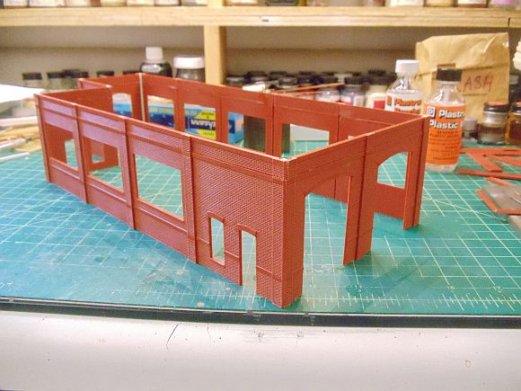

Gluing an inside corner is a little more tricksie!
I was going through my bag of wall sections and then read the instructions and found that the inside wall corners aren't supplied with he wall sections either. The instructions state, "Use Inside Corner Strips (sold separately, included with Design Bulk Packs and Roof & Trim kit #30190)"
What the Fudge! Get it? Nice to know now that the project is started. So, instead of buying the little extra kit, I used the HO scale 8x8's. The walls will be painted anyway.
I glued the HO scale 8x8 on the wall where the large pilaster would normally be glued.
I then glued the other wall section to the 8x8 making sure the walls were square while the glue dried.
I then glued the five window wall section to the rest of the structure.
Now all the walls are glued together.
