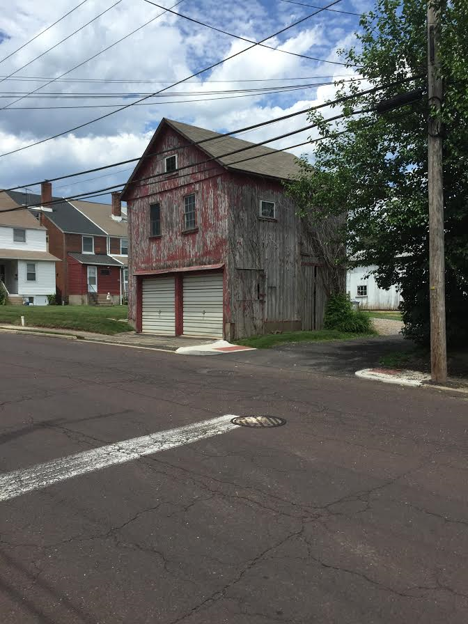

I'm going to try to duplicate the color and weathering of this garage in my neighborhood.
My base color will be a simple A&I wash. I use a 32oz bottle of 70% alcohol and non-waterproof Higgins brand ink. I added 5 Tsp per 32 oz.

Off to a great start, and it's good to have a local prototype to work from.  It looks like the paint under the eaves on your neighborhood garage is in better shape than the more exposed parts of the buildings, that's typical weathering.  Also note the wood at ground level is darker, water & mildew stains.  It looks like the roof on that garage is a lot newer than everything else :-)
