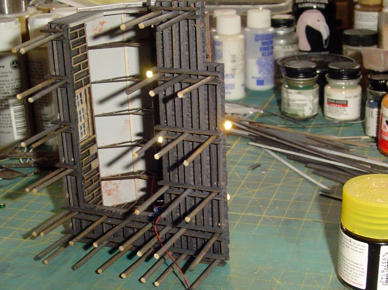

I installed lights on the interior and the exterior.  The first time I wired up the exterior Goose Neck lamps and tested them there was a little pop and two tiny puffs of smoke, one from each lamp.  Gosh darn it I said to myself.   ;)  When I looked closer I realized I had mistakenly wired the positive wire leading into the first LED to the wrong post on the current limiter I was using which effectively bypassed the current limiter and allowed 18 volts to run thru to 1.5 volt LED's.  That doesn't work.  So, I had to solder leads to another batch of LED's and replace the two exterior lights.  When I was finished I found that the exterior lights were WW (Warm White) LED's and the interior were CW (Cool White).  I tried to get a picture so you could see the difference.

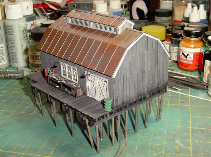

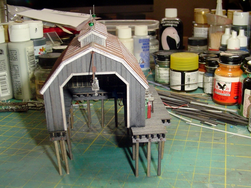

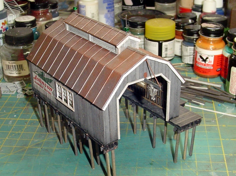

Now for the final shots of the finished structure.  The pilings are way too long on purpose.  When John places this on his layout he can cut them down using a rail nippers to get the height he needs.  I didn't try to apply darker tones to the bottom to represent the high-water mark or barnacles, slime, etc. because those effects really need to match the other structures in the harbor.
