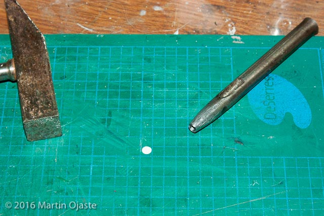

The wall braces are 16-18" in the prototype which translate to ~3/16" for the structure. Do you think I could find a 3/16" circle cutter or hole punch anywhere that was not priced at $40+US. I looked everywhere in hardware stores, craft stores, scrapbooking, jewelry tool suppliers, machine tool supplies. Yes, they wee some, but way beyond my budget. So plan "B".
I dug around in the junk stuff from my Dad's workshop and found a very old leather hole punch. However, it was a 1/8" punch, so I drilled it out to 3/16" and tried to sharpen it as much as I could.
I then proceeded to punch out 64 circles from 0.010" styrene. I found the cutting board as a backing provided the best cut circles.

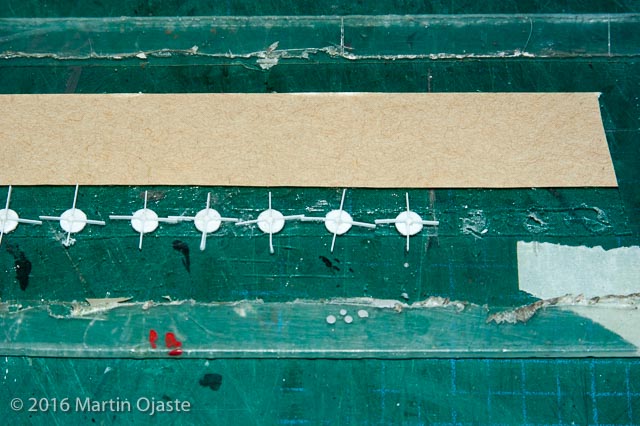

The prototype had some small details that I wanted to replicate. I found the needlely thingy was the best applicator for the small parts.
I cut rod slugs and welded them on first and then added a cross to the rod and circle. The excess strips were cut off at an angle to replicate the prototype wall braces.
I then added NBW to add more detail and dimension to the detail.
I made only 12 masters and then cast a silicon mold and then cast a whole bunch of copies.
The copies were then cleaned up and left to "cure" before I would move to the next step. But more on that in the next post.

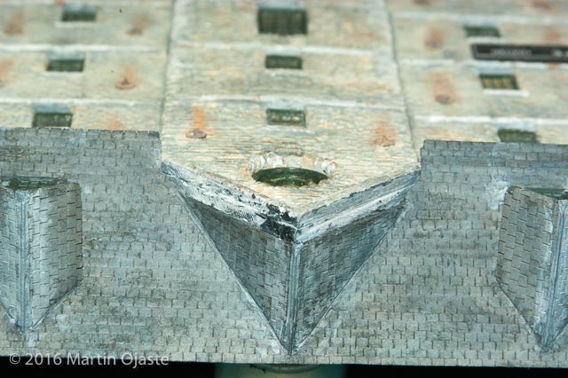

Next I attacked the tower wall caps. (Notice the roof slates have been dusted with a whitish/grey/sand chalk to show the lead leaching from the ridge caps.)

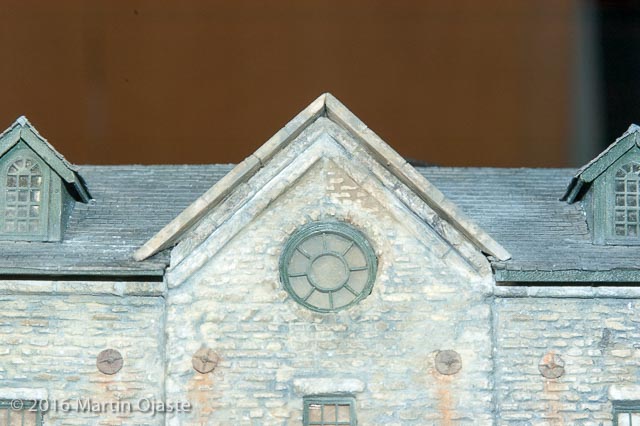

Earlier I had made for hydrocal blanks to be used for the tower peak. These were sanded down to the same thickness and width.
These were then cut/trimmed and fitted to the tower wall using epoxy to hold it all together.
Then I used the same chalks I used on the walls to blend in the tower wall caps. (Notice, the rust streaks from the wall braces are getting more realistic.

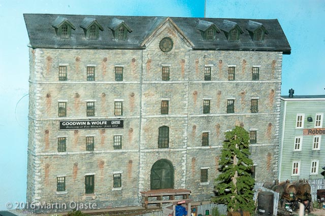

The walls all got a dusting of greyish chalks to tone down the fresh paint look on the windows, doors and dormers. When all is said and done the structure is pretty well done.
I now need to add a base to the bottom of the structure to hold the docks and porches in place because they all broke off with me handling the structure. With some details, etc the build will be finished soon.
