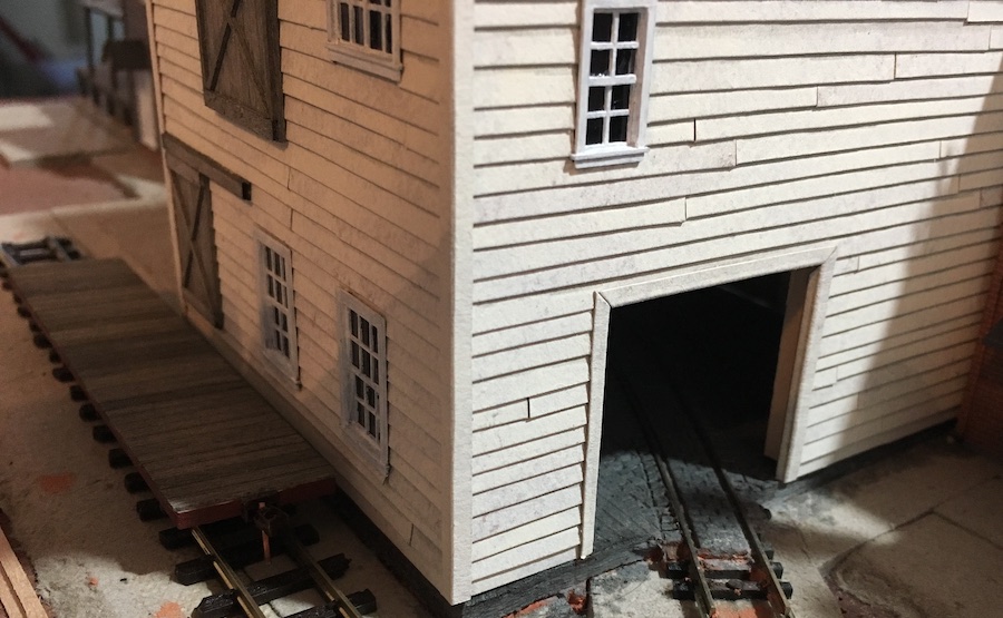

Its high time I made a door for the freight car entrance to the fish carcass handling building of the fertilizer factory.  I'm going to use some strip wood to build up the doors similarly to how I made the doors on the front of the building but I'm planning to devise a way to make them open and close.  I'm planning to have them slide in two parts left and right.
Here is a view of the opening to be covered.
Now if only I could remember how I colored the other doors...

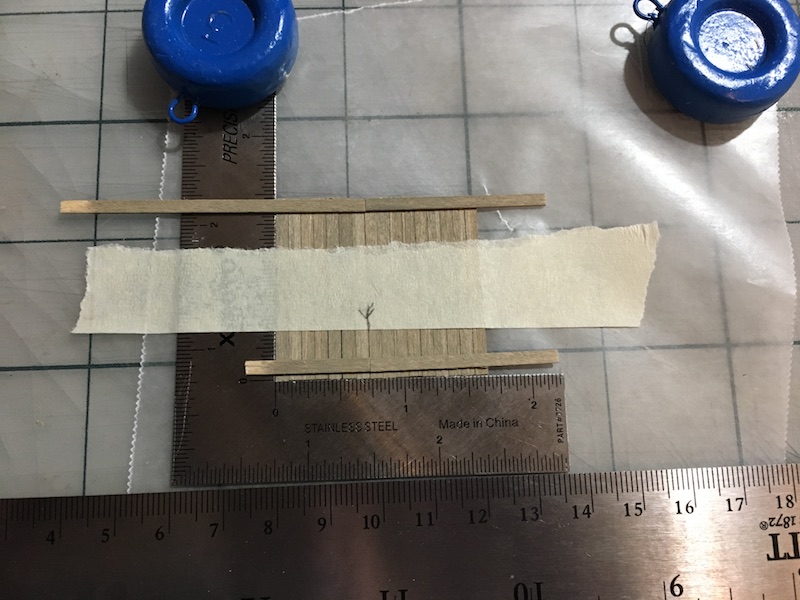

To build the doors I painted some strip wood and then used the chopper to make planks.

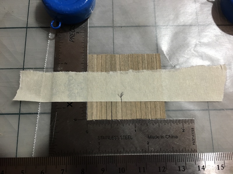

I then set the planks into a square and used some masking tape to hold them together.  The mark indicates the split between the left and right door.  (The left door is smaller because there is less space on the wall for it to open across.)
I then glued on horizontal planks to hold the doors together.   I left some room at the bottom so that I can roughen up the bottoms of the doors to show age.
I also added diagonal bracing but neglected to photograph.  Here are the doors under a heavy weight so that they dry flat.
And here are the finished doors.  The unpainted strip at the top is hopefully going to allow them to slide in a track.
