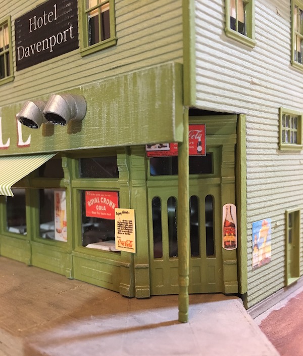

Since I have the signs out for the diner it made sense to turn my attention back to Leroy's this evening.
I made the black and white sings in Apple Pages and printed them on matte photo paper.  I thinned them by slitting the edge with an X-acto knife and pealing the layers apart.  With the photo paper this is not hard to do.
The resulting thin sign was coated on the back with thinned canopy clue and positioned on the wall.  I then added more thinned canopy glue to the surface and used a half inch wide, stiff, flat, china bristle brush to work the signs into the siding.  I used the same method for the advertising signs on the right end wall.
The signs in the windows were applied from behind the glazing.  The three signs around the angled entrance door were not thinned.
Cheers.

Random
I almost forgot to add the corner post.  This is made from a fancy toothpick.
Cheers!

Your signs are fantastic , and the splitting of the photo paper is definitely something I'm going to try.
vinceg
The fancy toothpick is brilliant, Roger. Looks great.
