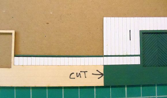

This next section was a bit tricksie. I mentioned I wanted this station to be about 45 HO scale feet in length. In order to make the station look symmetrical, I found it necessary to extend it to 51 HO scale feet.
What's 6 HO scale feet amoung friends, right?
The section shown below is of the back of the station and will face the isle and visitors. Where the cut line is shown on the left and to right end is 51 HO scale feet.

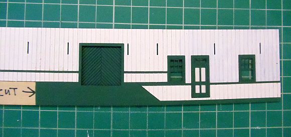

The entire wall section above is just pieced together for the purpose of showing you what I did to cut it down.
I first trimmed/cut off the upper portion of the wall.
I then cut the green trim and lower wall section off.
I then used a razor saw to cut the base off.
I then glued all the pieces together. The photo above is of the rear station wall with all the parts glued in place.
