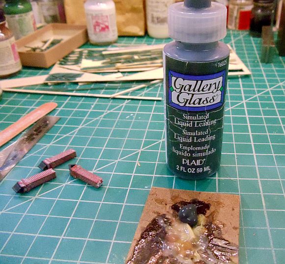

The tree chimneys were painted and ready to install.

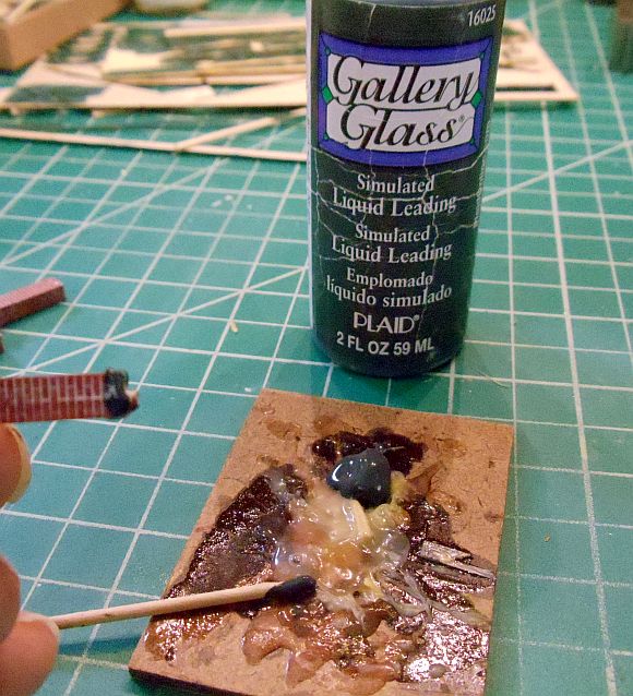

Reading Bob gave me a bottle of  Gallery glass Simulated Liquid Leading.

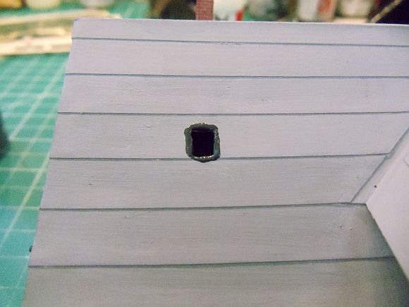

We use this to simulate the tar pitch around chimneys, pipes and other roof details.
I used a toothpick and applied some of the stuff to the bottom of the chimney and around the hole in the roof where the chimney will be placed.
I forgot to take photos of the chimney being inserted in the roof. You'll see them on the roof later in the thread.

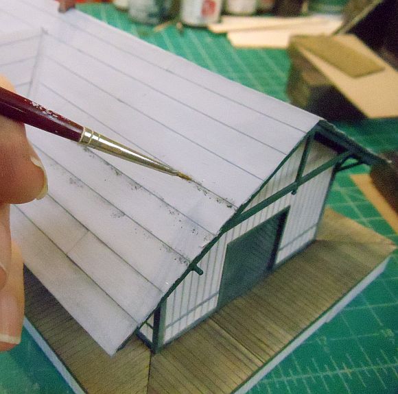

When the chimney pitch was dry I began the roof weathering process.
I used two different shades of gray from Pan Pastels.
I used a soft bristle brush and applied the grays to the roof and especially to the over lapped rolled roofing.
After doing two or three rows, I used a clean soft brush and brushed the pastel chalk horizontally along the roof.
Using a new foam pad and some beige pastel chalk, I applied the pastel to the roof and gently pulled it down from the top to the lower edge of the roof. The beige and grays blended very nicely.

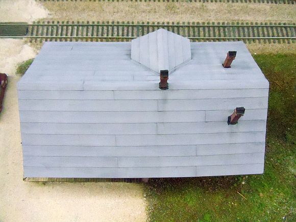

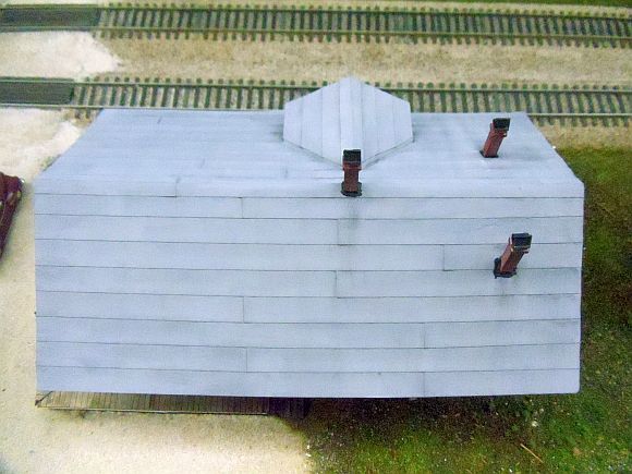

You can the tar pitch and the installed chimneys in the next few photos.
Excellent job applying the roofing. The weathering looks great and subtle.

Nice looking roof.  Did you seal the pastels with a fixative?
Wonderful job on the roof, the entire station looks well maintained, yet with just enough weathering to add interest.

Jeff,
Thank you. No, no sealant on the roof to fix the pastels. No one will be touching/handling it so no need.
