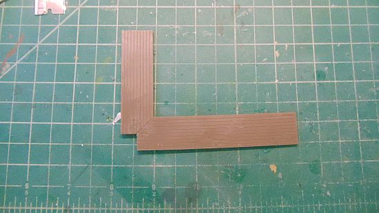

I did more work on the quonset hut building. The kit comes with a plastic deck that fits on the left front and left side.

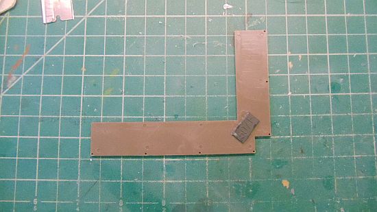

I glued the two pieces together and used a piece of scrap spruce to hold the bottom as the glue dried.

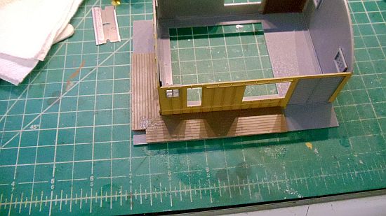

I did a test fit to make sure the two deck pieces were square to the structure.
It all fit nicely.

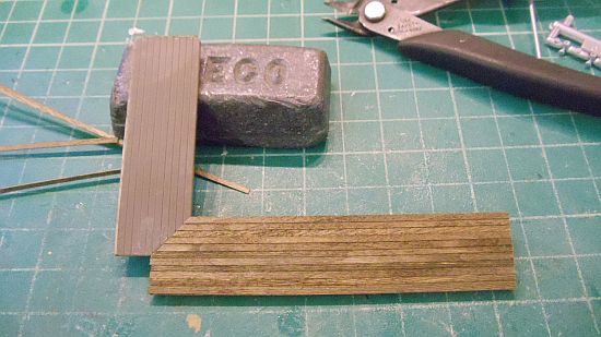

I then stained some HO scale strip wood and glued them to the plastic deck. I used scale 2x8's for front and side edges. I used scale 2x6's for the decking.

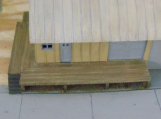

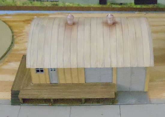

I used HO scale 6x6's for the support posts. I glued the support posts in place and then glued the deck sub structure in place. While that was drying I painted the quonset hut roof.
I used Floquil Polly Scale Aged White full strength on the roof. I then applied one coat of Hunterline A&I light gray to the roof. When dry, I used various shades of gray, beige, and burnt sienna Pan Pastels on the roof.
