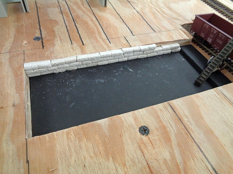

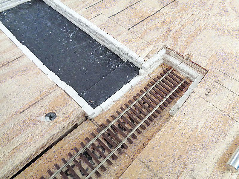

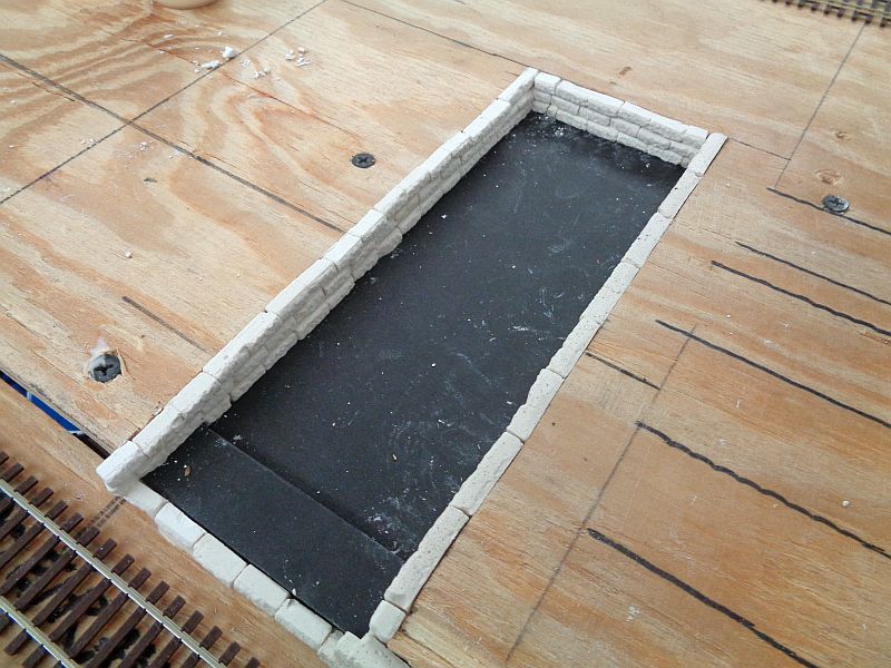

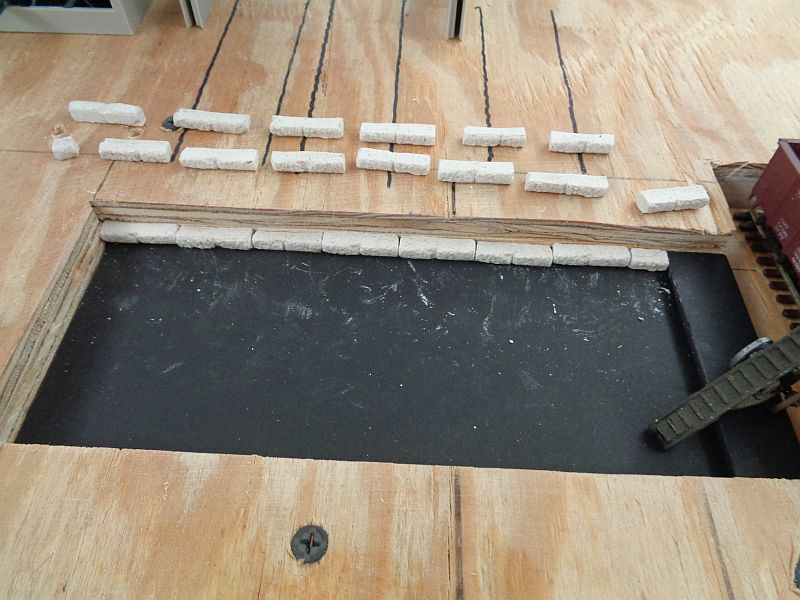

After drying, I removed the blocks and stacked a few against the wall for a look see.

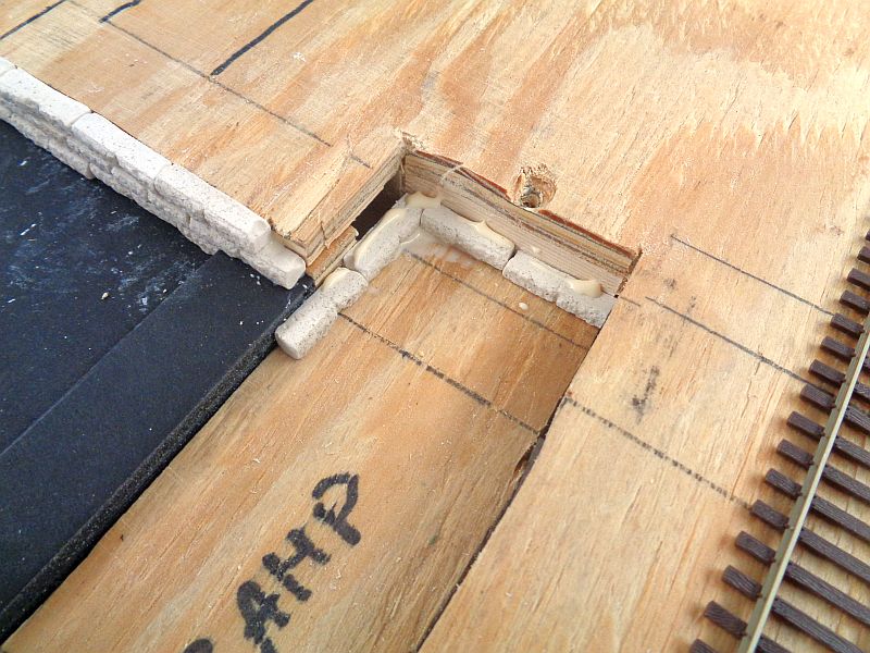

I then removed them in order, applied a bead of Elmer's glue to the bottom and worked my way up. I applied a bead of glue for each row.

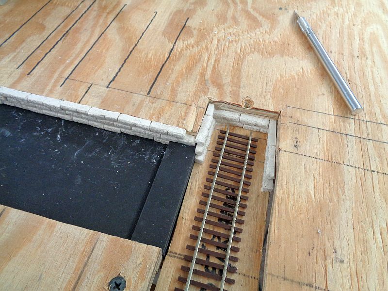

Gondola ramp area. I had to remove Greg's door stop first! ;D ;D
Diet Pepsi time, back in a few.

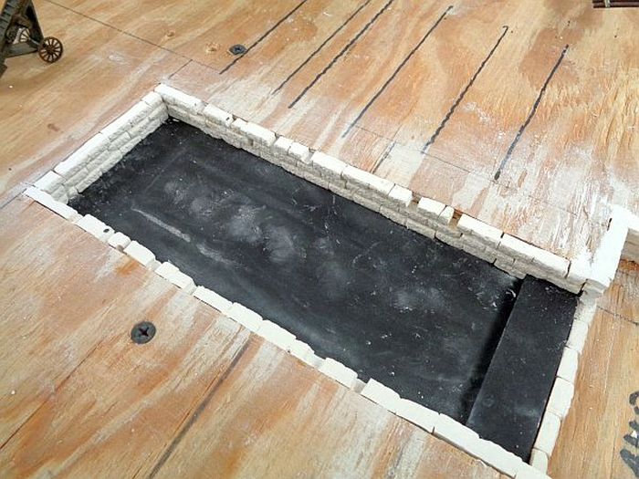

Main pit finished.
Waiting on more blocks to dry. This project will be finished tomorrow.

That gondola looks like a tight squeeze with the stone walls.  Better have a no clearance sign for the car riders.  :)
Dave K.
Really like the blocks in the gondola pit.👍🏻👍🏻
Quote from: Zephyrus52246 on June 28, 2018, 08:50:37 AM
Jeff,
Yes, tight squeeze and signs will be posted. Like John said, "It's the details that count."

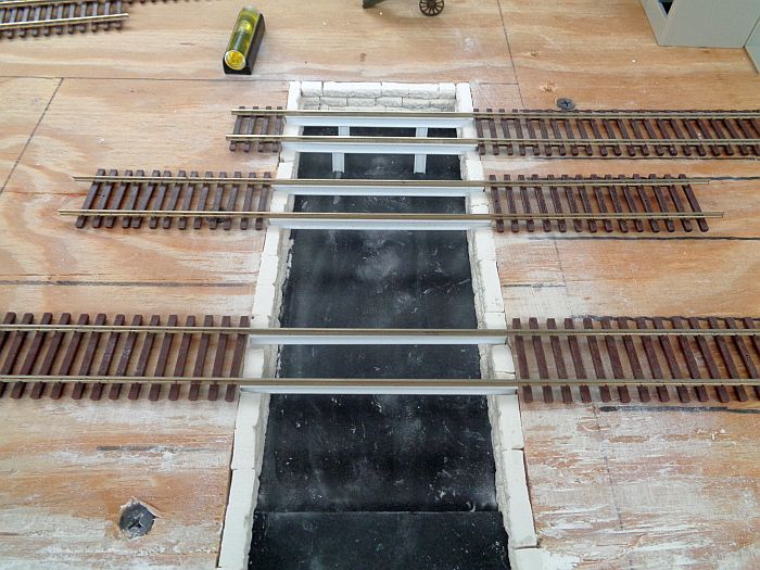

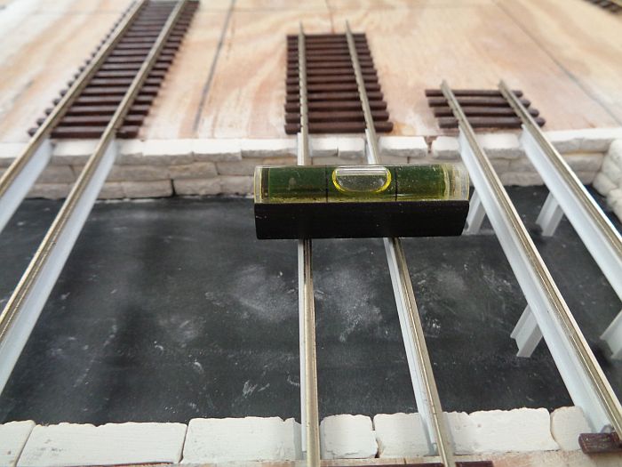

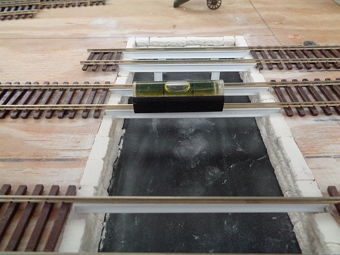

I'm using Evergreen Polystyrene I-beams for the track supports over the ash pit.
I cut slots in the blocks for the I-beams.
I removed 14 ties from the code 83 ME track and glued a section of I-beam to the bottom of the rail.
I then cut short pieces of I-beam and glued them under the track I-beam for the I-beam supports. The track was then placed in the pit for a test fit. Nothing glued at this time.
So far so good.
Of course the track MUST be level.
Diet Pepsi time, back later this afternoon.
