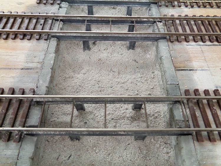

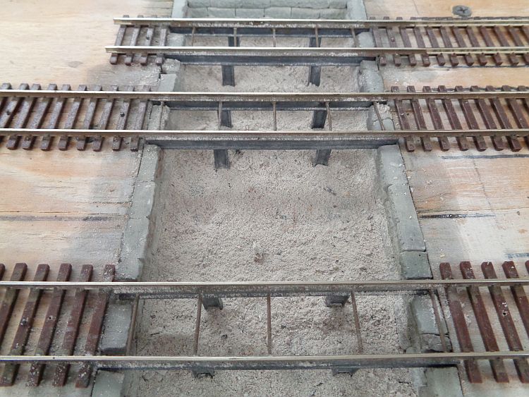

Quote from: jimmillho on June 28, 2018, 09:57:03 PM
Quote from: ReadingBob on June 28, 2018, 05:16:21 PM
Looks great but I have a question - You said you added brass wire between the rails as a rail stabilizer.  Are these electrically isolated or are the rails not hot?   :o
My thoughts also.......looks like a short circuit to me :o :o :o :o

Quote from: RWL on June 29, 2018, 09:17:13 AM
As usual in your journey, an impressive feature for the railroad. But, as others have pointed out, styrene rod might have been a better choice to keep the rails in gage.
Thanks for checking in and for the compliment, much appreciated. The issue of the brass on the rails will be addressed withing the hour.

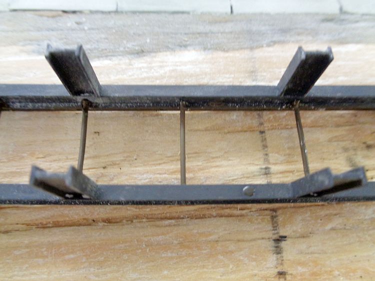

I hope ya'll gave me a little more credit in knowing I just can't place a brass rod between the rails. Then again, maybe not. :-\ :-\
I knew there would definitely be an electrical short if they were placed directly against the rails. I did experiment by painting two coats of paint on the rail and just lay the brass on the base rail, no solder, just ACC.
I then did a conductivity test and two of the tracks showed no short but the third one did. Rather than chance this happening once all was weathered and ballasted, I made the change then. I was going to post this change after the last posting but didn't get the chance. Then ya'll saw what I did with no explanation from me and got all freaky.
Here is what I did. I removed the brass wire and super glued them to the under side edge of the top portion of the plastic I-beam. No metal to metal contact as shown below.
The change is not really noticeable and now no worries about the movement of the brass or arching through the paint.
I'll have more updates tomorrow afternoon.
I don't think anyone is doubting your intelligence or your awesome modeling ability. I think it was a matter of the photo perspective that made it look wrong.

Just out of curiosity, why didn't you use styrene rod instead of brass rod?

Quote from: deemery on June 30, 2018, 05:39:20 PM
When I went to the local Hobby shop for the plastic rods, all the small sizes were out. The smallest ones they had were 1/8". I didn't want to wait a month for them to get more so I used the material on hand.
The brass ones almost worked. Well, 66 2/3 percent anyway.

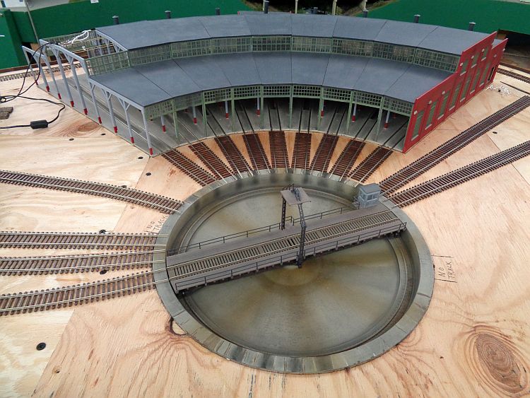

Last Friday I finished getting the track from the turntable to the roundhouse. I have more track to add to this area and will get to it later.
