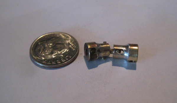

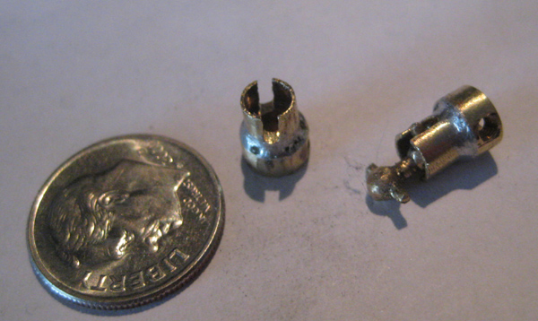

So I had the locomotive running around the tree for most of the morning and then it ran into some package that had fallen on the track.  The motor in the loco is strong enough to spin the wheels if it stalls against something.  The weak spot is......... or was.......... the cups that the constant velocity dog bone ran in might crack and fail.  I used NWSL cups as they were pre made and pretty quiet.
Well one failed yesterday so today I made metal ones with set screws.  It spins the tires now ! ! ! !
The only trade off is that it is a bit more noisy now.  I'm going to try and move the motor on its' adjusters and see if I can get a more quiet alignment.
