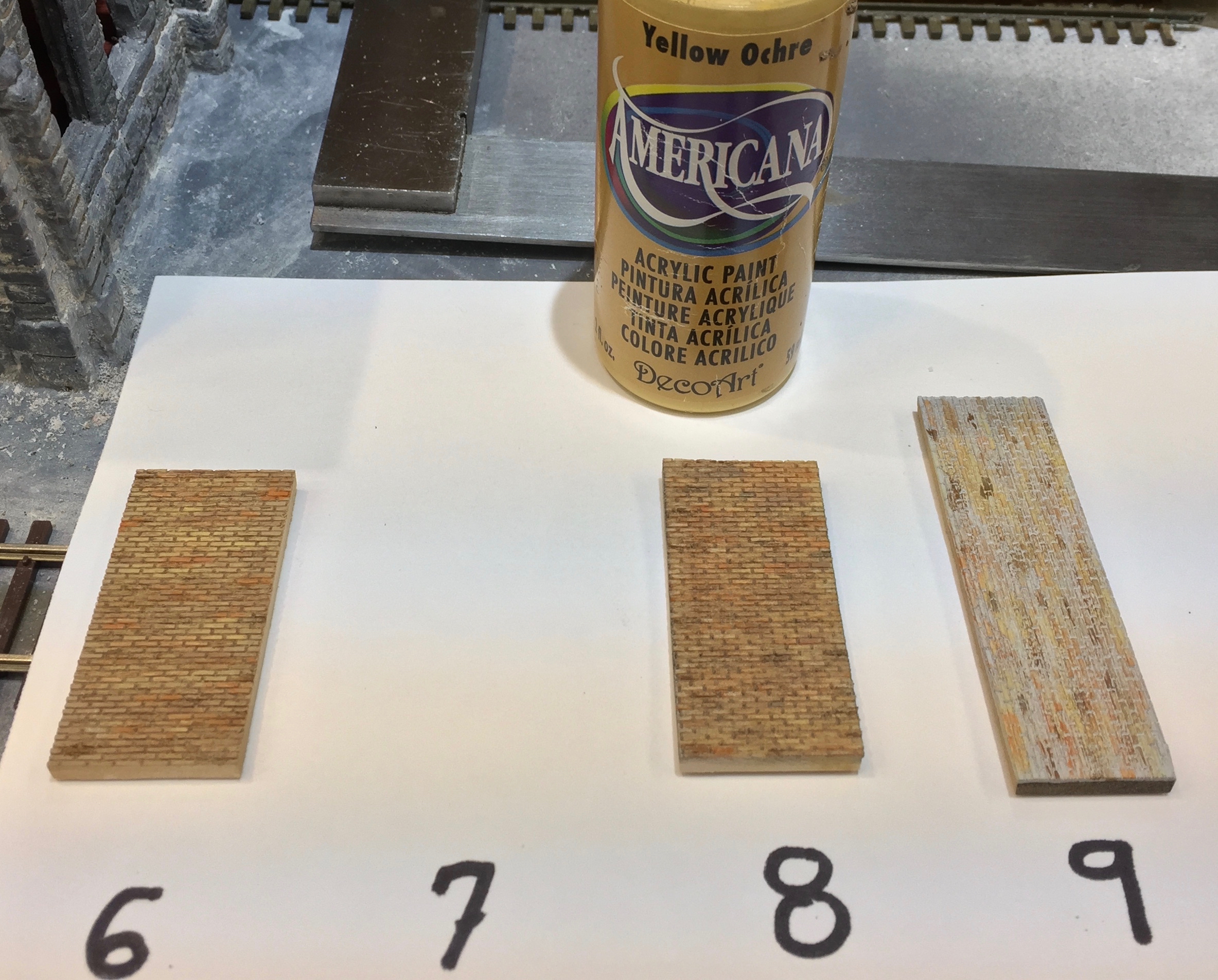

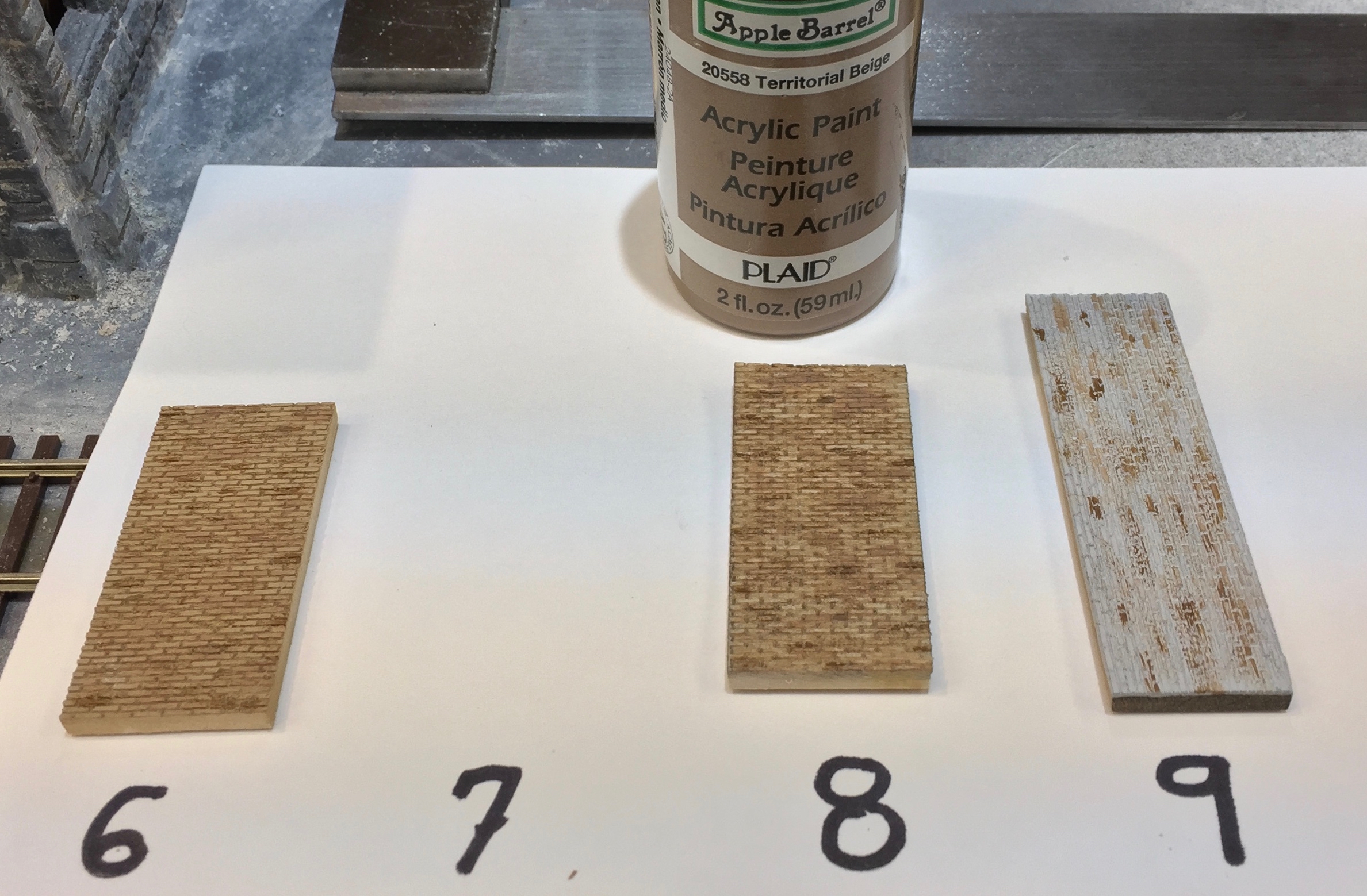

Then the whole sample was dry brushed with Sandstone. I added to much of the sandstone and let it dry before I went over it with a light grey wash.  Next time I would do individual bricks with the sandstone and just use the light grey as a final wash.
Here is a picture of the final sample board. I plan on using the number 8 technique on a future build with the Monster Model Works bricks.  For this build I will be using the technique represent by sample 7.

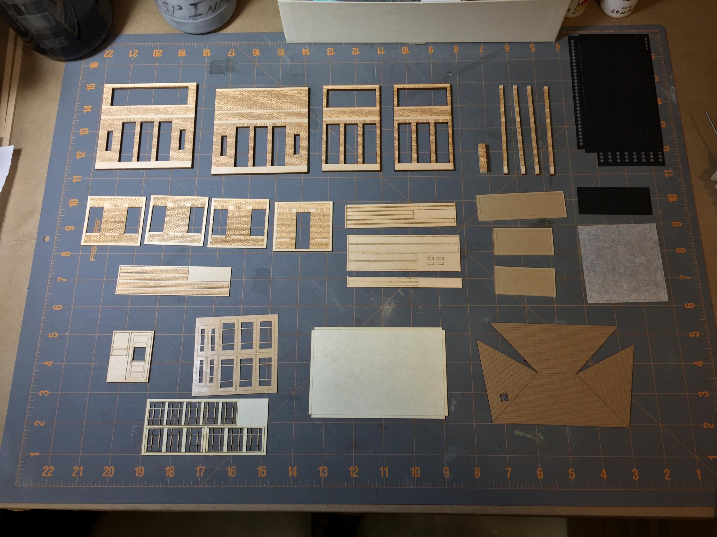

My first step was to lay out all the pieces that come in the kit and compare it to the pictures and list on page of the directions.
