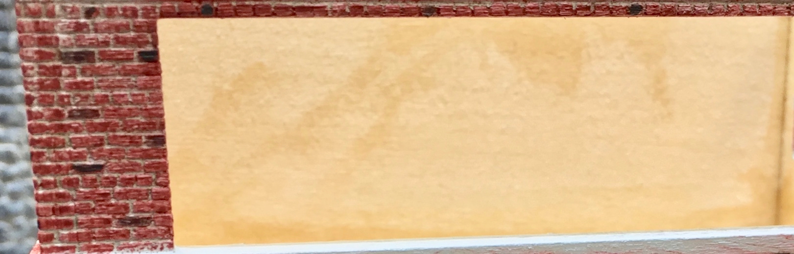

This is the front of the tower - the side the viewer is going to see when it is on my layout. It will look a lot better when the concrete and trim are painted.
Here is a closeup of the brick on the left upper corner of the structure. I went to a toothpick to paint the dark gray accent bricks.  I wasn't happy with the bleeding of the black on to the mortar when I used a brush on the back of the building. I know - it's HO scale and the viewer will be three feet from the structure when it's on the layout.  But I like it better - and it's my railroad.
I should add that I used three different shades of brick red.  I added a few drops of dark gray to the brick red paint for one, I used the brick red straight from the bottle for two, and I added some white for the third. The lighter shade allowed some of the mortar color to show through on the brick.

Thank you for following along and the kind words. IMO you have to get the level where it looks like individual bricks to make it look right. I really like working with the wood material for bricks and stone work. I still have some work to do to perfect the painting technique but I'm happy with the results on this build.

Thanks for the kind words. The bulk brick painting was done with three different shades of brick red acrylic paint.  The cheap stuff.  I applied it with a small rectangular sponge using just the edge.  The routine was dip the edge in the paint dab it on a piece of paper towel and then on the model.  I'm heading back into the train room and will take a picture of the sponge to post this evening. Please let me know if this makes since or if you have any questions. The key to this process is to get the paint on the surface of the brick and not down into the mortar line.  If you look close you can find a few places where I had too much paint on the sponge.  I think I found a way to fix those places - if it looks good after the paint dries I will post some pictures tonight.  On second thought, I will post pictures which ever way it goes. ;) ;D ;D ;D  It's the forum. :-[

I found this picture that I took while I was painting the tower that shows the sponges that I was using. When the sponge got to saturated with paint I would rip the corner off which created two new corners to work with.  I went through a couple sponges on this job. They come in a brick with about 20 of them per brick. I think I bought these from Micro-Mart based on the number on the package. The package is on the back of the workbench in this picture, next to my water glass that once again is to close to my brush wetting glass. You can see how I got the excess paint off the sponge on the paper towel. You can also see the three shade of paint that I was using in the palette. The paint is dabbed on with the sponge trying to only apply paint to the face of the brick.
