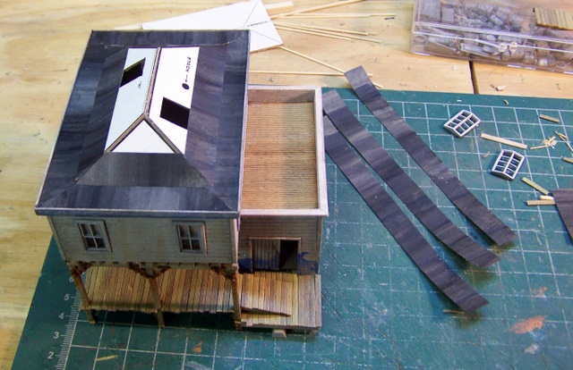

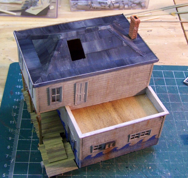

Moving on to the roof, which went together quite easily from cardstock forms, I added tarpaper roofing material. This was produced from the supplied piece of "newsprint," brushed with thinned weathered black and driftwood stain. The technique produced really nice tarpaper. You just brush on the paint in a consistent direction, dipping first in Dio-sol and alternating between the weathered black and driftwood without cleaning the brush. After the paper dried, it was cut across the brush strokes in half-inch strips and then layered on. I really like the effect, although I don't think my photos capture the character well.
Here is the completely papered roof with chimney in place. Skylight castings will fit into the holes and a tall "boiler pipe" will also be installed shortly.  I still need to add some pastel chalk weathering to the tarpaper, and touch up a few spots where unstained paper shows through.

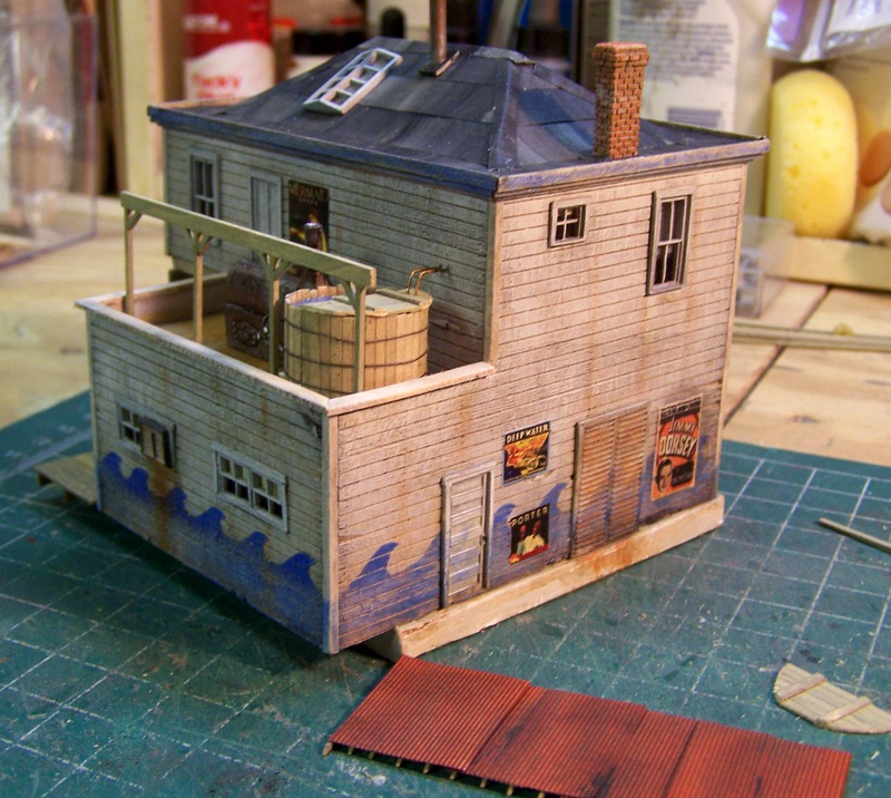

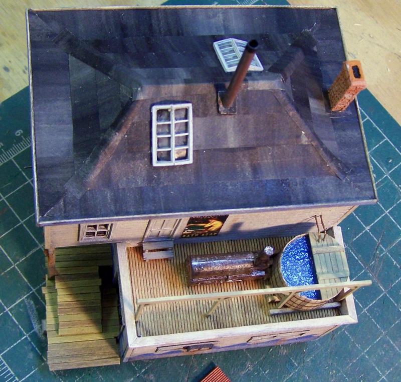

I added the roof skylights (metal castings) and the tall smoke pipe. Work on the cannery porch has taken up most of my time since. The canopy and supports were delicate work, as was the water holding tank. But following the detailed directions, all came out well. Since the porch details are easier to add before installing the canopy, that will be just about the last step. (in porch construction, not the build)
I found room for a poster! The cannery does not produce Mermaid Bath Soap, but the workers have developed an affection for the model in the poster. ::)
I scratchbuilt a two-piece cover for the wooden tank. It is modeled half-covered. The other half will be propped on the porch. My last step before attaching the canopy will be to add one or two figures, which are primed and currently drying before painting. In the overhead shot below, you can see how the tank and can sterilizer are arranged. The sterilizer will have an exhaust pipe extension that extends through the corrugated canopy roof.
All for now.
--George

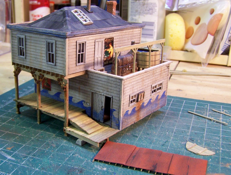

Today I attached the porch roof, which they identify as a canopy in the instructions. A few figures add some life. There is a worker on the porch and the guy with the necktie is, I am guessing, either an inspector or a boss. Let's hope its a boss and not the local health inspector.
Different view. Necktie guy is definitely a boss--leaning on that post "supervisin'."
A small roof was also added above a door on the other side, but the pic came out a little blurry so I'll show that off with more progress another day. I have guy wires to attach to the tall smokestack, a wall smoke jack, and a few more details to add. The largest feature of this structure, the concrete seawall below the porch side, will have to wait for inclusion until I am ready to locate it on the layout.
