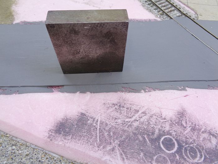

I must have dropped the #17 blade on the road as I see a tear in the carlboad. Apparently I did this after the first coat of asphalt was painted on.
I pealed up the cardboard and used a toothpick to apply a little white glue to the tear.
Continued -
I placed a weight over the patch and let it dry overnight.
This morning it looks better but still shows. I'll either cover the area with a vehicle of use the spot as a pothole being repaired.
