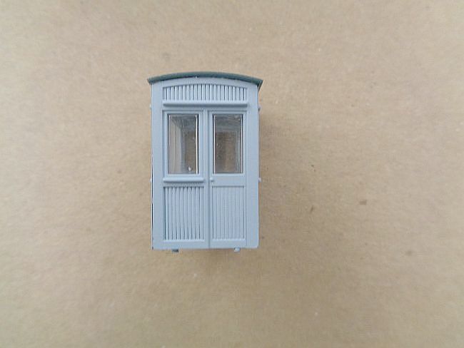

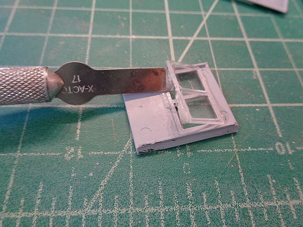

My first surgery on the turntable bridge was to remove the operators hut.
It was glued to the bridge deck via four small plastic nubs. I used a #17 Xacto blade and sliced the four nubs to remove the hut.
My plan was to use the hut as a model to scratch build a new one out of scale lumber.
I used a new #11 blade and cut around the top of the walls. I then used the #17 blade to pry the roof up and off.
I need to load and crop more photos so I'll be back in a few minutes. I may as well grab a cold Diet Pepsi.

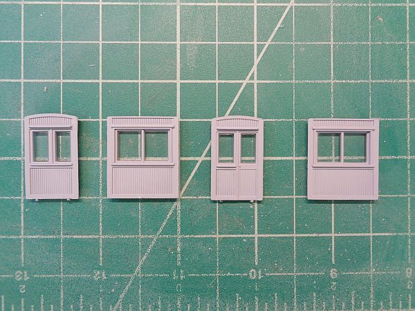

Getting the for walls apart was much easier than I thought. All I did was apply a little pressure to pull them apart. Very little Chinese glue was used the hold the hut walls together. ;D ;D ;D
I also needed to get the window glsss out so I could trace the window opening.
I used a #11 blade and traced around the window to cut through the glue.
I used a #17 blade to "pop" out the window glass/plastic.
I only needed to remove the glass from one side and one end wall.

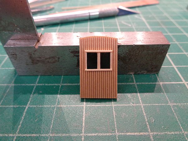

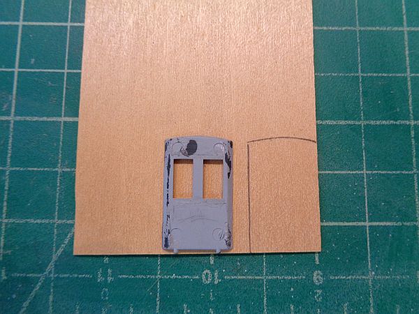

I made two side walls using the plastic wall as a template. I'm only showing one.
I then repeated the process using the end wall.
All four walls cut and ready for detailing.

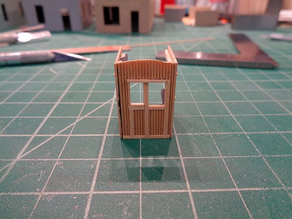

Next, was the gluing of the four walls.
The hut door is on the right.

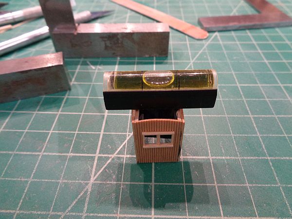

All  four walls fit and glued together as planned, er as cut.
Prior to adding any corner trim, I made sure the walls were square and secure while the glue set and dried - overnight.
