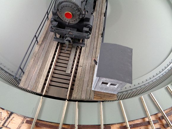

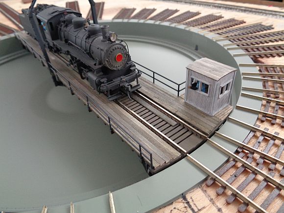

I forgot to mention how I weathered the planking after it was glued to the deck.
I used the back side of an Emory board and sanded the tops making it look a little more weathered.

That's quite a dramatic difference between the before and after pictures of the stuff you've done so far on the turn table.   :o  :o  :o   Well worth the effort!

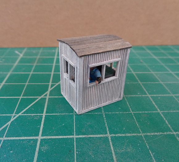

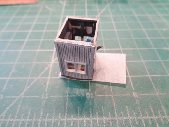

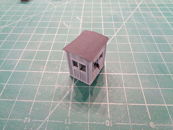

I added a turntable operator and glass to the hut. I used clear acetate for the window glass. The operator is a Preiser Engineer.
I also wanted to have the roof curve like the plastic one. I used scale 2 x 10's and glued them to the top.

Thank you and yes, it was well worth the effort. It changes the entire look of the Walthers turntable for sure. ;D ;D

The roof on the hut doesn't look bad as is but I guess it would leak like a sieve. 8) 8)

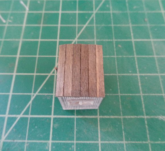

Time to cover the roof on the hut.
I used an Emory board and sanded the roof to the curve of the end walls. I only sanded perpendicular to the boards.
I've been wanting to try a new technique of adding roofing for the past 20+ years. This is such a small project so if I messed up I could simply pull of the 2 X 10's and start over.
I took a piece of tissue paper, not Kleenex, but gift tissue paper and cut it to the roof size.
I then painted some Floquil  Grimy Black to the two boards on the right. I then placed the tissue over the wet paint. I did this two boards at a time and let the tissue paper fall into place.
As you can see the paint soaks through the tissue paper.
I did have to touch up a couple of places. Here is how it turned out.

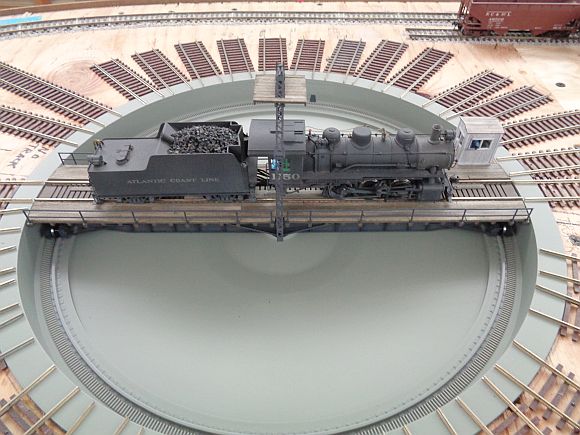

I still need to weather the sides of the turntable with some rust.

For the glue, I applied Elmer's Carpenter Wood Glue with a tooth pick to the underside of the plank and carefully laid it over the plastic. I staggered the planks to give it a more weathered pattern.

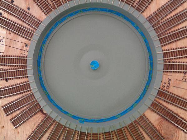

Today I painted the turntable pit.
First, I used painter's tape to cover the ring rail and bottom gear teeth.
I then trimmed the tape for painting the pit area.
I taped off the track as shown.
I cut several small pieces of Christmas wrap paper.
