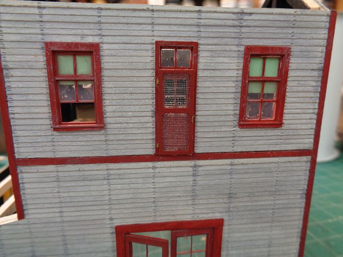

I reopened the nail holes and using a 4-0 (0000) brush, applied a very little amount of Hunterline Light Gray A&I to the nail holes.
The doors and windows were glued in place at this time as well.
I did a good job of lining up the nail holes in the front but not so good on the sides.
Roof and wall signs and other details will help cover this mistake.
You may have noticed the screen door on the second story. This is one of KC Workshops's screen doors.
I didn't use KC's screen material as I have some I like much better. It is very fine silver ribbon purchased from Joan's Fabrics.

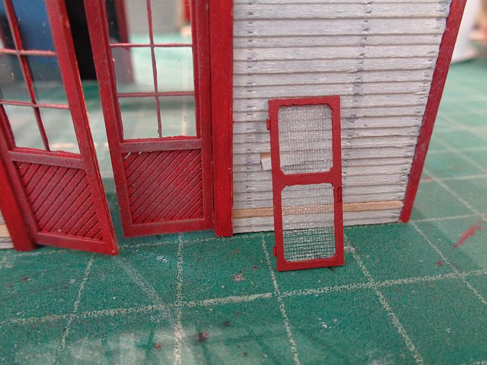

I painted the door to match the trim color and when dry, glued a piece of screen material to the back of the door.
When the glued dried, I used a new #11 blade to trim the screen material from around the edges of the door.
I painted the door hinges and handle with Floquil Brass. The door was then glued to the door frame as shown.

On a few random boards on the front, I removed some of the clapboards and replaced them with HO scale 1X4s.
I used a new #11 blade, cut a vertical cut in the clapboard and then using the side of the blade cut under the clapboard.
I then cut a horizontal line on the top of the board. Now it can be removed. A new 1X4 was cut and glued in place where the one was removed.

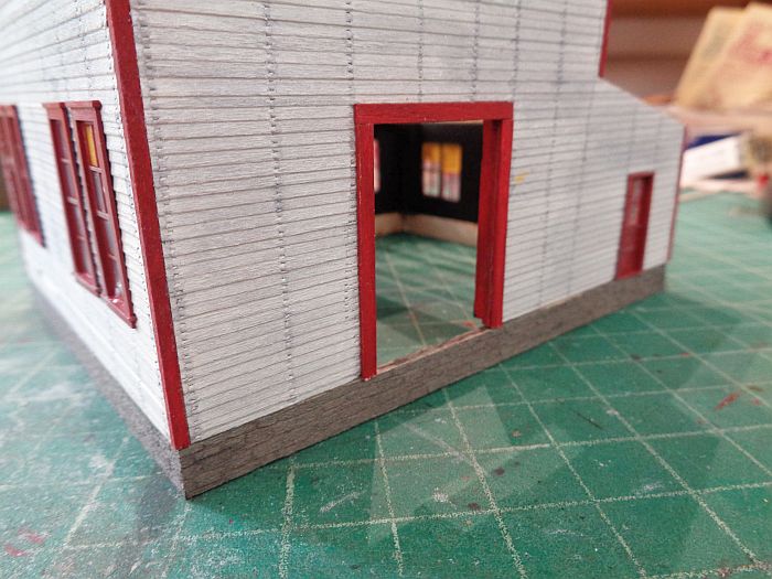

I decided to use KC's Workshop stone foundation. I measured the walls and used a single edged razor blade to cut A 90 degree angle at each corner. The material was very easily cut with the razor blade.
You can also see the stone foundation in the above photo as well as the ones below.
