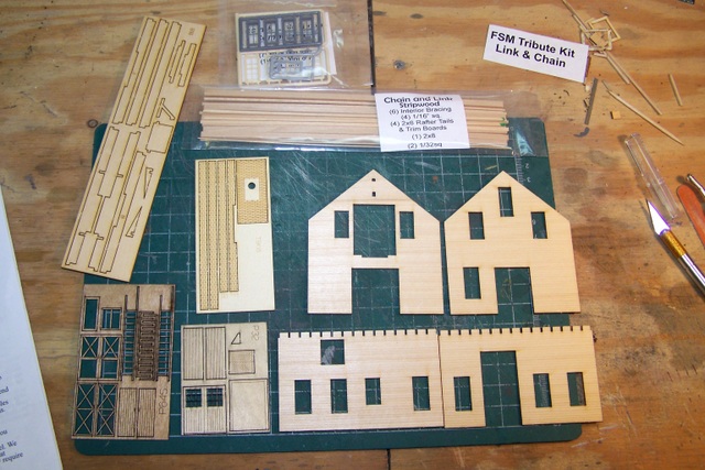

Below are the major wall parts laid out. Just out of the picture is the die-cut cardboard roof and detail pieces. This is a "before" picture. I then began adding texture and wood/siding detail with various implements. I'll bypass an "after" picture because those details won't photograph well, plus, I am not done. I am thinking this building will be even more beat up than the first, and am ruminating on additional stressing of the walls.

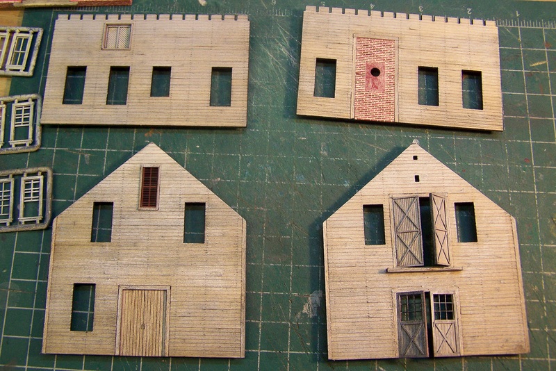

Anyway--I did get the walls painted to match the first building. I want all three structures to look like they were built about the same time, and more importantly have suffered a neglect of paint for a similar time. Below are the painted walls, with a few of the die-cut wooden freight doors assembled but not yet installed. The wooden doors will undergo some light weathering and an alcohol and ink wash, then dry-brushed white to match the walls.
To the upper left is the brick foundation. I'm not entirely satisfied with the color yet. It is etched taskboard, and this is one of my first experiences working with the material. It doesn't take color in the same way as wood, and my usual brick color: a Rustoleum rattle can of "Paprika" looks too orange. On wood and metal it looks like old, sun-bleached brick. On taskboard it just looks orange, even after a wash of off-white for mortor. I will experiment with dry-brushing a darker shade of red over the face of the bricks.
I continue to dry-fit pieces together, and can report that everything fits nicely.  A well-designed kit so far.

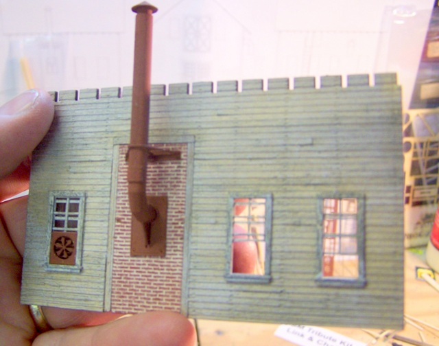

Below are the fabrication shop ("Link & Chain" in the kit) walls with paint and some of the freight doors, vents, and etc installed. I'm finally happy with the color of the brickwork. You can see the brick wall that embeds in the wooden wall as a firesafe surrounding the boiler pipe exhaust. No windows installed yet. I sprayed the back sides of the walls with black primer and am waiting for it to fully dry.
I took a picture of the recolored taskboard brick foundation, but it was a little blurry. You can see the edge of it in the upper left. It too, came out ok. Next up will be adding windows, glazing, and some other wall details while still flat.

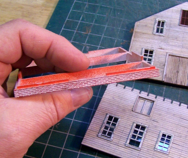

Here is a shot of the brick foundation that gave me color trouble. I am satisfied with the base color now. Still need to dirty it up. You can see the original orange color on the internal bracing and alignment tabs, with which I was so unhappy.

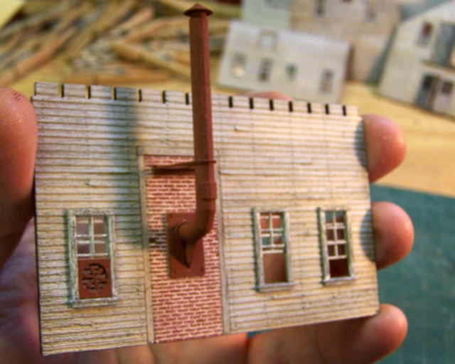

The furnace wall is described in the instructions as the "coolest part of the kit," and I agree, at least so far. Jack Ellis designed it and it is full of character, even in this early stage. Lots of weathering and fine detailing to add yet, but you get the idea. Two shots below:
On this angle I increased the fill light to show more detail, and that threw off the color. The first angle shows a truer color.
Taking a tip from multiple other users, I did not rely on the peel-and-stick feature of these components, but used wood glue and cyanoacrylate.
