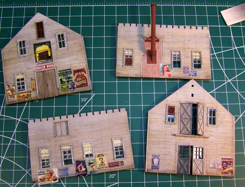

Opa George
Thanks, Lynn!  The past few days I only got a few minutes work in at a time. This evening I managed to get the walls almost finished with initial detailing. I want to fashion some freight door handles from thin wire yet, which are best installed while laying flat. Other more fragile details, like light fixtures, will wait until the structure is assembled and mostly done.

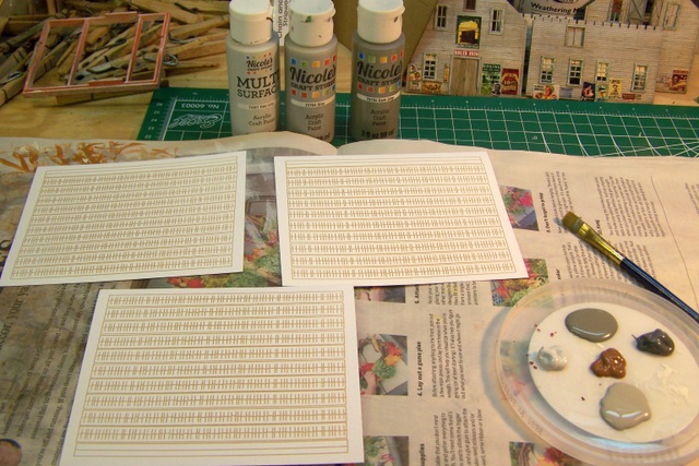

Next up are the shingles for coloring. Below are the peel-and-stick shingles with four shades of acrylic gray and one basic brown. I think any shades of gray will work as long as you have a variety from light to dark. For the record, I used Nicole's pale gray, gray, dark gray, slate gray, and brown.

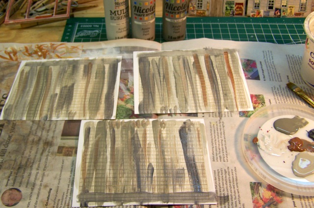

Random streaks of paint thinned with water give the effect below. It will need to dry completely before I start applying strips. Per the instructions, I will not remove the shingle strips consecutively from the holding sheets, but take them randomly from the three sheets to avoid a stripe effect.  But that will be tomorrow evening.

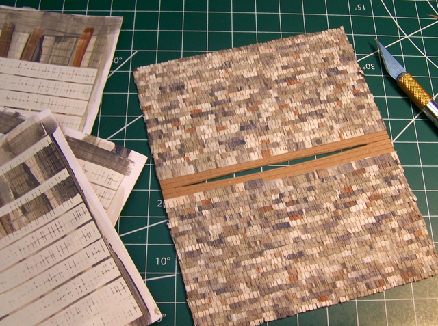

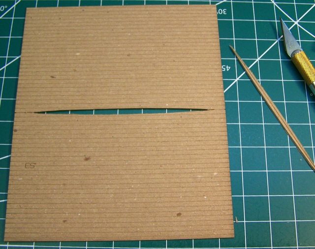

Lynn, Vince and Jerry--here we go. Below is the cardstock roof with the "sag" inset removed. Bar Mills offered the option of sag or no sag. I opted for the sagging roof, so cut out the marked portion.
Artie's instructions suggested shingling the roof before installing, except for the last three or so rows around the removed portion, gluing in place, then finishing the final few rows.  I used the random strip technique, and enough is shingled to give a good idea of how it has turned out. Keep in mind, it has no weathering yet to blend it in.  My opinion is that this is an effective coloring technique and I like the final result. I will leave everyone else to weigh in on whether it strikes your eyes as effective or not.

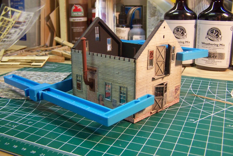

I haven't installed the roof yet--need to have the building shell together first. Below the four walls glued and clamped and just sitting on the foundation.  Once dry and I'm satisfied with the seams, I'll glue tight to the brick foundation and finish off the roof.

I'm not sure I like the roof as it is now, but as you stated earlier it still needs weathering and since you went with the sagging roof it will probably be weathered heavily and I think It will look great with the colors subdued. I look forward to seeing what you do George.
Quote from: PRR Modeler on December 11, 2018, 07:54:45 PM
Right now it looks like it was shingled with all the leftover shingles the roofer had on is truck. 8) 8)
