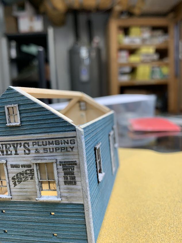

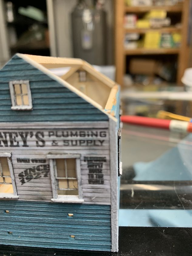

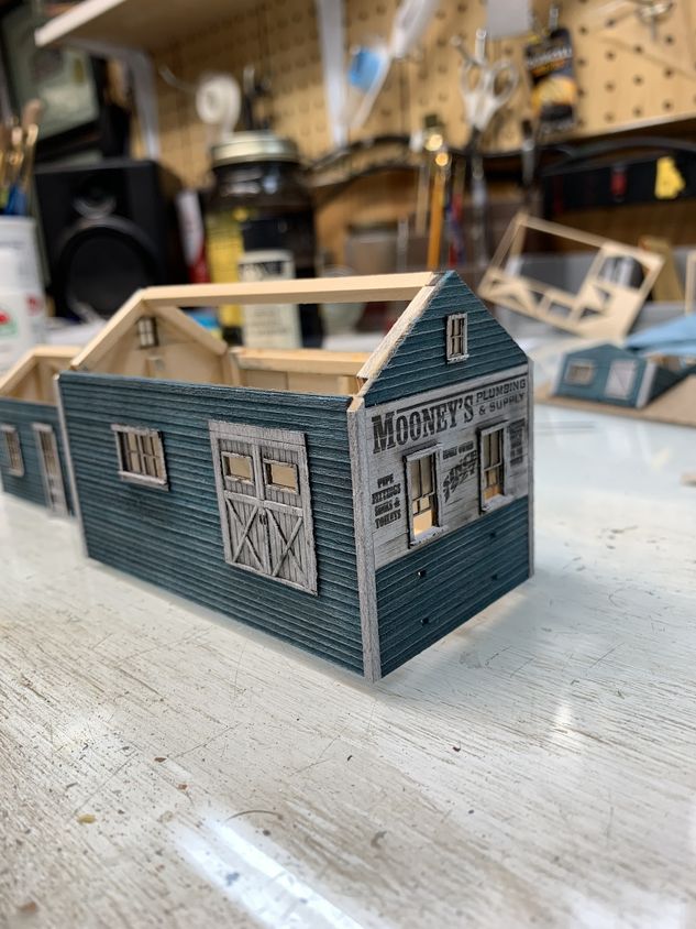

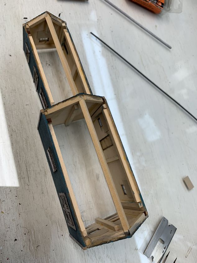

I glued the walls together and weathered the sign a little more using chalks.
This is the bracing I added.

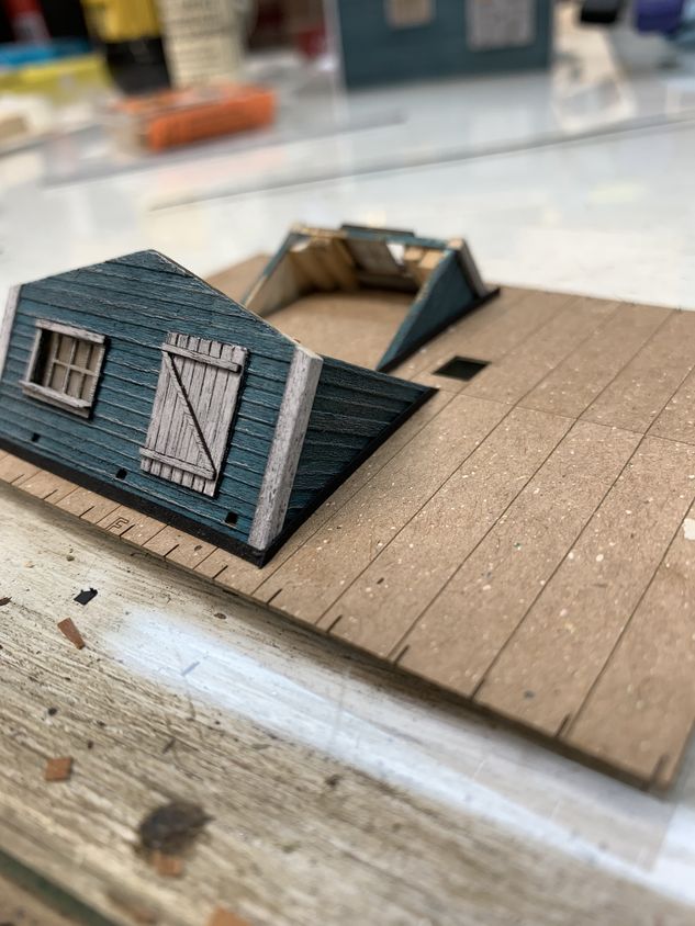

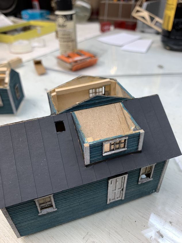

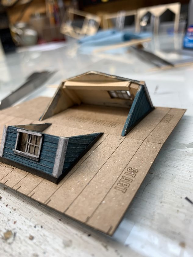

I prefer to add the roofing with the roof glued down. I glued the dormers on the roof card at this point. I was not real happy with the gap between the dormer and the roof.
In the past I'd use some white glue darkened with black paint to make tar and fill this area but it always comes out sloppy especially if I'm filling in a large gap. Lately I've been using construction paper to make flashing. In reality the flashing is bent at a 90 degree angle with half under the roofing and half over the siding. I only model the part that comes up on the siding.
I trim it in place once it dries with a sharp razor.
The rear dormer had a really nasty gap due to an error I made cutting the corner trim.
I used the same technique to cover up the gap. I also weathered the flashing with some brown chalks. The flashing is a little bigger here to cover it but once the roofing material is on it should blend in nicely.

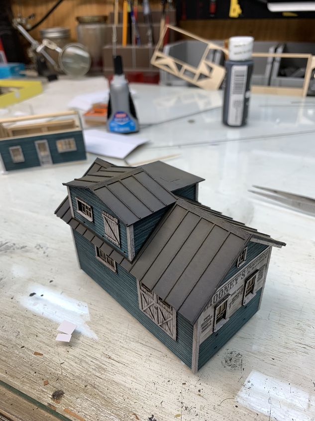

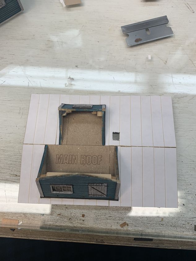

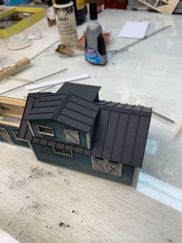

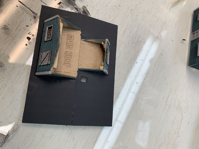

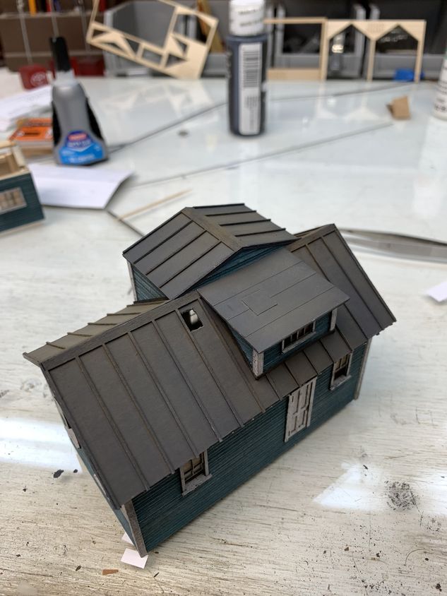

I made a little progress today on the roof. The roof consists of peel and stick paper strips similar to a stick on label from Staples.
The peel and stick is very fast to apply. Even with the cuts around the dormers it only took me a few minutes to do the whole roof.
I colored the roofing with Apple Barrel 21490E Pavement. It's very similar to Grimy Black or Weathered Black Floquil.

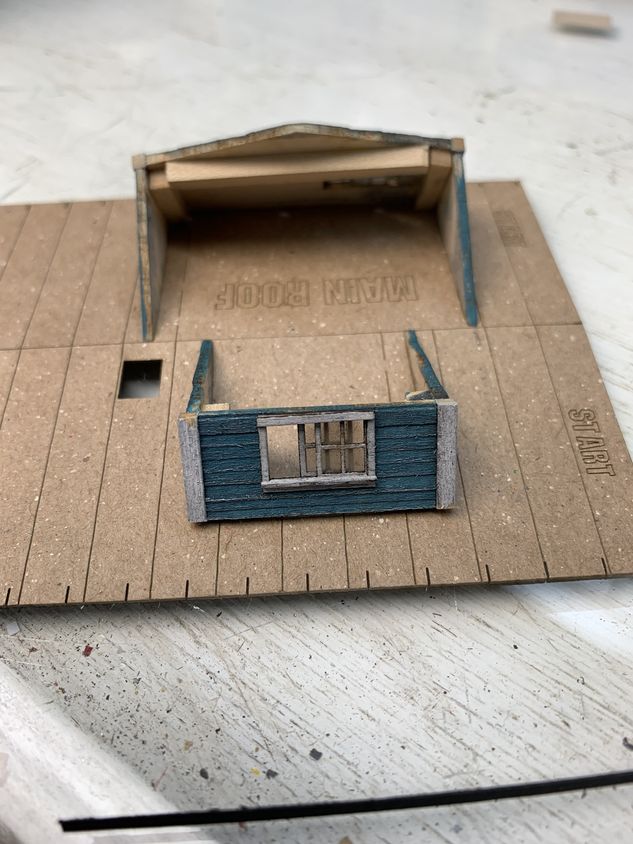

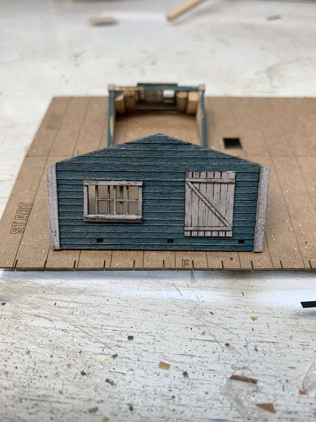

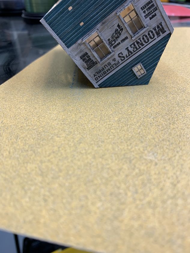

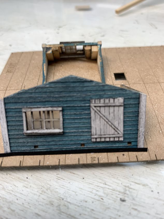

Before I installed the roofing I needed to bevel the edges of the front and rear walls to match the peaked profile. Everyone has a technique for doing this and it's pretty standard on craftsman kits but I figured I'd show how I do it.
I've used a sanding block in the past but I prefer a piece of 120 grit laid flat on my glass workbench.
Pretty basic stuff but if the roof doesn't sit flat it will ruin any model. This and tight corner joints make or break a model in my opinion.
I had to sand it a little bit more but it looks good to me here
I added this little clapboard triangle section to the end of the front dormer. The peaked dormer roof actually comes over the top of the main roof.

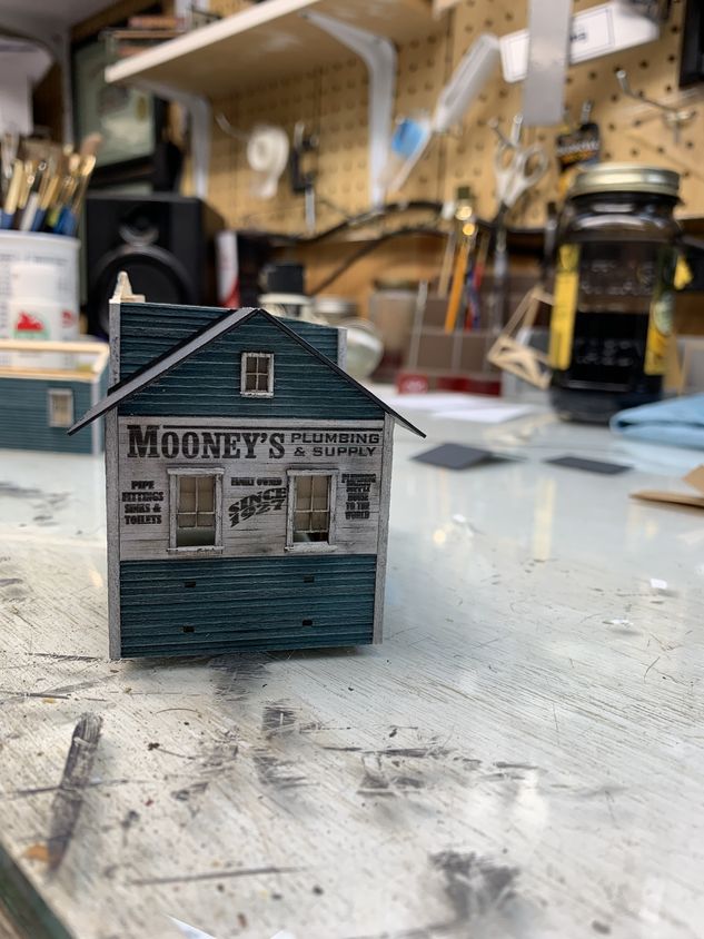

Lynn, I sanded the back of the sign to make it a little thinner, cut along along with the clapboard once it was in place then I used my fingernail in press it into the clapboards.
I made a little more progress over the weekend. Lots of Christmas stuff coming up with the kids so I didn't have a ton of time.

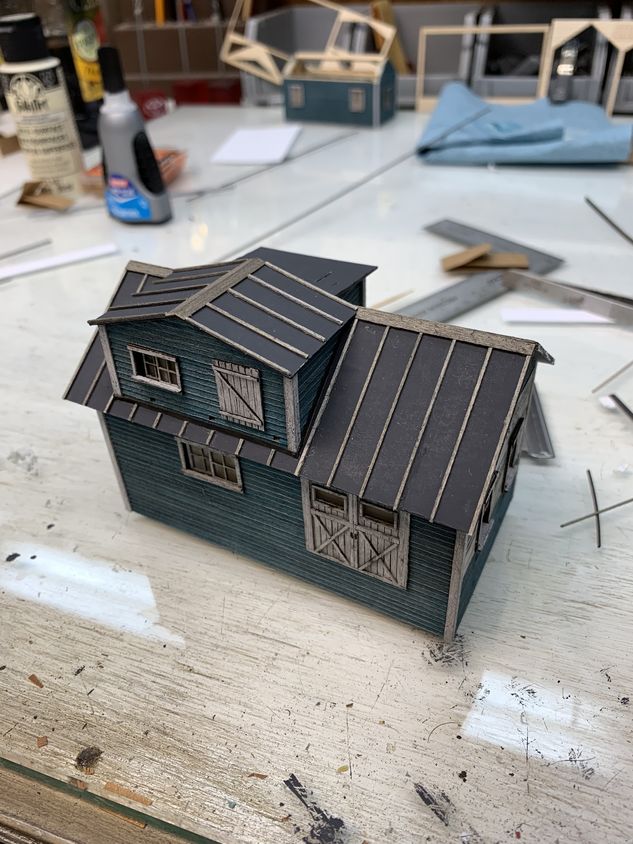

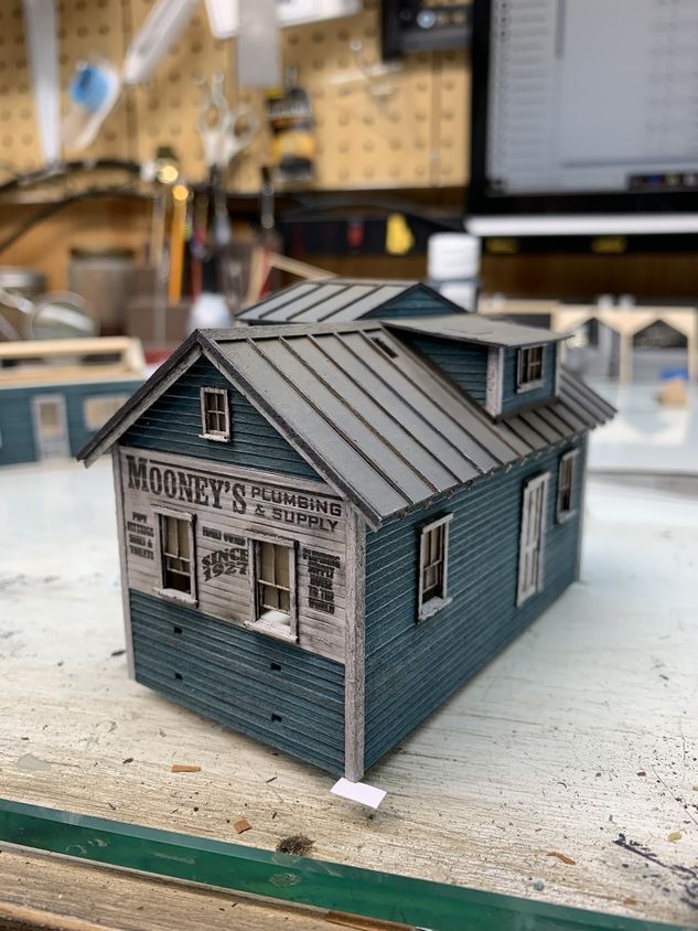

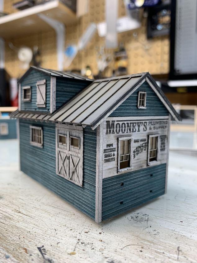

I wanted to do something different with the roof. I used some scale 2x2s to cover up the seams. I wasn't really happy with the unfinished wood look.
I decided to paint all the wood on the roof to match. I think the unfinished wood looks good on a shed or some type of barn structure but it looks unfinished with all the blue and white coloring.
I painted and added on all the rafter tails. These are laser cut and I colored them the same as the windows. 1 coat of A&I, white paint dabbed on with a stiff straight brush followed by another A&I wash. All of the coloring was done prior to removing them from the laser cut sheet.
I dusted the roof with some dark brown chalk. I'll add some more weathering later once I add the chimneys and the water tank.
