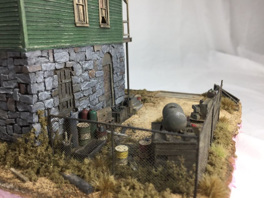

Here are a few pictures of some chain link fencing I've done on my models.

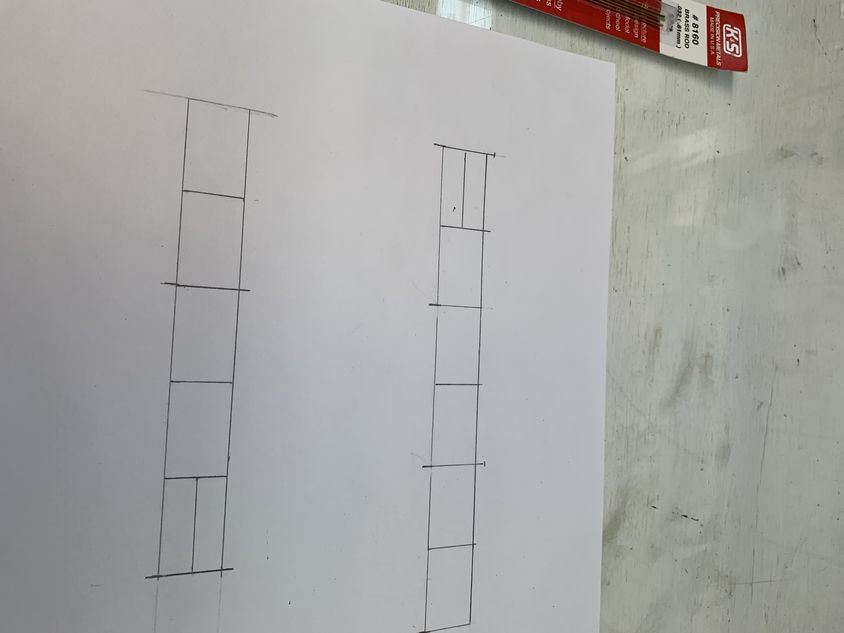

I drew out a basic drawing for how I want to fence. These are spaced 6 ft apart and are 5 space ft high.
I liked the crossbar support detail on the SierraWest fence so I used that here as well.

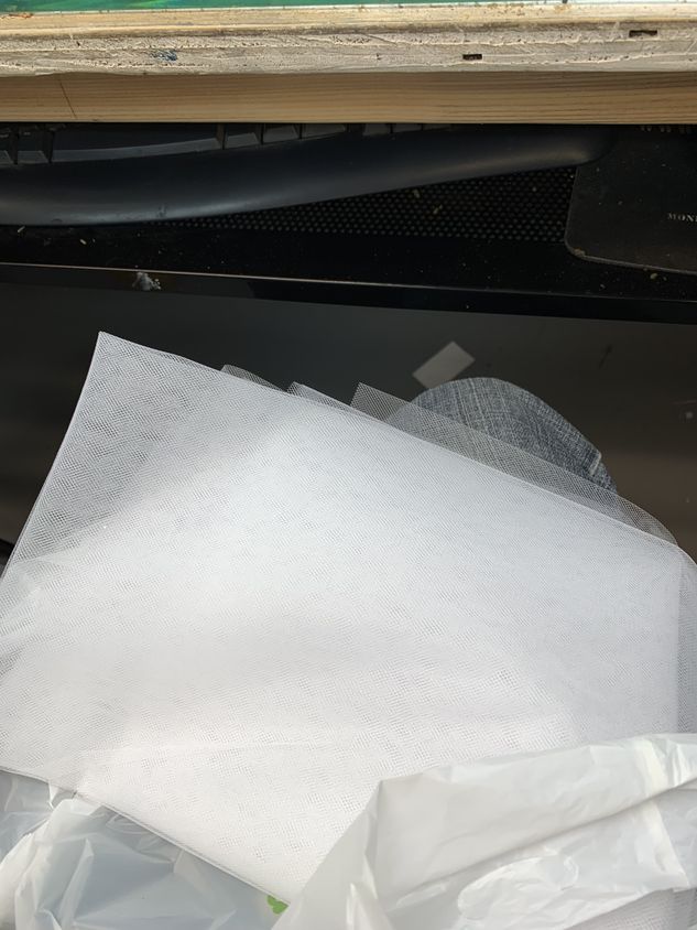

The chain link is made from a material called Tulle. If you buy it on a roll the holes are too big. You need to buy it by the yard. I got mine from Joann Fabrics. It was $.79 per yard. The SKU number is 717371410313. 1 yard is enough to do several layouts worth of chain link.
I cut a few sections of material much bigger than the fence I'm making and taped them to a piece of paper.

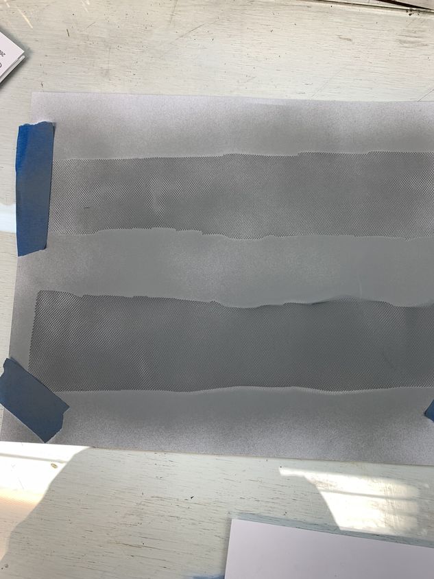

I painted the material with a light coat of gray primer. The paint gives the material a little more strength and stability so it's a necessary step.

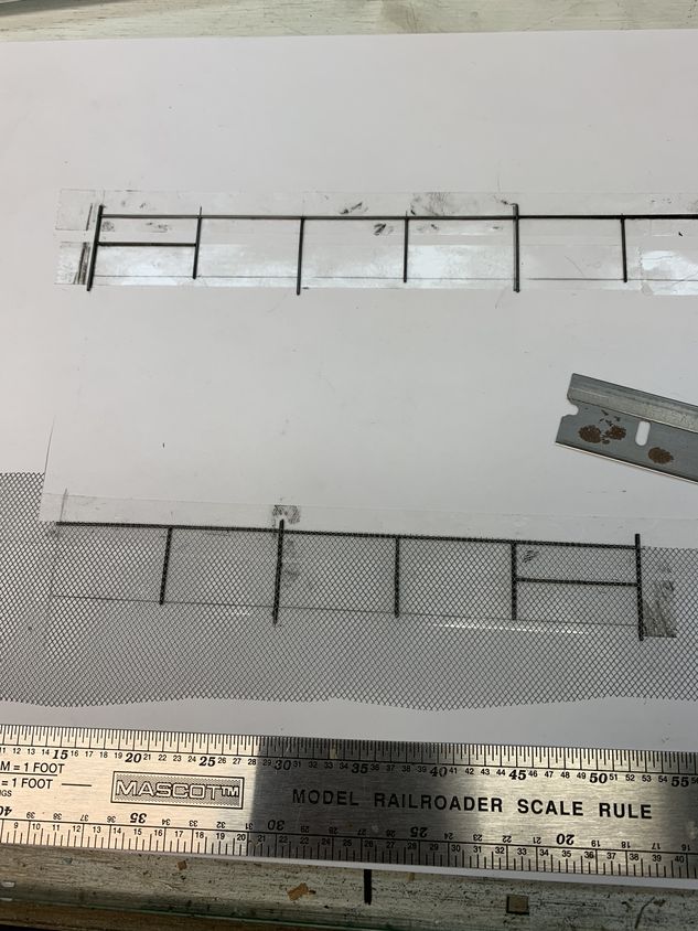

Double sided tape on the template.
I stuck all the pieces in where I wanted them on the tape. I also super-glued any of the sections that touched together.
I glued the tulle to the fence just like this. I will trim it up next.
Using a ruler as a guide I cut along the top of the fence. Just make sure you use a brand new razor.
The bottom section is all trimmed up.
Here is both the top and bottom trim and glued up. After this I sprayed them with another coat of gray primer.

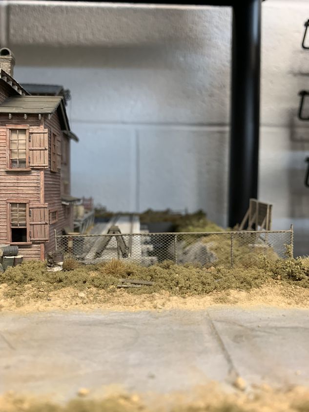

Here's the fence in place on the layout. It adds a little depth to a scene without obscuring it like a vertical board fence does.
