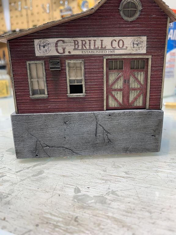

SteveCuster
Thanks everyone.

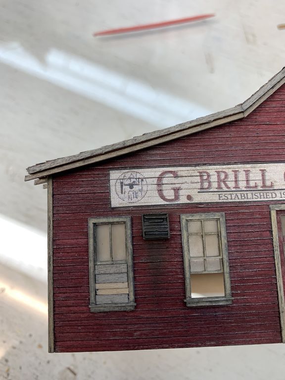

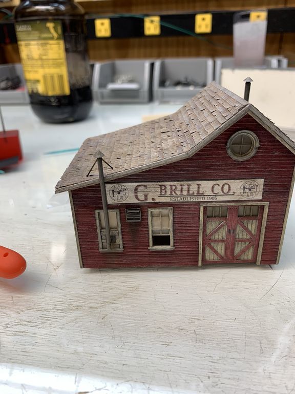

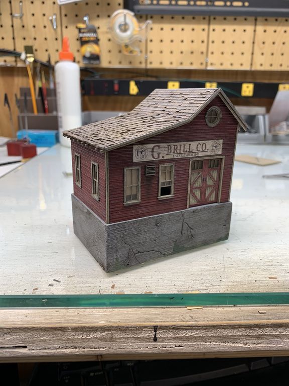

I worked on the roof yesterday and I spent some time figuring out how the base will work out on the layout.
I weathered the concrete base a bit more with some chalks. I'll be adding vines and things once I figure out how much of it will be exposed on the diorama.

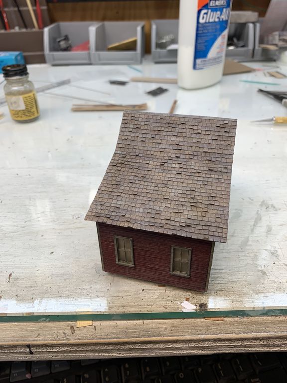

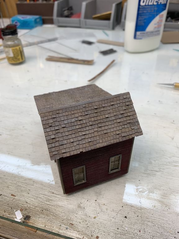

I used the left over shingles from SierraWest O'Neills Fabrication for the roof.

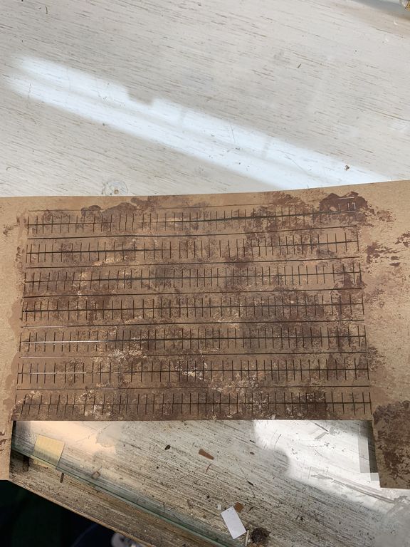

I colored the shingles first by dabbing different browns on the sheet with a paper towel. This is directly from the O'Neills instructions. I was a little unsure about it at first but once I start applying them I liked the result. After they were on the roof I dulled them with so A&I and white drybrushing.
I add the roof trim and the rafter tails.
I need to work on the dimensions of the porch next and also add the chimneys.
Thanks for checking in.
-Steve
Steve Custer

SteveCuster
Thanks everyone.

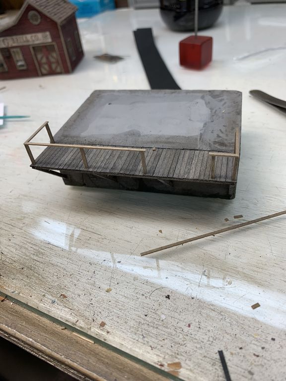

Yesterday and today I worked on the front dock and the chimneys.

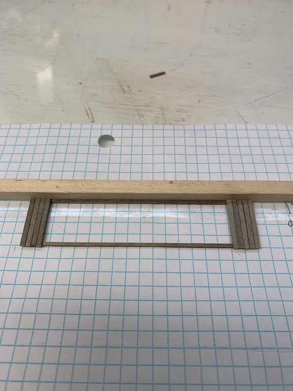

I made square out of scale 4x4s first. The dock is about the same length as the building so it was pretty easy. I used a pallet as a guide for the depth. It's about 6 scale ft. I use double sided tape to hold wood in place on templates. I used to glue everything down but this is much easier and you don't have to scrape glue off the bottom of the piece when its dry.
I wanted overhang on all sides but the part that meets the building. I use a wood piece as guide to keep everything straight and on the same plane. This is a technique I learned from Sierra West. This wood block is probably a left over from one of Brett's kits.
All boarded over. With the chopper it only took 2-3 minutes to finish.

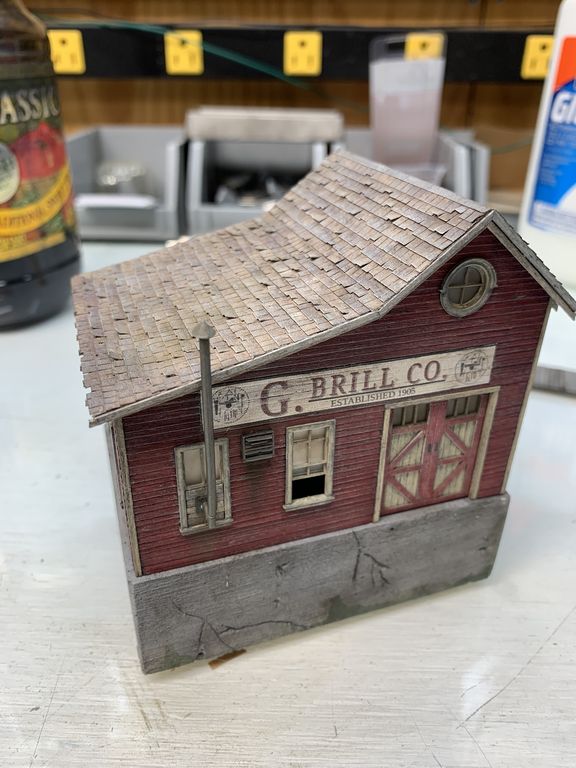

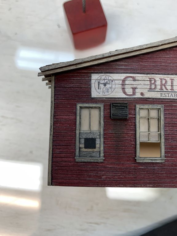

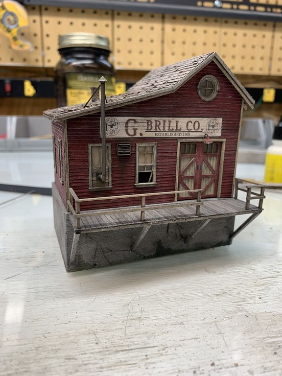

I boarded over the lower portion of this window to install a chimney pipe.
I used a piece of black paper to represent sheet metal where the pipe meets the wood.
Here is the pipe in place. This casting is from Evergreen Hill Designs. I liked it because it was very thin.
I added some support wires to the top of the chimney.

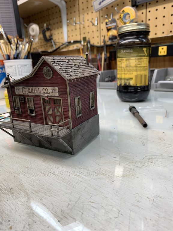

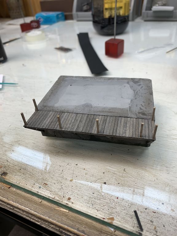

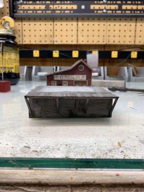

I glued the dock onto the plaster casting. I also added the 2 most outer supports.
All 4 supports are in place.

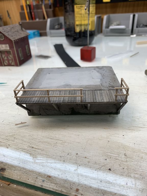

I added the posts for the railings.
Upper wood pieces were added.
Front supports added.

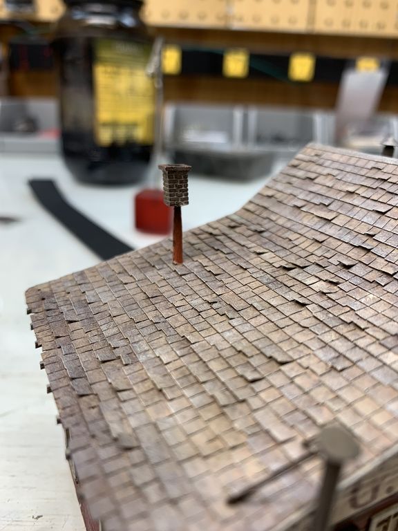

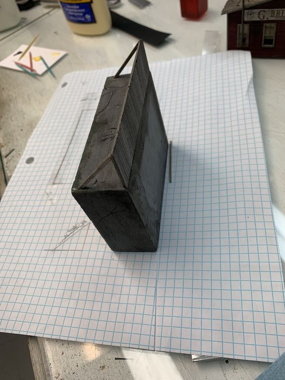

I added another small chimney to the roof. I wanted to show how I keep chimneys from sliding around while drying. In the past I had some pretty elaborate setups with alligator clips and clothes pins now I just keep a toothpick glued in the center of the casting. I drill a hole in the roof and push it in. Anytime I can drill and spike a casting for painting I do. It's much easier. Especially with drums and barrels.
I have someone around 10 of these tiny brick chimney castings but I don't know where they came from.
I added a small light about the front door. I mostly use plastic castings for these lights lately unless I plan on making them functional. This one is from Northeastern Scale Lumber I believe.
Thanks for checking in. Tomorrow I'm going to start adding some details to the dock then I'll be working out the base for the diorama. I won't add the stairs till I get the base roughed out because I won't know how high the supports need to be. I plan on having it sit on a hill like George's.
-Steve
