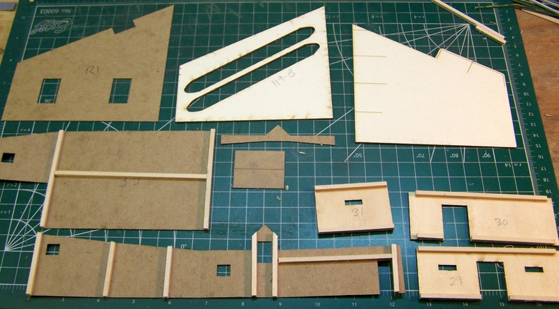

Here are all of the walls and roof sections of the livery building. Note that the carrier sheet from the bus terminal concrete island pieces is the first floor roof. Bracing is installed, but not trim.

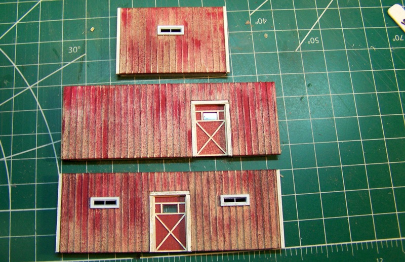

Here are the lower walls with the first few layers of finish:  Distressed with wire brushes, A & I wash followed by dry-brushed acrylic red. White trim installed and doors and windows installed.  All pretty straightforward. No surprises or "gotcha"s to warn about on these steps.

Thanks, Curt. The walls shown painted red are wood siding milled to represent board and batten siding. The other walls are cardboard. The next step will be to color 2x10 stripwood and cut it to apply board-by-board over the cardboard.

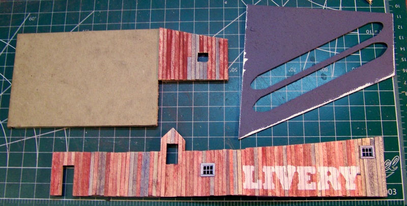

I lost a few pictures from my camera, but here are a few progress pics. Below are the upper walls, which are cardboard with individual stripwood (2x10) boards installed.  By this time I had already installed a few windows and applied the LIVERY stencil.  I think I got a bit heavy-handed with the paint on the stencil and will sand it a bit to fade it.
The larger wall above will go against the bus terminal, so only a small visible portion received boards. I am typically very frugal with my use of supplied stripwood, but at this step, I fell woefully short of 2x10s and had to dip into my stock from the LHS.
I used wood glue to attach the boards. When the walls had dried, the glue had significantly warped the thin cardboard backing walls. So I added much more bracing than indicated on the plans. By this point, I could figure out how all the walls went together and feel confident in my bracing placement.
In trial fitting of walls, I found that the bracing diagram in the kit has an error. Two adjoining walls have end bracing and one of them will need to have the bracing removed at the joint.  But that won't be a problem. I'll illustrate that later when I attached the walls.
--George

Jerry, thanks for asking. I forgot to mention coloring the individual boards. I have been eager to try Brett Gallant's technique of coloring stripwood with pastel chalks, and this seemed like an ideal opportunity.
I have a really old set of soft pastel chalks that I have been using for ages, for modelling, so I can't say what exact color I used. It was a medium red and I added in some browns and grays for variety. Basically, you shave on some powdered chalk and then wash it in with a heavy application of alcohol.  For variety, I did a few boards in a light blue and some in gray as well.
The resulting boards have a really good, aged appearance, with a chalky finish that looks like deteriorating paint. The chalky finish was why I used a heavier than average application of white paint for the LIVERY stencil, as I was afraid a light application from the stippling brush would just come off.  I don't think I needed to worry about that.

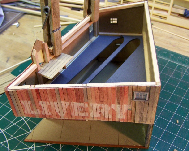

I joined the two hinged wall sections to make the upper story. Below, as they looked clamped and drying. You can see where I notched the bracing on the bottom of the rear wall so that it joined cleanly to the lower story wall.  In addition, I removed the white trim from the right end of that lower story wall so that the rear wall would join flush to the sidewalk base.
Here is a shot of the structure so far, with second story joined to the first story. This took quite a bit of fitting to get something satisfactory. It is not perfect--one upper wall does not join flush to the lower wall face, so I allowed a slight overhang as the best option. I think for a building with way more odd angles than right angles (even the roof slopes), this is my happy point. The weird angles are what gives it character.
In fitting, at the corner joint closest to the camera, which is also the sharpest angle, some boards pushed away. I will repair that once it totally dries.
The other side. You can sort of see the extra overhang, which is on the front wall second story just to the right of the door--it goes from flush at the near corner to about 1/32 overhang by the time it gets to the loft overhang.
--George
