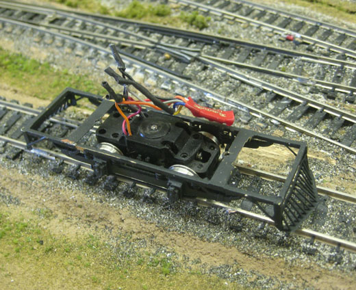

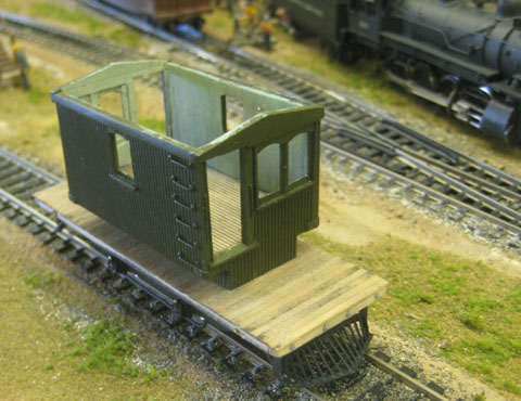

I finally got some bench time and got the power truck built and assembled.

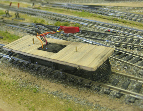

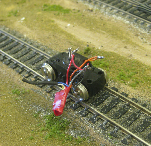

This is the most compact drive unit I have ever built.  It is a NWSL Stanton drive and a Digitrax 126 decoder.  It doesn't pick up current any better than what you would expect for a four wheel truck but it does move.  The photos include the assembly into the frame and the added deck.  More later.

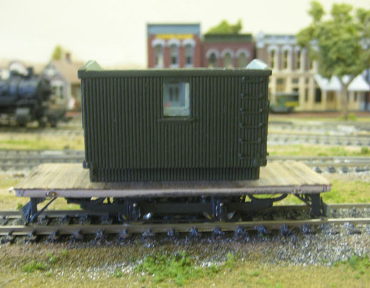

I got the superstructure on tonight.  The decoder is under the floor.  As there were no lights on this work motor it was pretty easy.
So now I clean up paint....  add windows and detail stuff.

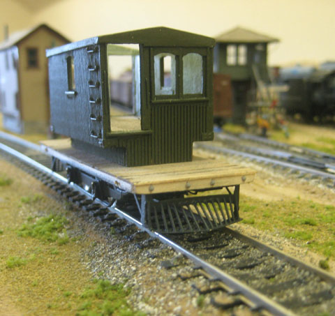

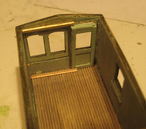

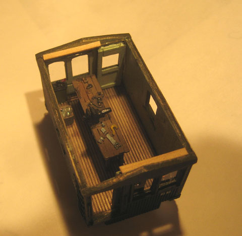

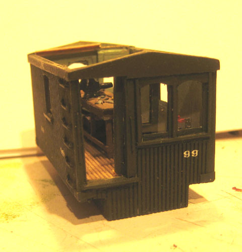

So here are some of the interior shots.  There is a ton of fine painting stuff yet to go.  The glass is in and the doors operate.  The work bench is a bunch of different castings and the vise is carved out of a chunk of white metal with an x-acto blade.
I couldn't resist making up a crate of glass insulators.
