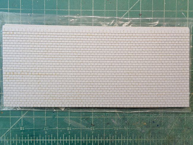

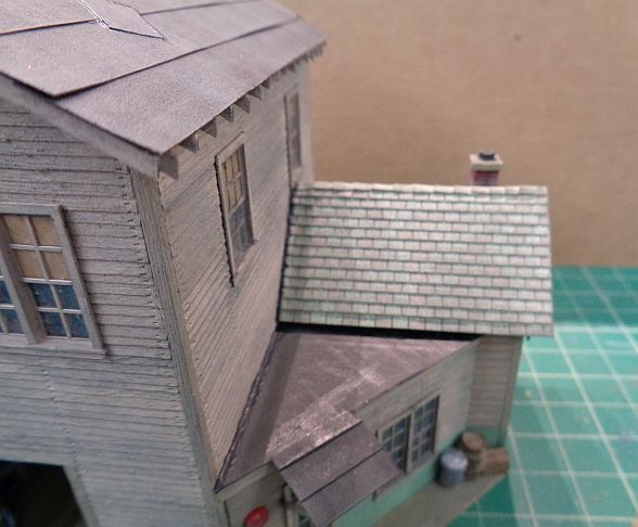

For the office roof shingles I chose to use Northeastern Lumber shingles. Once glued in place, I used Prismacolor markers of green and gray for an individual shingle look. I got the Prismacolor markers from Sam Flax Art Supply.
I cut some individual shingles for the ridge caps.
Continued -

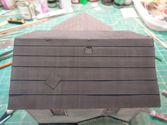

I then weathered the other two roofs. I used four different colors of PanPastel grays.
Continued -

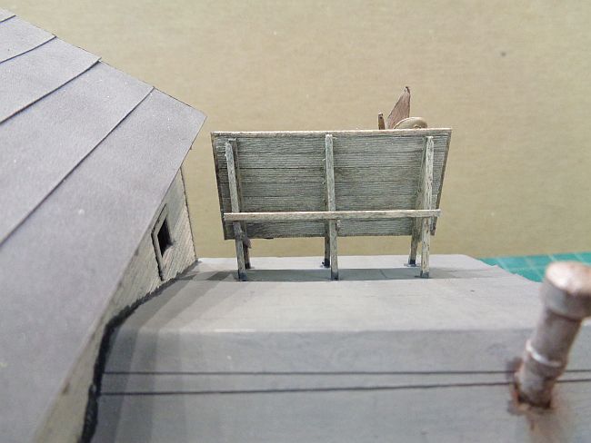

Once all the roofs were weathered, I added the pest control sign.
Here is how the sign looks from the rear.
