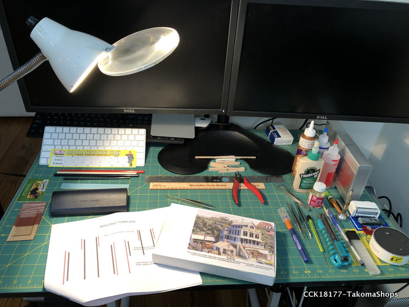

Here you see my rushed collection of tools to get me started.

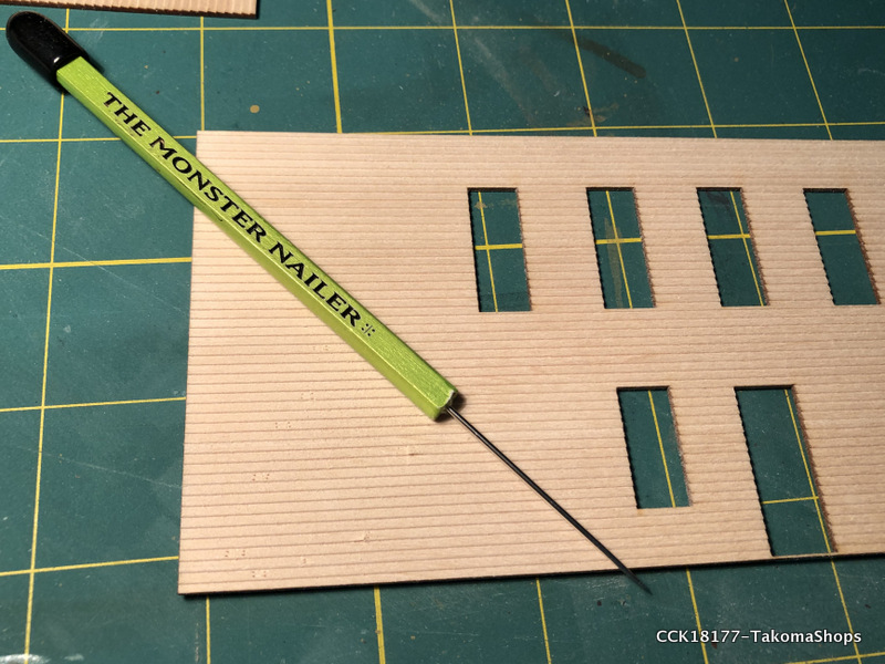

I was very pleased I found my trusty orange and purple hobby knife and my favorite pair of tweezers. It is also nice I found The Monster Nailer. I like using it to place nail holes strategically about.
The instructions first direct the modeler to sort out the paints to be used throughout the build. I have not done that yet. Next, the instructions direct the modeler to distress the laser cut wood walls prior to bracing, staining and painting. Therefore, I will do just that.

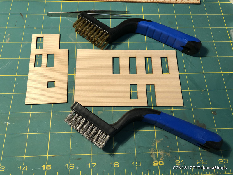

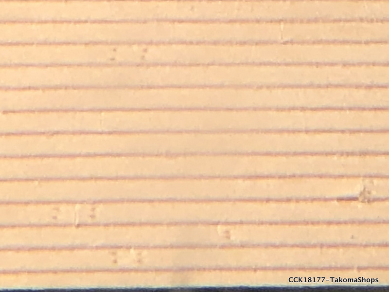

I found a pair of wire brushes I will use to put some grain on the wood walls.
I recently watched a YouTube video by Jason Jenses on how to weather wood walls. It is a very good tutorial. This is the link to it:
https://www.youtube.com/watch?v=RHNVmKVGs68

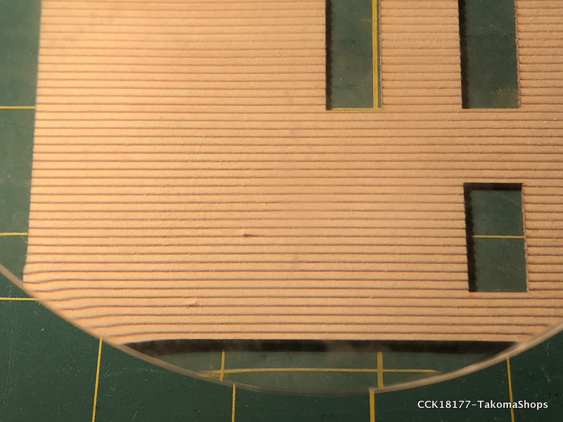

Here is a progress of how I put grain (I scrubbed the walls with the wire brush), add nail holes (with The Monster Nailer), mark separate clapboards (with a dull hobby knife lol) and lift some clapboards on the walls (with the same dull knife).
That's The Monster Nailer if you are not familiar with it. I believe it is no longer in production.

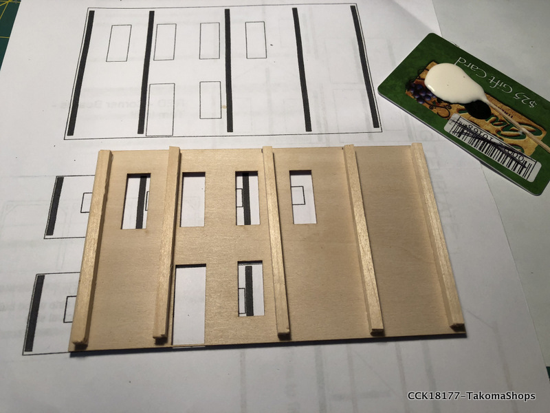

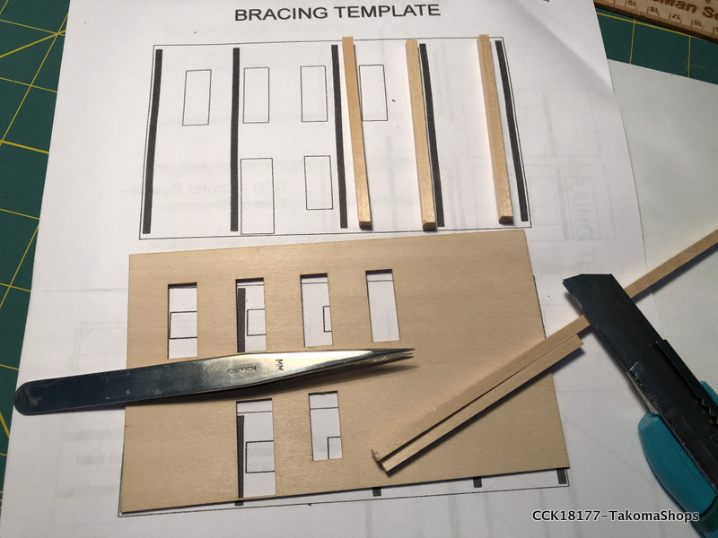

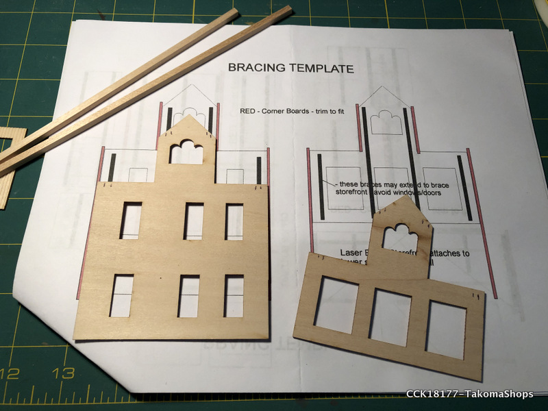

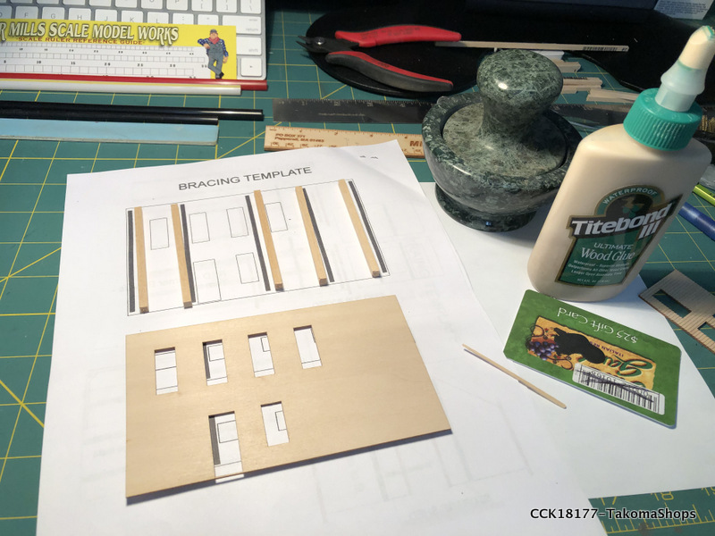

I've managed to brace all but a few of the walls in the kit. The instructions provide full size bracing templates so it makes it real easy to get that done.

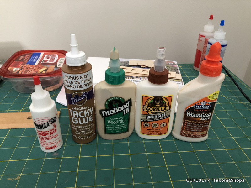

I like using Titekbond III wood glue for all my builds that include wood pieces. It is a tad spendy but it is worth it.
I pool a bit of the glue on a plastic card and use toothpicks to apply the glue to the required parts.

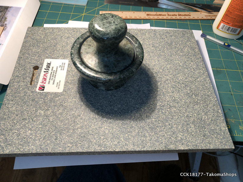

I use whatever I have handy to weigh down the glued parts as the glue dries.
If you have clamps handy they are also a good choice.

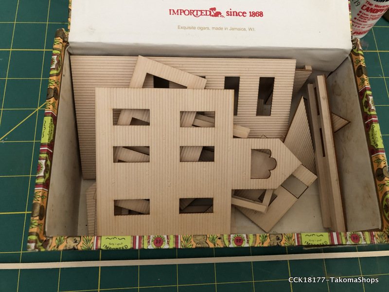

When I finish gluing the parts I set them aside in a separate container to kept track of them and not damage them either.
I mentioned earlier I needed to round up all my tools and supplies as they were packed up in boxes. This is what happens when you don't keep track of what you have and where you have it.
I have more glue dispensers than I need. I actually had to go buy some glue at Wall-Mart and could only find the Gorilla Glue. That is the only wood glue my Wal-Mart stocked. I had to buy new glue as the Titebond III came out too runny out of the bottle. I suspect it separated from being stored too long. Oh well....

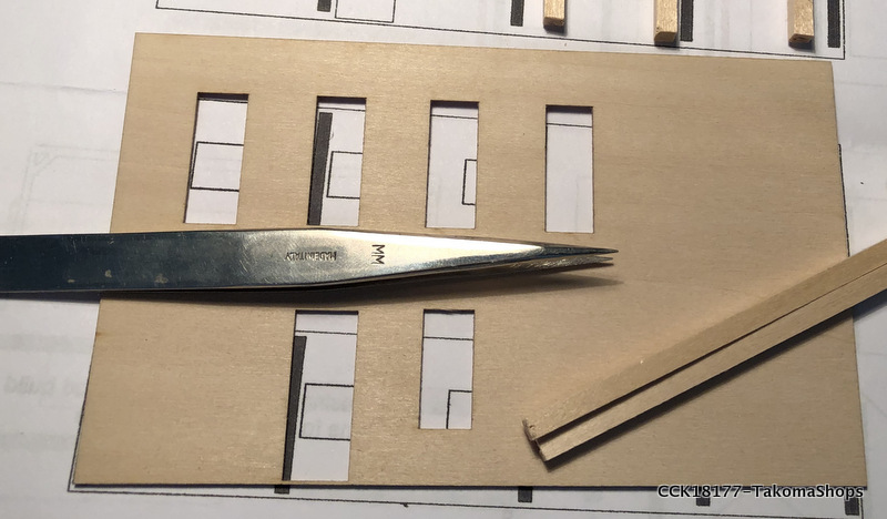

At least I did find my all-time favorite tweezers. I have no clue when or where I bought them. But I have had them for a very very long time. They are made in Italy and have "MM" marked on them. Anyone know anything about these?

Looks like you are off to a good start.  It seems like it is becoming more difficult to simply find good old Elmer's white glue.  Did you happen to see Art Fahie's video rant on glue?

I have a similar pair of tweezers Jaime. They're my favorite ones to use also.
Jaime
Great to see you back at the workbench! I will be watching your build - you are off to a great start. It looks like you found all the necessary tools. I sure miss Monster ModelWorks - that nail tool is great.
I will check when I get back to my workbench if my favorite tweezers have the same markings. I think I remember where I bought them. ;)
MAP
Nice progress Jaime! Thanks for all the pics. I have the same problem with glue as I do with clamps...way too many choices, with my Titebond separating as well.  I believe the MM is a "style" of tweezer.
Available in a wide variety of shapes and sizes. Each style (or pattern) is designated with a number and/or letter, such as AA, MM, 3C, or 7A. They can have tapered or indented shanks with round or beveled tips and range in size from medium to extra fine tips.

I had a separation issue with a old bottle of Aleene's glue. managed to shake and mix it enough to get it back to original consistency.
