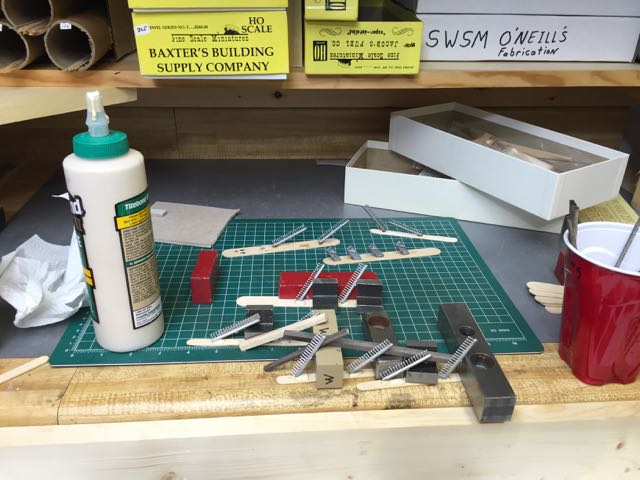

And now and update on my Jacob's build.  This first picture is my workbench where I'm preparing the metal castings for painting. I mount my casting to wood sticks to help with handling them. The picture shows the process. I'm using the same wood glue that I use to build the wood portion of the kits. It's Titebond III ( note to photographer turn the bottle so the label shows next time).
The glue holds the castings in place through the whole painting process - I have tried double stick tape of a number of different brands and I never seem to keep the casting on the stick long enough to get them through the painting process.
There is a trick to removing the castings once your ready to mount them to your build.  Glue is very weak in shear so you need to twist them off the stick. If you try to pull them off you can damage the castings.

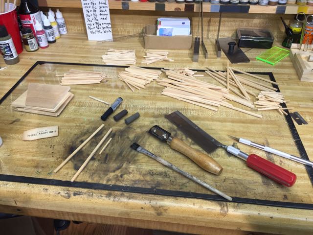

On my other workbench I'm preparing the wood parts for the build by distressing them (adding grain) with a razor saw.  I use three different types depending on the size of the piece of wood.  They all have saw teeth in the blades.
I'm staining the wood with chalks - for this build I'm using three different colors - a black, a dark brown, and a medium gray.  This is the colors I chose for a coaling facility. I scrape the chalk from the stick with a razor blade and then add 90% alcohol. I'm brushing the mixture on to the wood with a 1/4 inch paint brush.
During the process the wood gets slivers that need to be removed. I like to remove them after the staining process because the alcohol tends to make them stick out more and even adds some slivers durning the drying process.

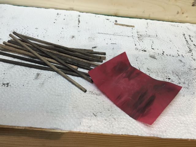

Finally, I remove the slivers with 600 or 800 grit sand paper. This process not only removes the slivers but also gives the wood a more weathered look. Part of that is texture and part a lightening of the color.

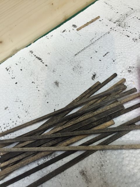

A comment on this technique:  Up until a few years ago I would have used alcohol & Ink to weather the wood for this build.  I have started using the chalk process after attending one of Brent Gallent's SWSM clinics. I will still us A&I for some builds, but I really like the difference in color from board to board using this technique. With A&I you get a difference board to board by the difference in the way the wood absorbs the stain - which you get here. But you also get differences because you are using different colors of chalk which you are randomly blending together. Another plus with the chalks is the texture. To me it looks more natural.
Here is a photograph of a few of the more than 1200 sticks required for this double build ready to be glued in place.
Note the difference in color and texture.

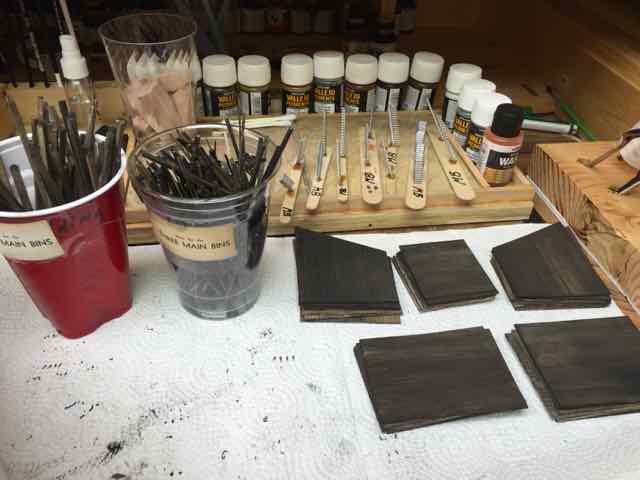

The workbench is filling up with stained wood and castings to paint.  This first picture is the wood and castings for the main bins.
I put the wood that is ready for assembly in labeled cups which helps save time looking for the piece I want during the assembly process.
