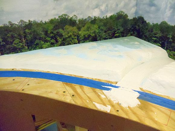

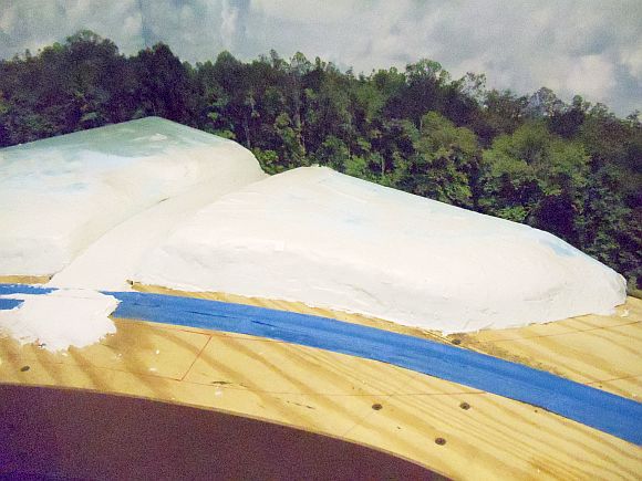

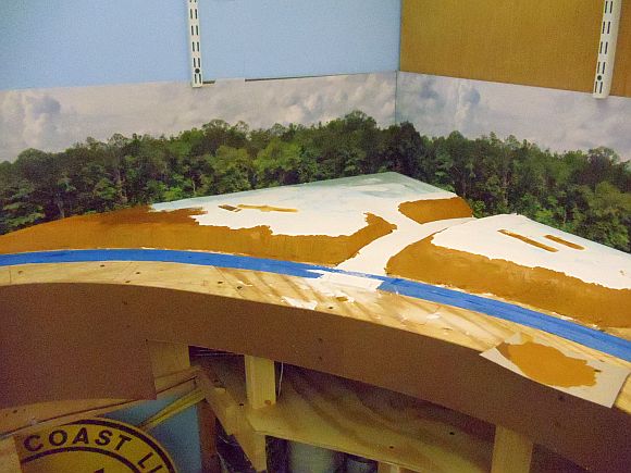

The sand hill is now covered in "Cracking resistant" spackle.
Also, I should be able to sand and paint in five hours time after application. I won't as I don't plan or staying and watching it resist cracking.

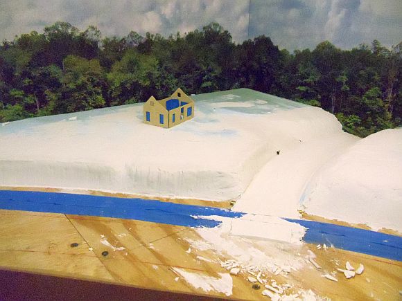

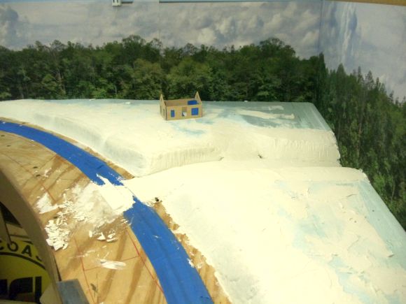

Well, I said I would report on the "resistant cracking" spackle. It did crack but was no big issue. I just filled it by finger painting some spackle in the cracks.

Thanks for dropping by and posting a comment. I've used Drywall mud in the past and wanted to try the spackle. I've actually used the mudder sponge trick when I installed drywall in the man cave/layout room.
Comparing the two, I'd have to give a nod to the drywall mud. However, either one will work at it will all be covered.

I choose to use Northeastern Scale Lumber for the construction of the two cracker houses. The 1/16" clapboard is what I'm using for the walls.

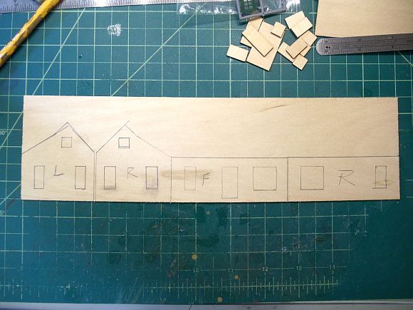

I drew a house pattern on the back side of the clapboard.

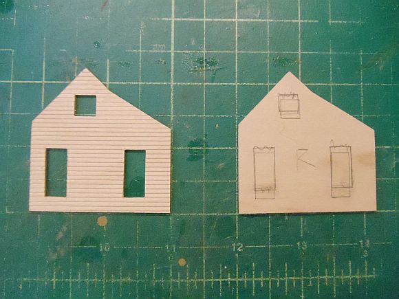

I'm building two different styles for the houses. This one has an offset roof with and attic window centered below the roof peek.

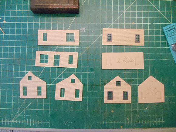

Fast forward and the two houses have been cut out of the clapboard. I still need to cut in a few windows and a door.
Both houses will be set on blocks and off the ground.

I wanted to try something different in adding scenery. If it works we all benefit and if it doesn't then ya'll benefit (learning not to follow me) while I rip it all out. :'( :'( :'(

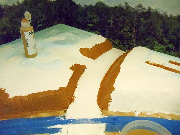

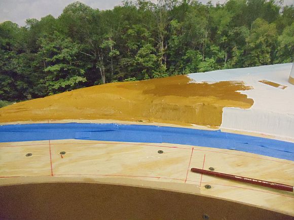

I started by painting the spackle with Golden's Yellow and Burnt Umber Light Acrylics. I combined the two colors with 80% Yellow Ochre to 20% Burnt Umber Light.

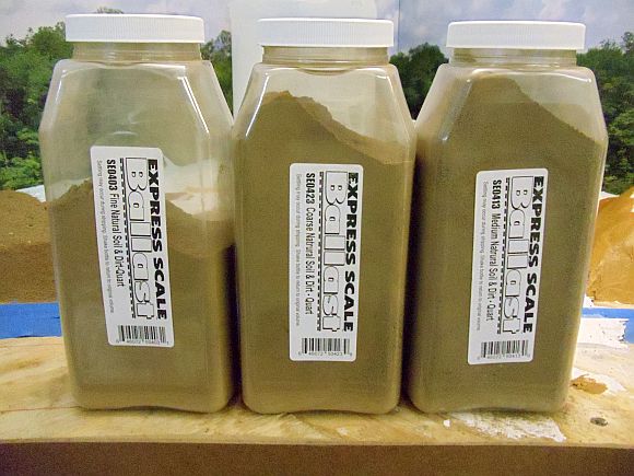

I'll be using a combination of Scenic Express Fine, Medium and Course dirt.

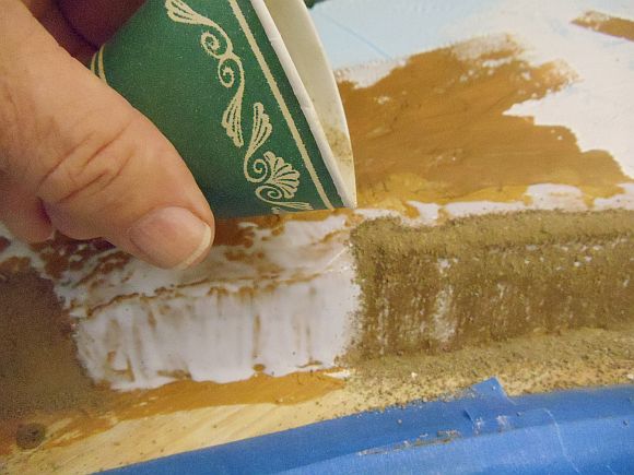

I painted while glue on the spackle and then used a Dixie cup to apply the dirt. For the slope I used the fine dirt.
