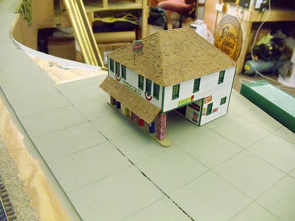

The white two story structure is a kit Jimmy D. sells. The structure is Bigger Baker's Country Store.
http://railroadkits.com/store/index.php?main_page=product_info&cPath=1&products_id=23&zenid=153fef20a7217f98435a7bf6ded80b38
I built this kit and did a thread for Jimmy on the old forum.
http://www.kitforums.com/viewtopic.php?f=6&t=4682

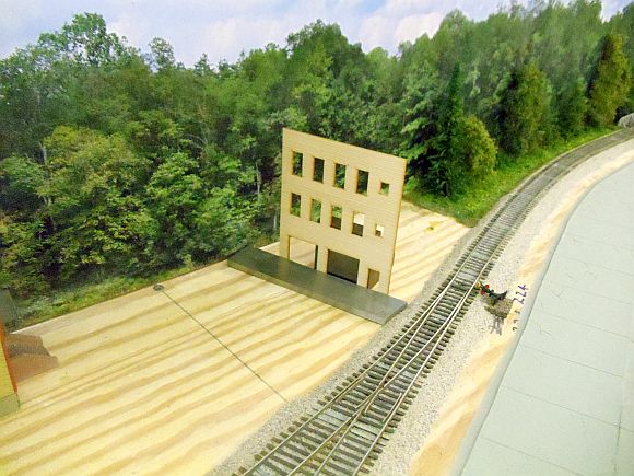

I plan to kitbash FOS Varick Frieght Co. for the new area I'm working on.
I won't be using it as a flat though. I'll be adding a larger side wall with a great looking sign. Stay tuned for that.
I plan on a separate build thread for Varick Frieght.

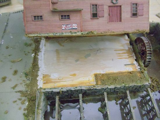

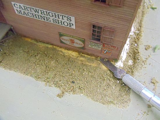

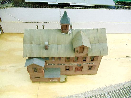

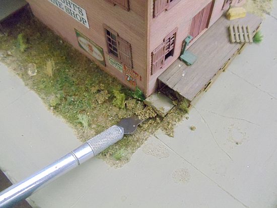

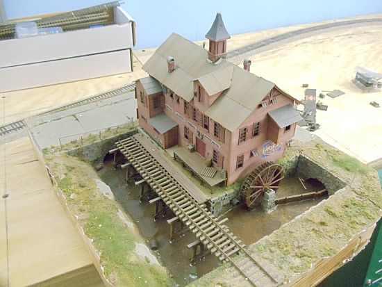

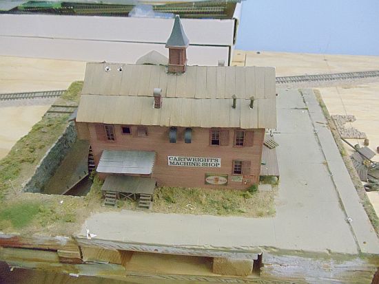

One of the things I did a couple of weeks ago was to deconstruct my FSM Cartwrights Machine Shop diorama. When I built it I had grand plans and built every kit to George's instructions. Well, this is a northern structure and I want to use it in the south.
I don't need the water wheel or trestle. Plus the structure needs repair and the diorama base is big, bulky and too heavy. I just want the building and the details.

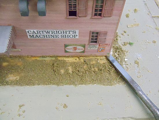

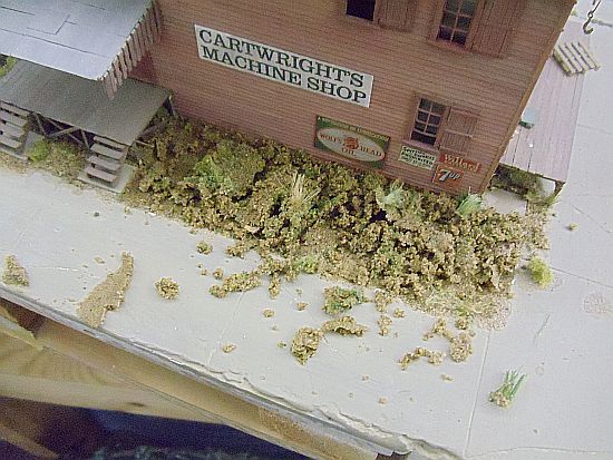

I started by dripping small amounts of water on the scenery and letting the water leach up to the structure.
I let it sit a few minutes while the water softened the glue and scenery. I used a #17 Xacto blade to "dig" up the scenery.
I worked my way around the structure until I was back to the starting point.
I then removed all the loose scenery material. I used the Xacto #17 blade to gently "cut" the glue under the walls.

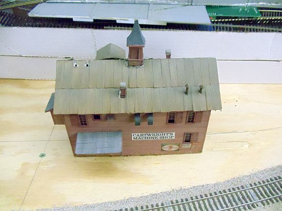

I then used a small sharp chisel to carefully and gently lift Cartwrights.
The building was removed from the diorama base.

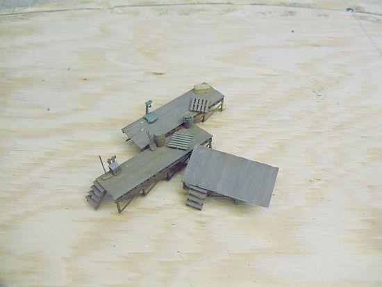

The loading docks were saved with just a little bit of damage that can be repaired.

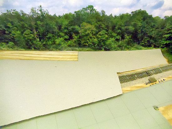

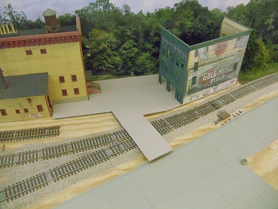

I needed to make a paved area for Varick Freight and have it be shared with the office staff of Sinners Mill.
I started with an old piece of cardboard. The cardboard came from Sam Flax Art Supply and is 24" X 24".
The cardboard was test fitted on the location of the two structures.
After some additional test fitting I came up with a piece I was satisfied with.
