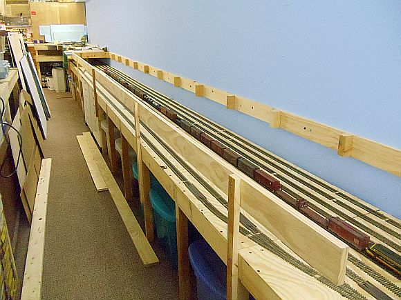

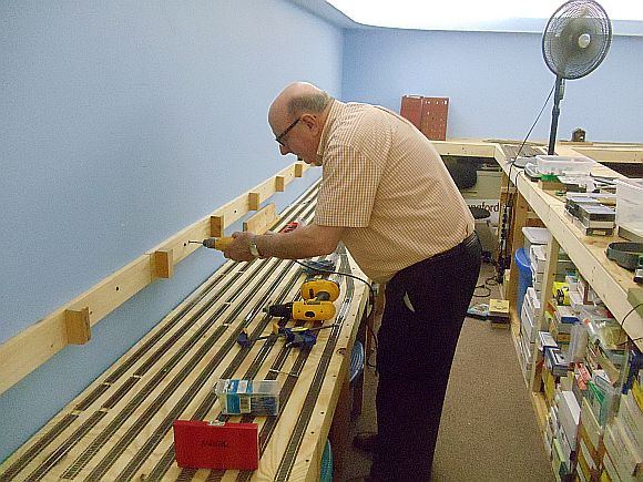

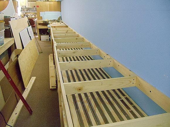

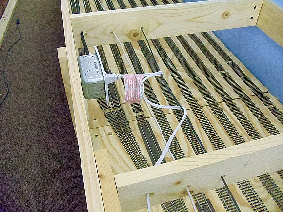

I finaly got back to finishing the bench work for the east side second level. I put the Judge to work on drilling a new hole for the tapcon screws. The one to the left of where he is drilling is stripped. The second one held.

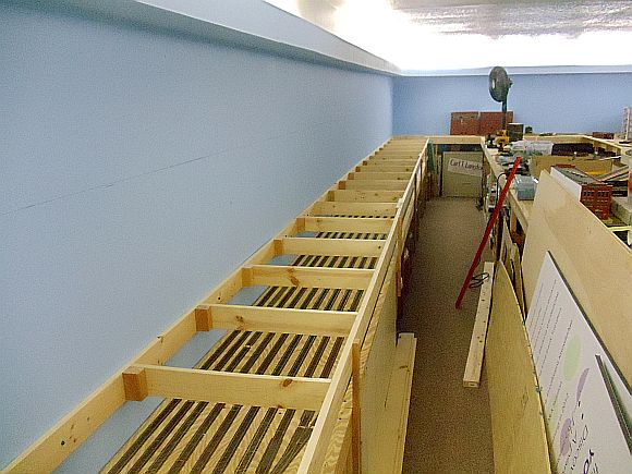

We got 30ft. of the wall 1x4's up and started on the inside or front 1x4's.
This afternoon I finished the rest of the bench work bracing.
Over the next few days I'll add the cross bracing supports for the second level.
In this photo I just placed the plywood on the framing. The plywood support bracing isn't complete.

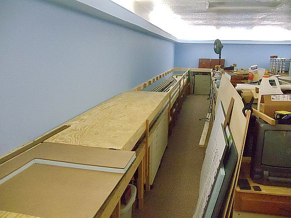

I guess I've been a bit lazy in posting any updates. I'll show some of the east side and then move back to some additions to the west side.

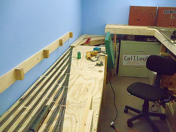

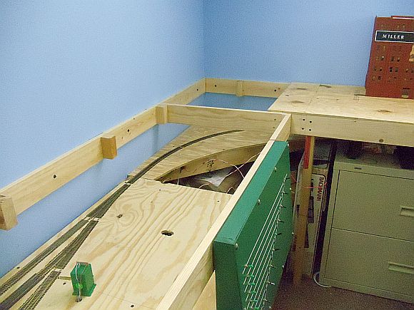

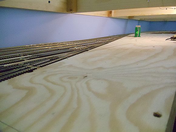

The east side second level bench work is finished and I now just need to add the plywood and then move on to the track.

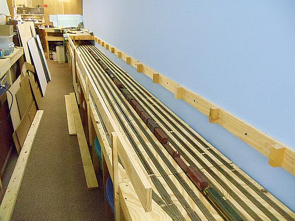

I added the buss lines and ran an electrical line for the lower/staging level lights.

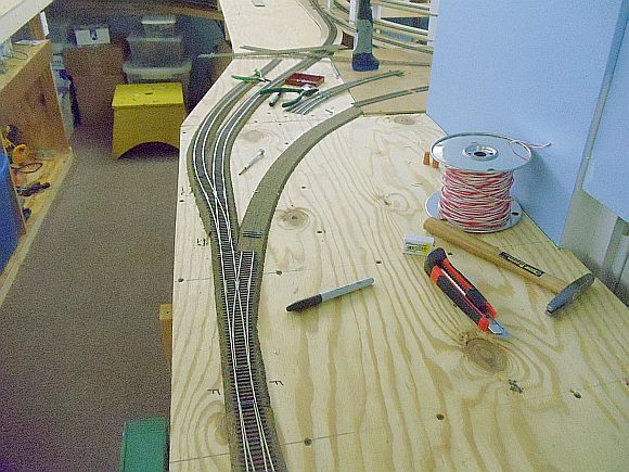

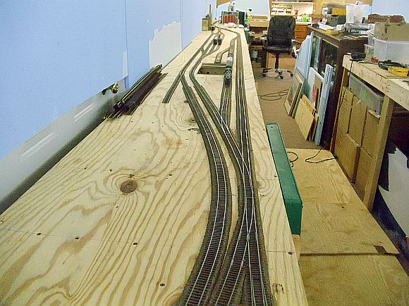

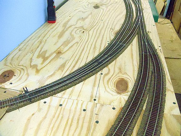

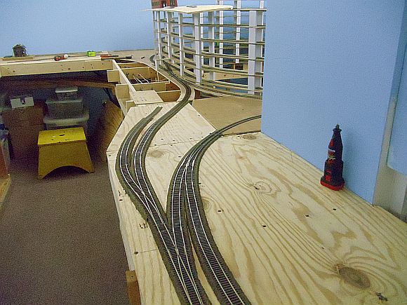

I added a few tracks and crossovers to the west small yard area. I now have north and south inbound tracks to drop off and pick up cars. I also have added a few turnouts to give me more switching opportunities on this side.
I realized if a train is at the station, then the train coming off the ovalix has no where to go.  This issue was fixed. I removed a portion of the track where it comes off the north end of the ovalix.
I then installed a #8 left hand curved turnout.
Now a train exiting the ovalix northbound can continue north without having to wait on the mainline clearing.

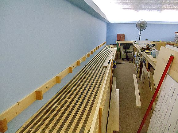

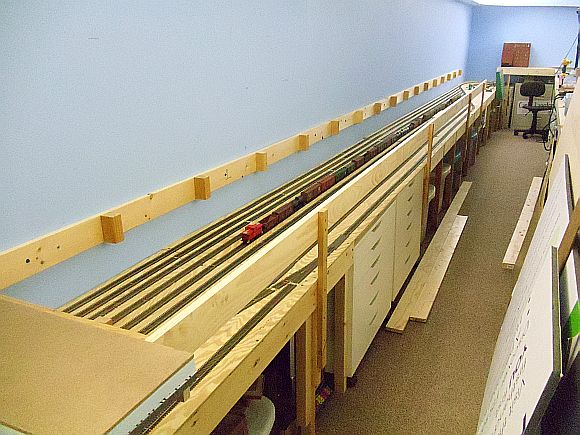

The next photo shows the exit track from the ovalix to a northbound track. You can see the curved turnout in the right of the photo.
You can see the new track left of the yard lead. This track can also be used to bypass the mainline or be used as the north inbound yard track.
