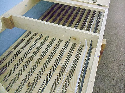

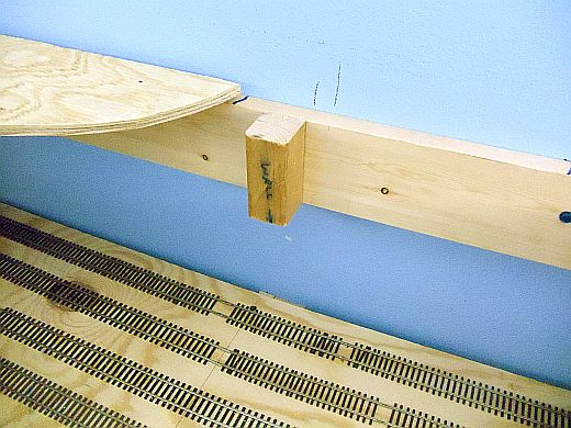

I removed that entire 8 ft. section of plywood and took it outside to make the cuts. I placed the two pieces of plywood back on the bracing and marked where the river would go. Unfortunately, it fell across a support brace.
You can see in the photo above my buss wires and light cord also pass through this brace. Here again is the principle of  the 5 P's. Anyway, not to be slowed down on this public works project, I moved on.
After making the mark I cut the brace.

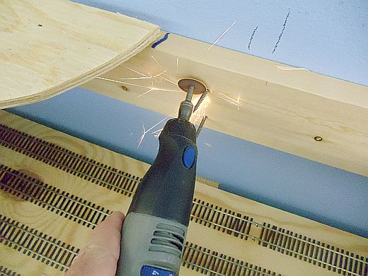

This piece of 2x2 is screwed to the 1x4 from the rear. I used a hammer to knock if off.
I then used the Dremel with a cutting disk and removed the two screws. And here is a little early July 4th show for ya'll.

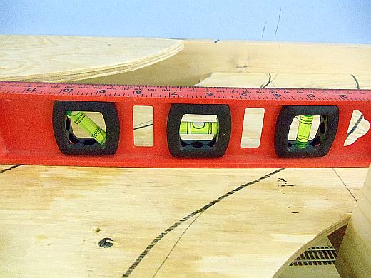

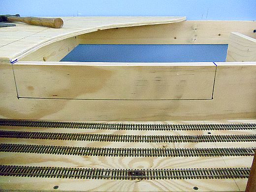

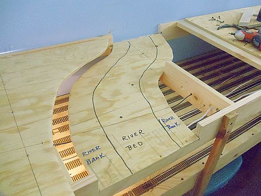

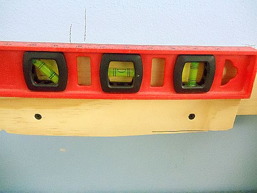

I decided to lower the river 2 inches from the top. I screwed a small block of wood to the back wall 1x4 and made sure it was level. This block will support the river bed section of plywood.
I measured a section on the front and the wall 1x4 and made the cut.
I made a similar cut on the rear wall 1x4.
I reattached the wall brace and fit the river base in place. I found it two flimsy so I added a short piece of 2x2 to the bottom side.
I replaced the river base.
And it is level.

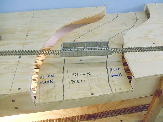

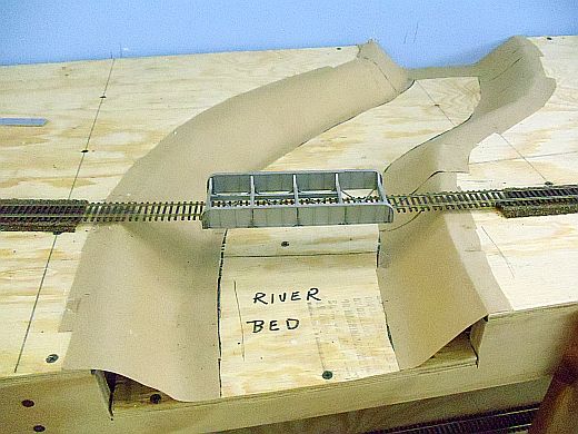

Here we see the plastic bridge over the plywood river.

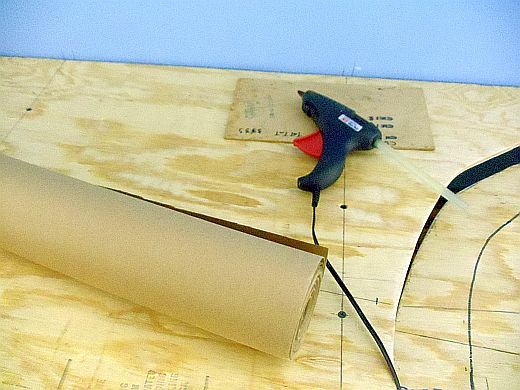

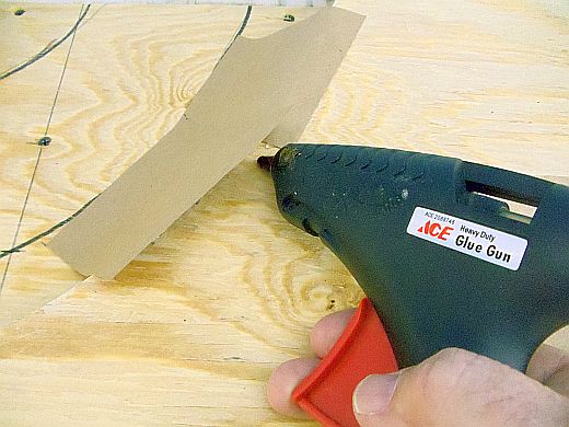

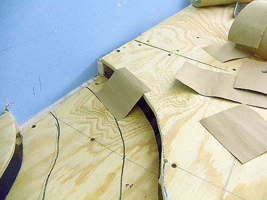

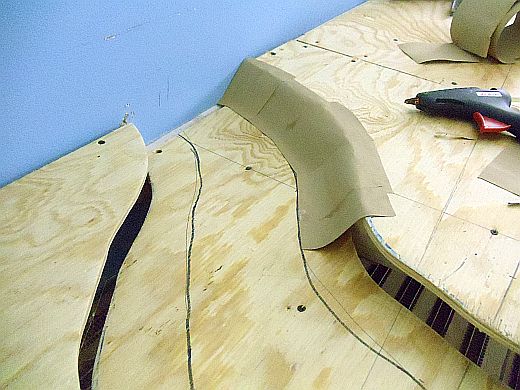

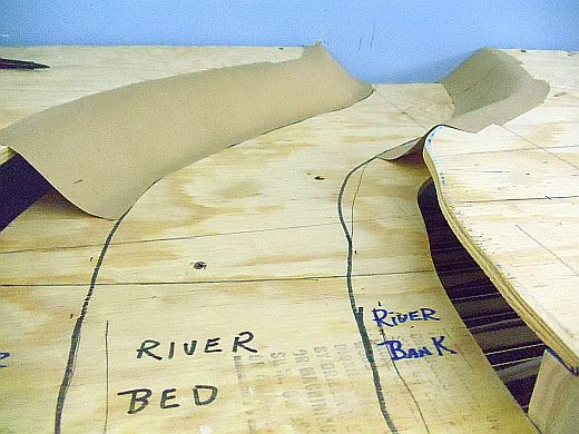

Time to add the river bank. I took some contractor's paper and the trusty hot glue gun.

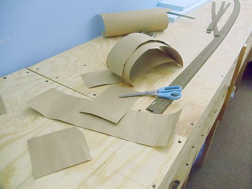

I cut the paper in small pieces.
I glued the paper to the sides using my river bank line as the source for the bottom edge of the river bank.
In the next few photos you can see the progress.
And now the bridge over plywood.
I made the river bank shallow so I can make any contours to the bank when the scenery material is added at a later time.
